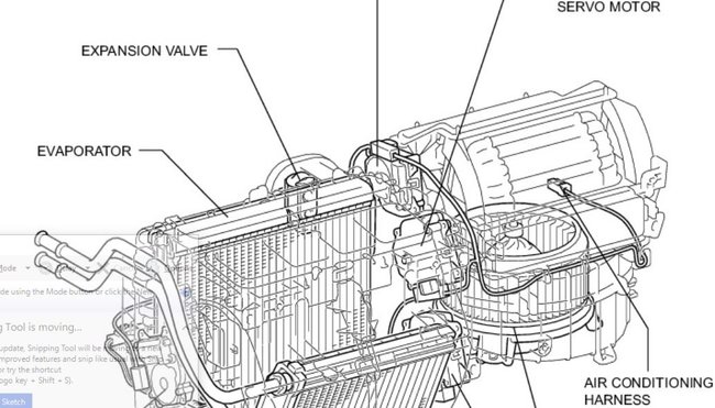

Static pressure, high and low 80 degrees . Outside air temperature 79 degrees. Car running, high 115 low 65 degrees. At 2,000 RPM's high 125 low 70. After car shut off for 18 minutes high 125 low 90. Dose this indicate a bad TXV or compressor control valve?
Oct 28, 2019 at 2:22 PM
Good afternoon,
I do not understand your numbers.
First static pressures should be equal with the engine off and almost the same pressure as the outside temperature.
Running, the high side should be 2 times ambient air plus 15%.
The low side should be 25-30 solid no matter the temperature.
Can you recheck those values?

Can the problem be in the expansion vale or in the compressor control valve?
Oct 29, 2019 at 2:41 PM
As I stated, yes, the expansion valve and the dryer need to be changed.
There is no compressor control valve.

HI Roy, I get that the expansion valve if failed open will cause the high pressure side to be low and the low pressure side to be high, because there is not a big enough restriction in the expansion valve to separate the two sides. What I do not understand is when the car was turned off the pressures do not equalize. I watched them for eighteen minuets without dropping. Would not a open expansion valve cause the system to equalize quickly. Can the expansion valve be causing both conditions.
Oct 30, 2019 at 10:17 AM
Yes, the expansion valve is causing both issues. If the pressures do not equalize, the valve is closed.

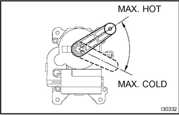

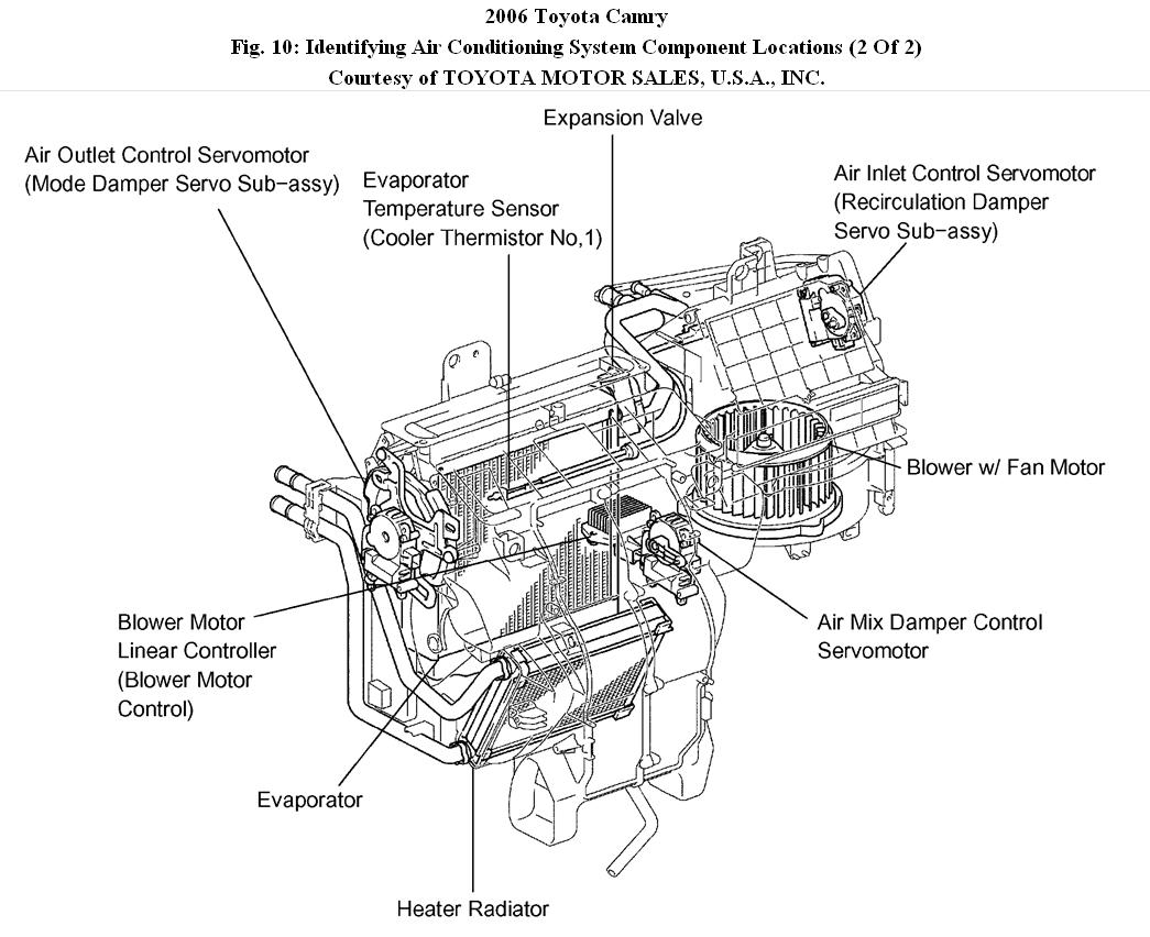

My Toyota Camry is having problems with the left bank vents blowing warm air, while the right bank vents are all blowing cold air
Nov 27, 2020 at 8:27 AM (Merged)
KHLOW2008
  • 41,814 POSTS
Such problems are caused by the air mix servomotor or its linkages. Try switching between heater and A/C a few times and note fif the servomotor is running correctly.
GIOGTVTS
  • 5 POSTS

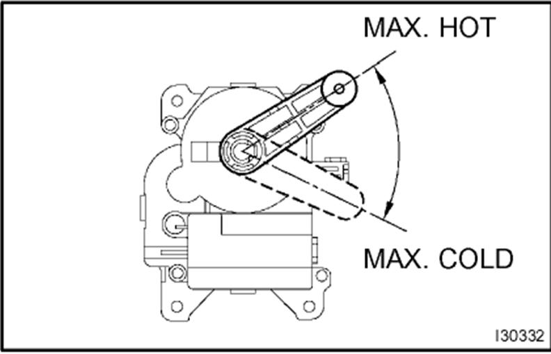

Thank you for your reply KH Low. I have tried the fix you suggested, but it does not work. My air cond is a manual one (not auto/ temperature control type). Does this type of air cond have Air Mix Servomotor?
KHLOW2008
  • 41,814 POSTS

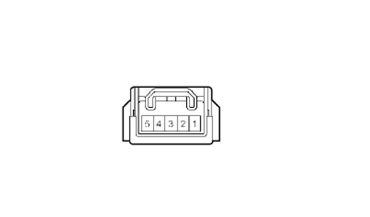

Yes, even the manual system has the servomotor.
Inspect servomotor operation.
1. Connect the positive (+) lead from the battery to terminal 4 and negative (-) lead to terminal 5, then check that the arm turns to "COLD" side smoothly.
2. Connect the positive (+) lead from the battery to terminal 5 and negative (-) lead to terminal 4, then check that the arm turns to "HOT" side smoothly. If operations are not as specified, replace the air mix servomotor.
