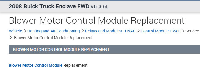

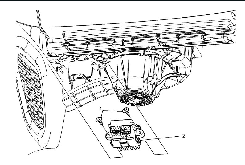

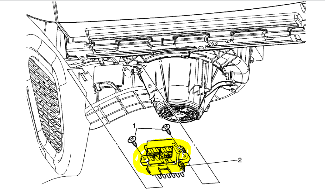

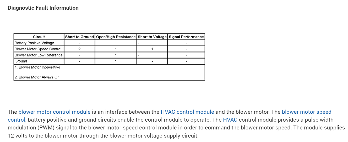

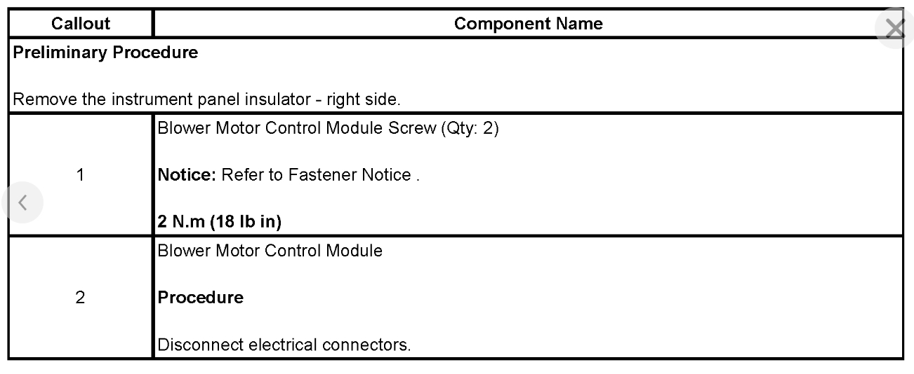

The fan would not turn off, even with the car off, so we took out the fuse. AutoZone sold us a relay, saying that 98% of the time that is the problem. Apparently, he didn't know what he was talking about. Your answer explains why we couldn't where to install this. We are novices at this, hoping to save a trip to the mechanic. Do you have installation instructions so we can see if this is something we can do? Thanks.
