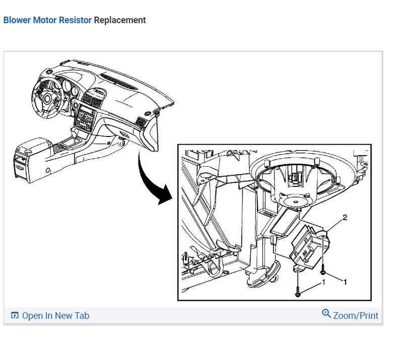

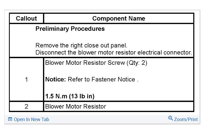

Yep, this happens when the blower motor speed resistor is starting to burn out here is the location so you can remove it and look for signs of burning. Check out the diagrams (below). Please let us know what you find.
