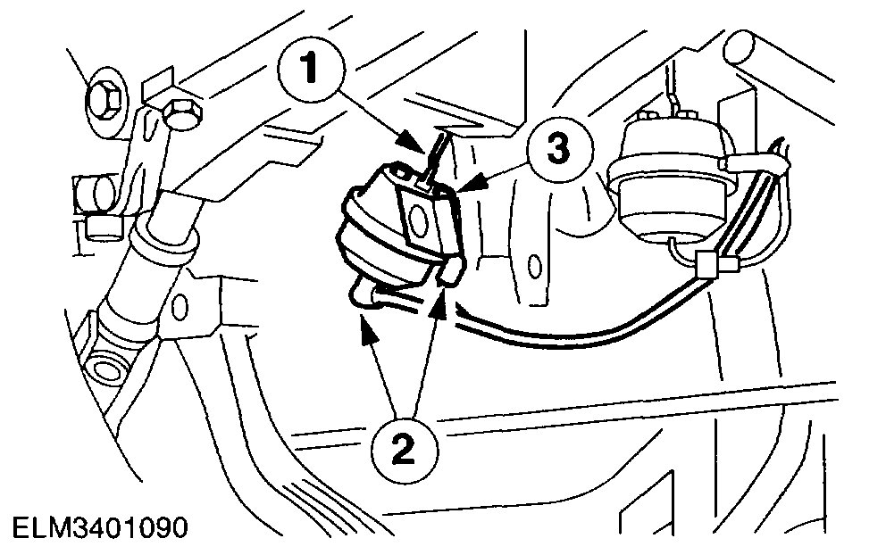

pic 1

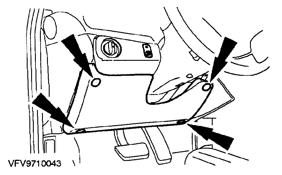

1. Remove the instrument panel lower panel.
pic 2
2. Remove the actuator.
1 Disconnect the actuating rod.
2 Disconnect the vacuum lines.
3 Remove the nuts.

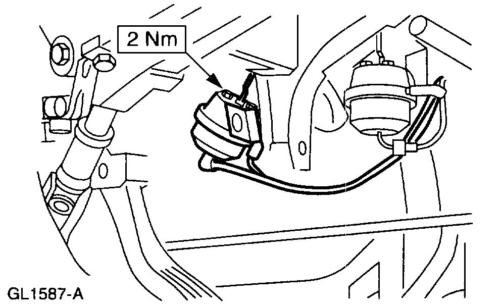

pic 3
1. To install, reverse the removal procedure.
