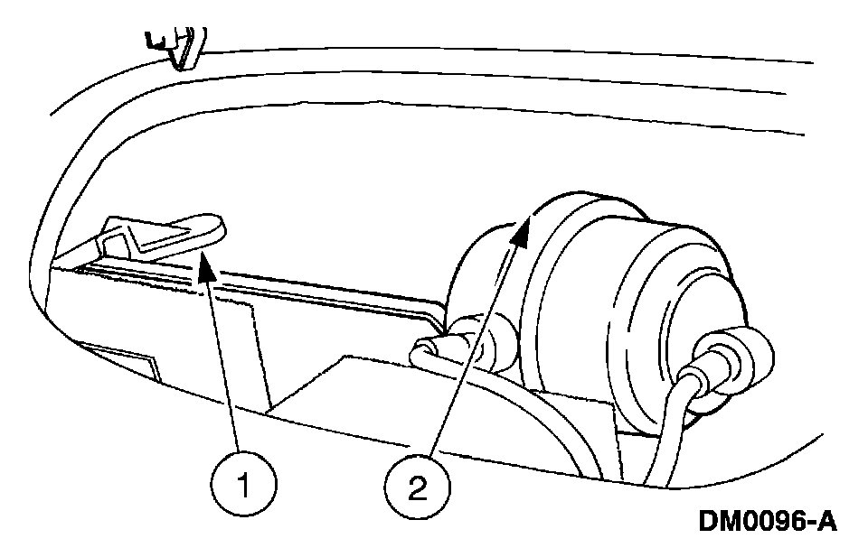

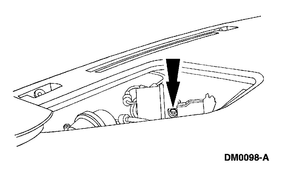

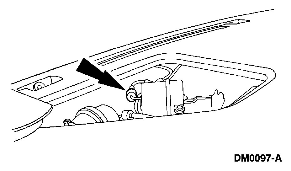

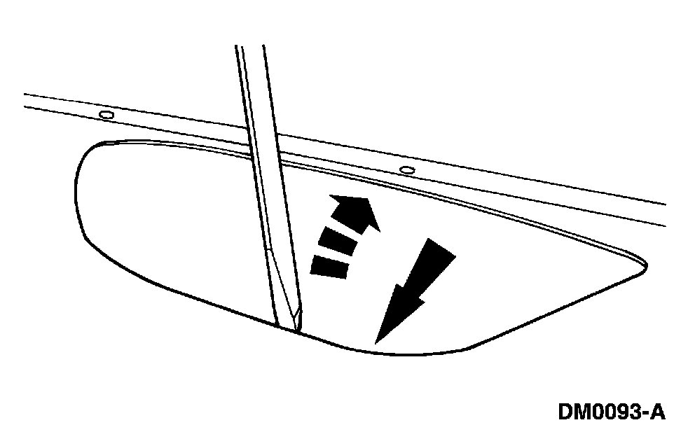

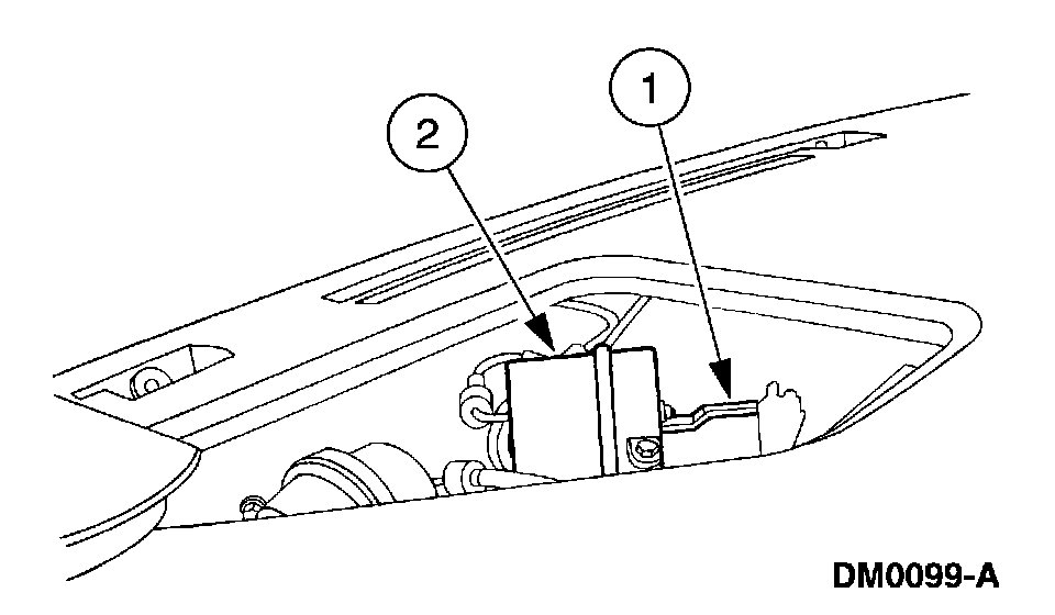

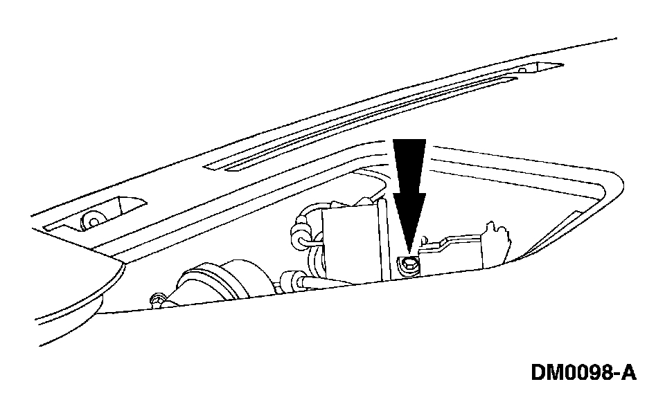

I am going to attach the actuator information for all modes. I hope it helps. Please remember, these actuators are run from engine vacuum. If there is a leak, dry rotted hose, disconnected hose they will not work. I feel your primary focus should be on the panel door vacuum motor. The idea that it is going to defrost only indicates to me that it is in a default mode.
VACUUM CONTROL MOTOR - PANEL DOOR (pictures 1-4)
REMOVAL
1. Remove the access panel.
- Use a screwdriver to pry the access panel out.
2. Remove the vacuum line.
3. Remove the two screws.
4. Remove the vacuum control motor.
1 Lift up on the vacuum control motor arm to disengage it from the door crank.
2 Remove the vacuum control motor.
INSTALLATION
1. To install, reverse the removal procedure.

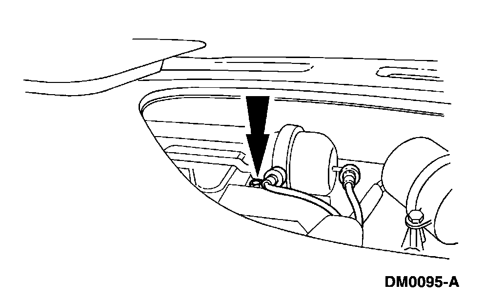

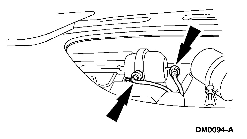

VACUUM CONTROL MOTOR - FLOOR/DEFROST DOOR (pictures 5-8)
REMOVAL
2. Remove the vacuum lines.
INSTALLATION
