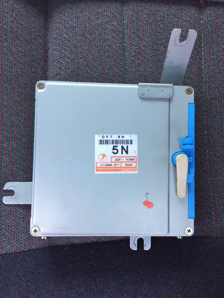

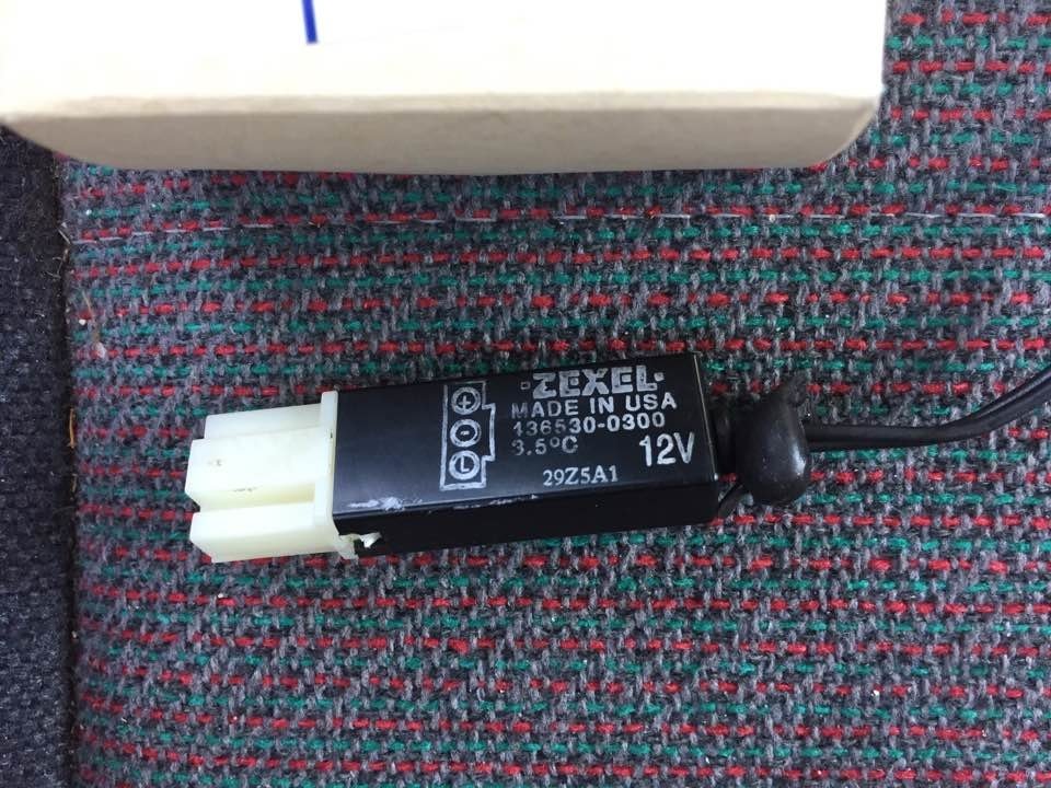

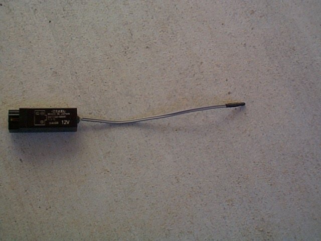

Three mechanics have looked at it recently. The compressor works. No Freon leaks. They think it is electrical. Replaced the computer. Still does not work. New mechanic is painstakingly tracking backward to see where the problem is. He thinks it may need a thermo switch (see attached photo). Something about telling the A/C when to blow cold air?

My a/c is finally fixed. Turned out there were two problems. First the mechanic found that the Electronic Control Module (computer) was faulty. He replaced that with a used one. Didn't work so he removed it. Then he ordered a part called an EVAP Core Thermistor (EVAP temperature sensor). He replaced that but the a/c still didn't work. Then he put the "new" ECM back in and, with both parts replaced, it worked. ECM = $200. EVAP = $90. Labor $75. This mechanic is a dream come true. He spent hours trying to find the problem and looking for parts. The only labor charge was for installing the computer. No charge for the EVAP installation or for shipping costs or all the time it took him to find the problem.
