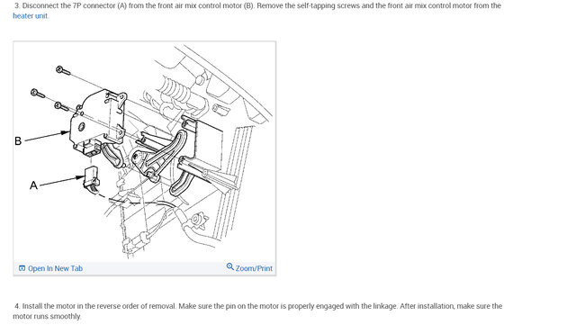

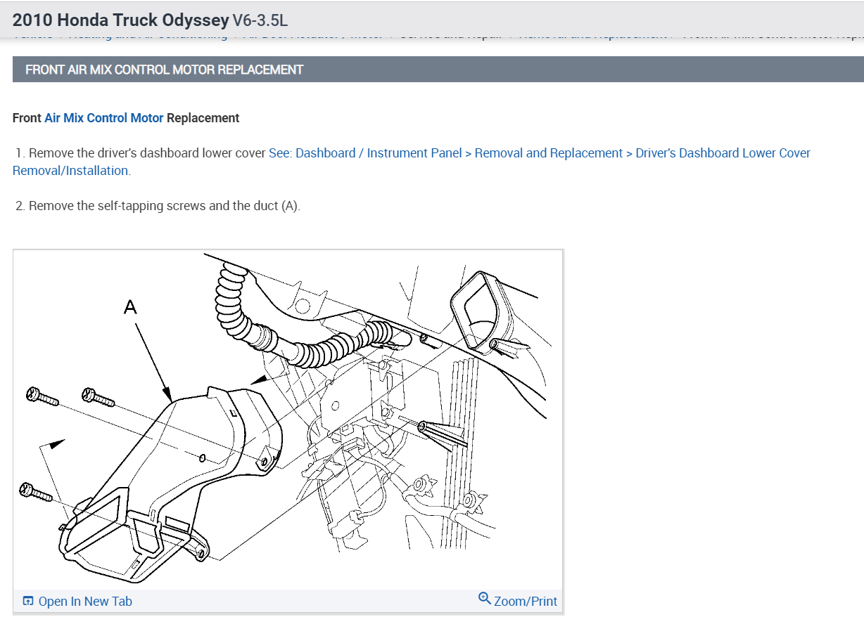

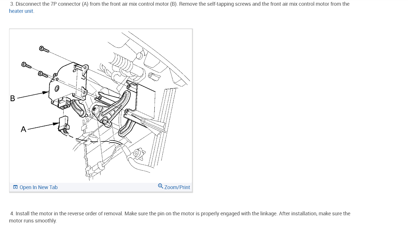

I would check the out pipe from the firewall with the system on and if it is cold, I would replace the temperature actuator under the dash here is the location. Check out the images (below). Please let us know what you find.
