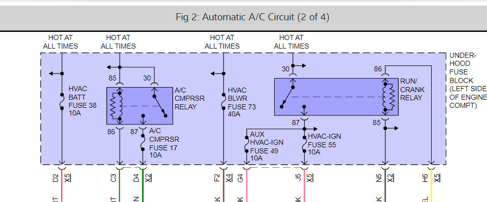

My A/C controls were working but they are not. Won’t come on or anything. I believe it has a short. I tested fuses relays even the control module. How much does it cost to get it fixed?
May 16, 2022 at 1:25 PM

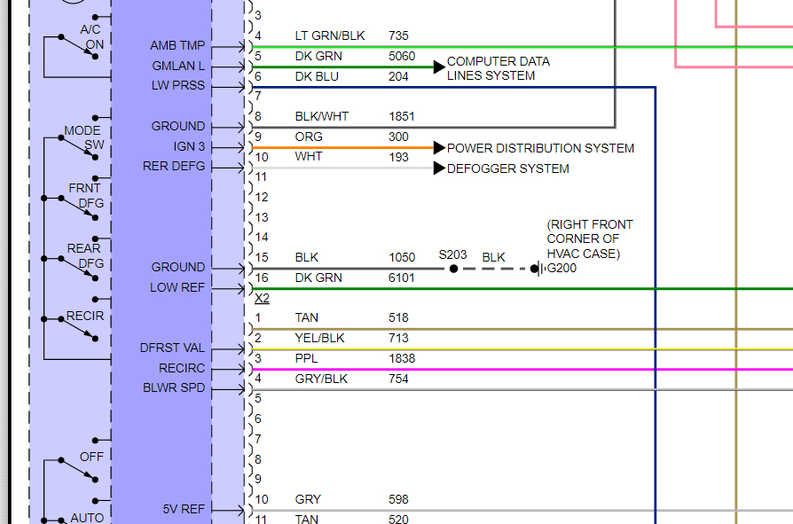

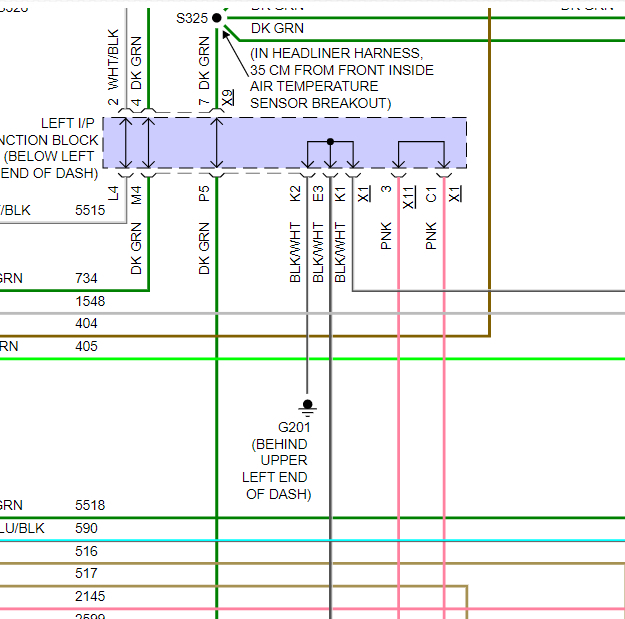

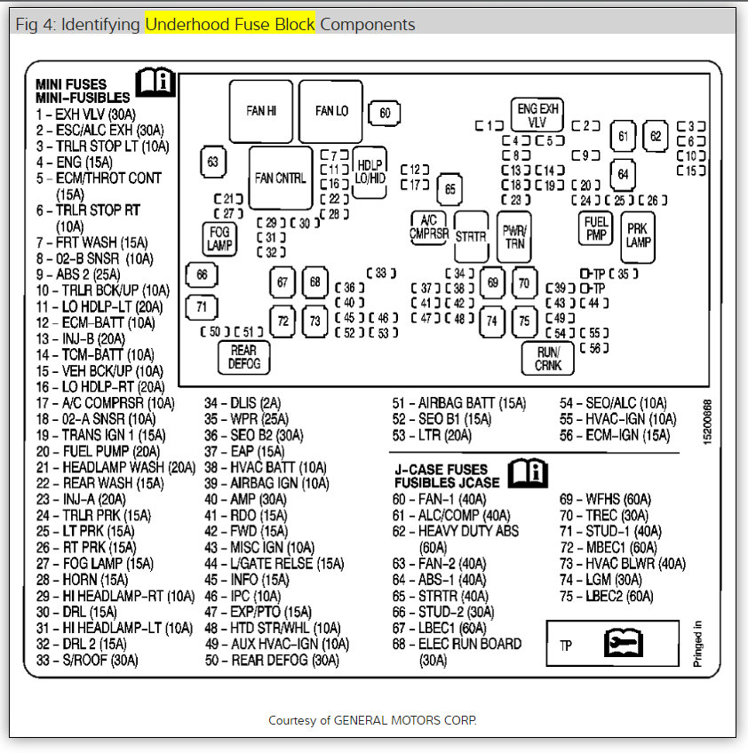

We need to check to see if the HVAC fuse # 38 in the under-hood fuse panel has power. This guide can help, and I have included the fuse location below. Also, there are two grounds that need to be inspected which I have included as well. As far as cost goes it can run anywhere between $300.00 and $800.00 depending on how good the shop is with electrical problems. We can fix it ourselves; I can walk you through it.
May 16, 2022 at 7:26 PM
JOSEAGUIRRE
Thank you so much Ken. Fuse 38 had no power. I got it back working. Now I have another problem, I just put in a new A/C compressor, but it is not coming on so that I can add Freon. I checked the relay. I bypassed it with a paper clip through the relay and it came on. What could my problem be?
