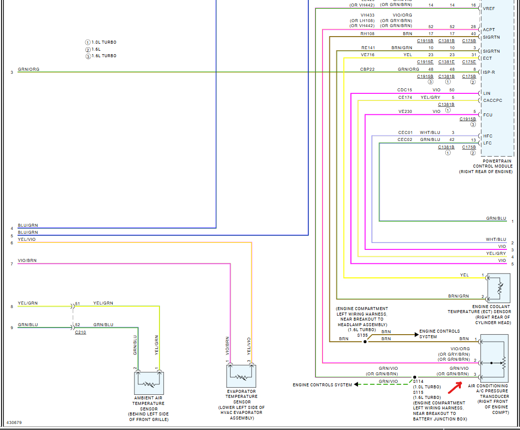

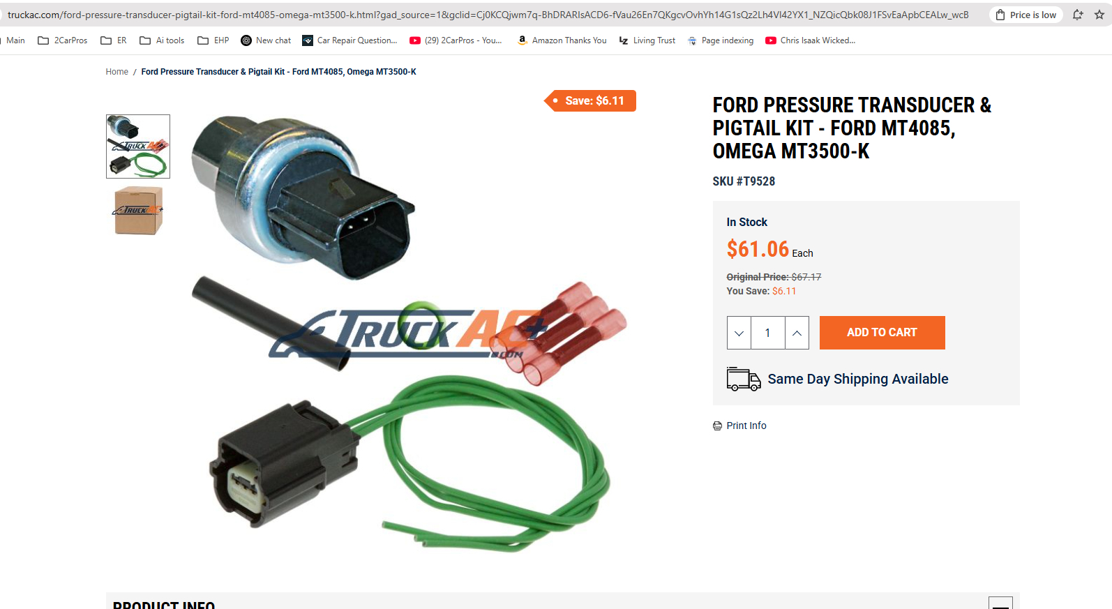

I had to replace the A/C condenser because of damage to the front passenger side. I think the plug that goes to this sensor at the bottom of the A/C condenser was cut off during the wreck. I need to replace but do not know the colors of the wire that goes to it or the type of plug. I have a pic of the only wire that i can find exposed. These wires are currently hanging out the side of the car.
