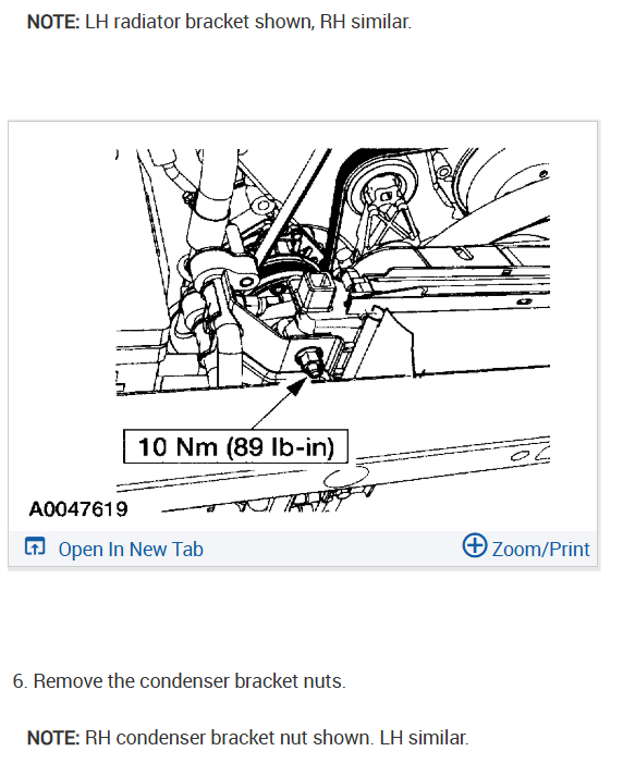

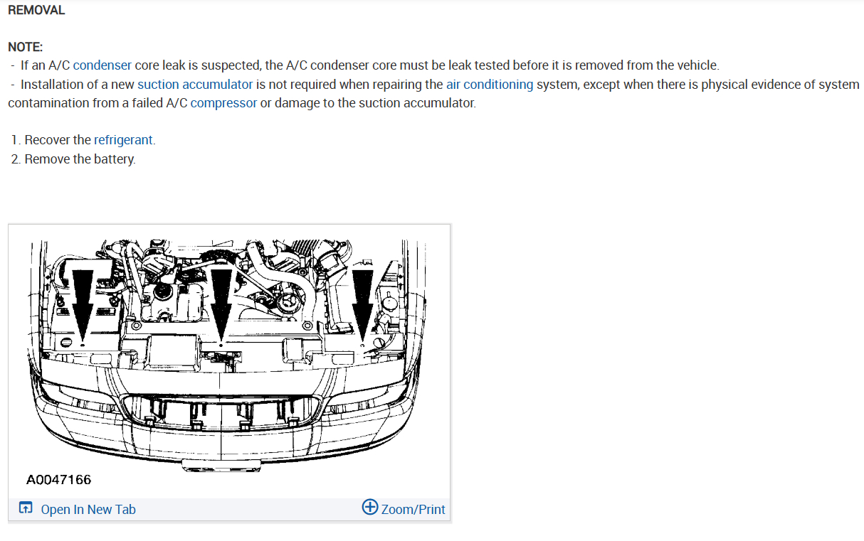

Purchased a replacement Condenser (#NC4011A)
How do I swap it out myself?
Thank you
Jun 9, 2025 at 1:05 PM
Alright! let do this, first you need to vacuum down the system and disconnect the battery. I would use a garden hose as well the hose off the radiator core which will help will air flow once the condenser is removed. Here is a video to help with the vacuum and recharge part.
https://www.youtube.com/watch?v=4EqdrBVb0sY
