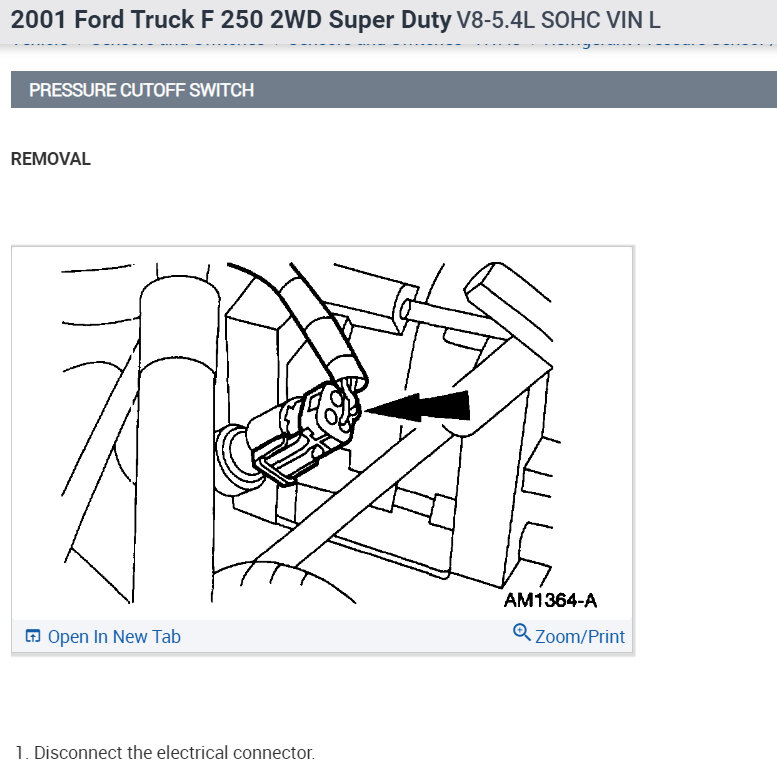

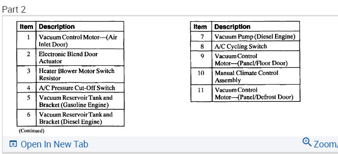

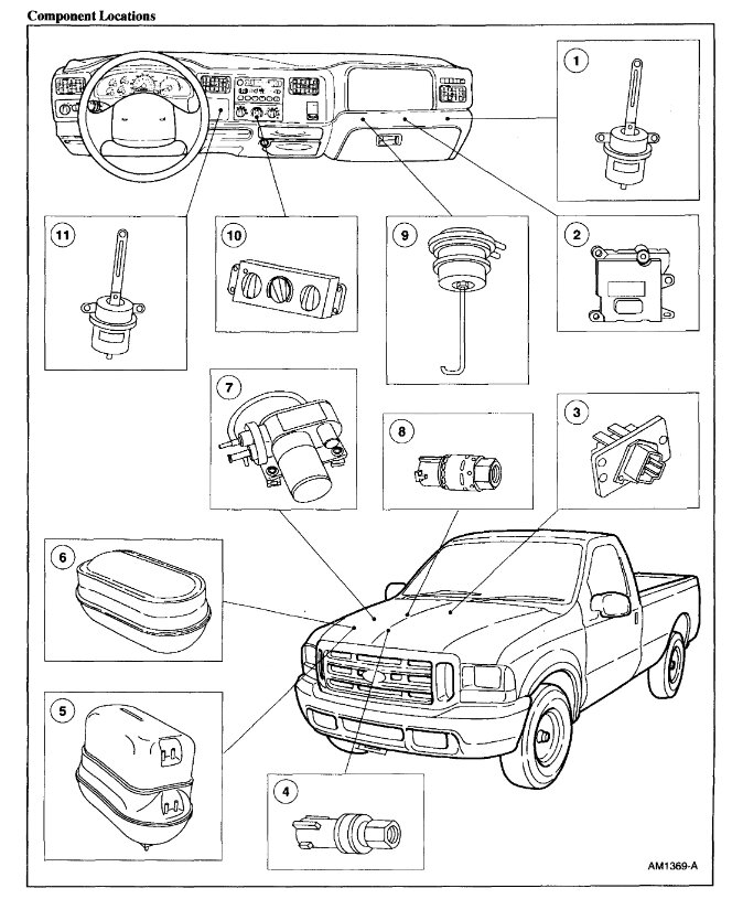

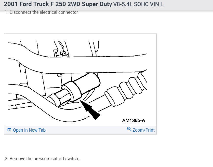

Those are the details. I’m thinking since it holds vacuum a leak is not my issue, and since both sides equalized at a normal rate and held, blockage isn’t either. My thoughts are it’s a pressure sensor, and that the increased pressure originally was on the low side it may be that sensor. Which kind of makes sense but also not. Idk. I have a basic understanding of a/c but am by no means an expert. And any research is ambiguous at the least. I kind of want to just replace both sides sensors and see what that does. I can easily find the low side sensor, but I can’t seem to find online where the high side sensor is. And when I look up the parts, it only gives one model. Are they both the same? Any guidance would be much appreciated.
