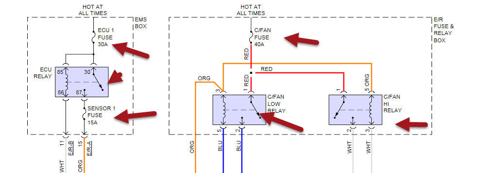

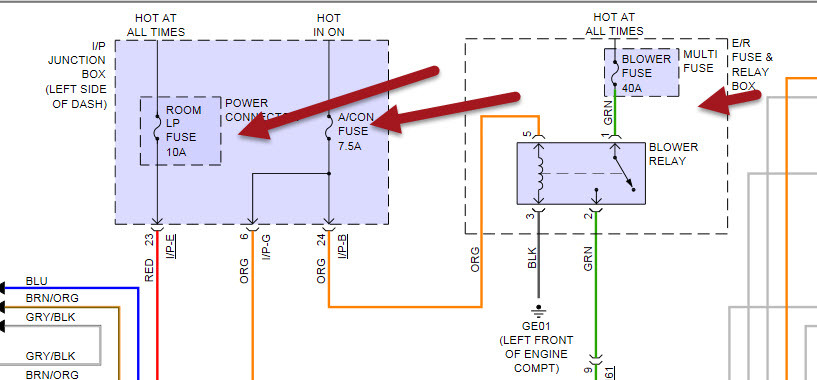

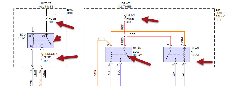

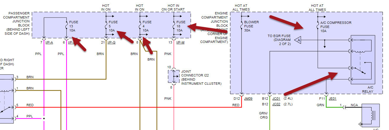

if it's reading 80 on both side compressor is either bad if it's turning or it' s not working. check items in pic first as it ma not be what you think. then have it scanned by a pro to see if control head is bad. also have it checked to see if there is a full system or not as it may not be. If this is auto temp control where you set the temp then it has to be scanned first due to it can be any sensor that is not letting the compressor work and that may be the problem. there are two switches one is what called a triple switch that tells the thermostatic switch whether to turn on or not...... so that has to be checked as well.

sorry I s the wrong info on fuses and relay, please disregard first diagrams as these are correct. the other info though still pertains.
