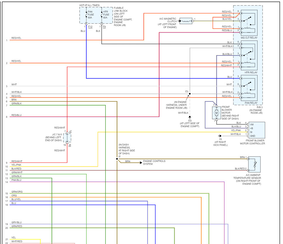

Good to hear. The first thing we need to do is see if the compressor clutch is getting power with the system on.
This guide can help you test for power:

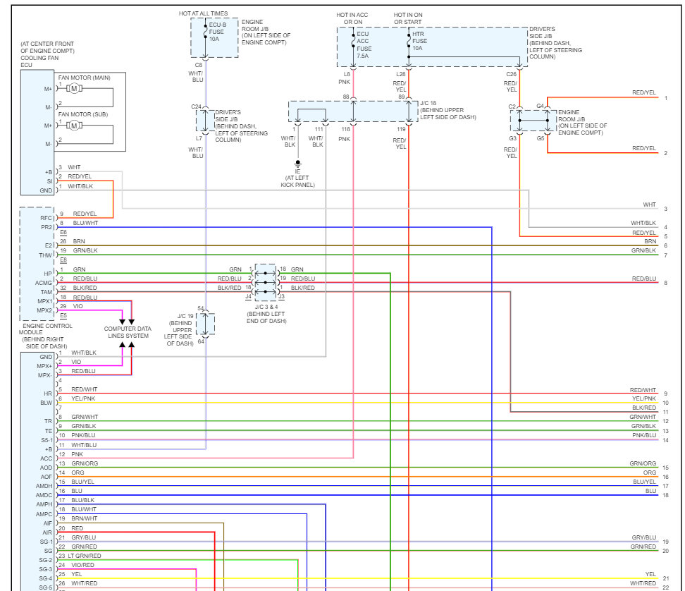

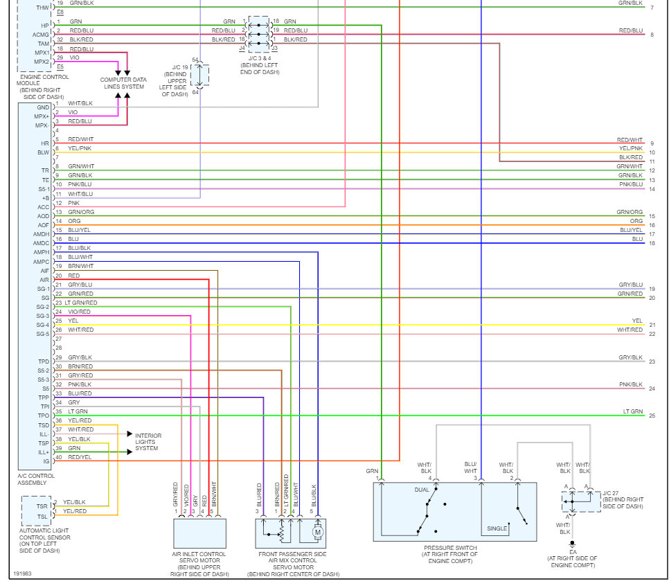

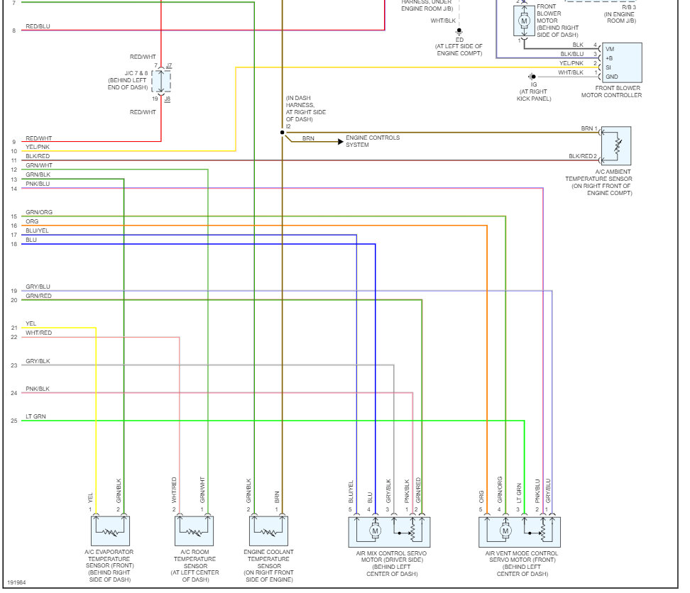

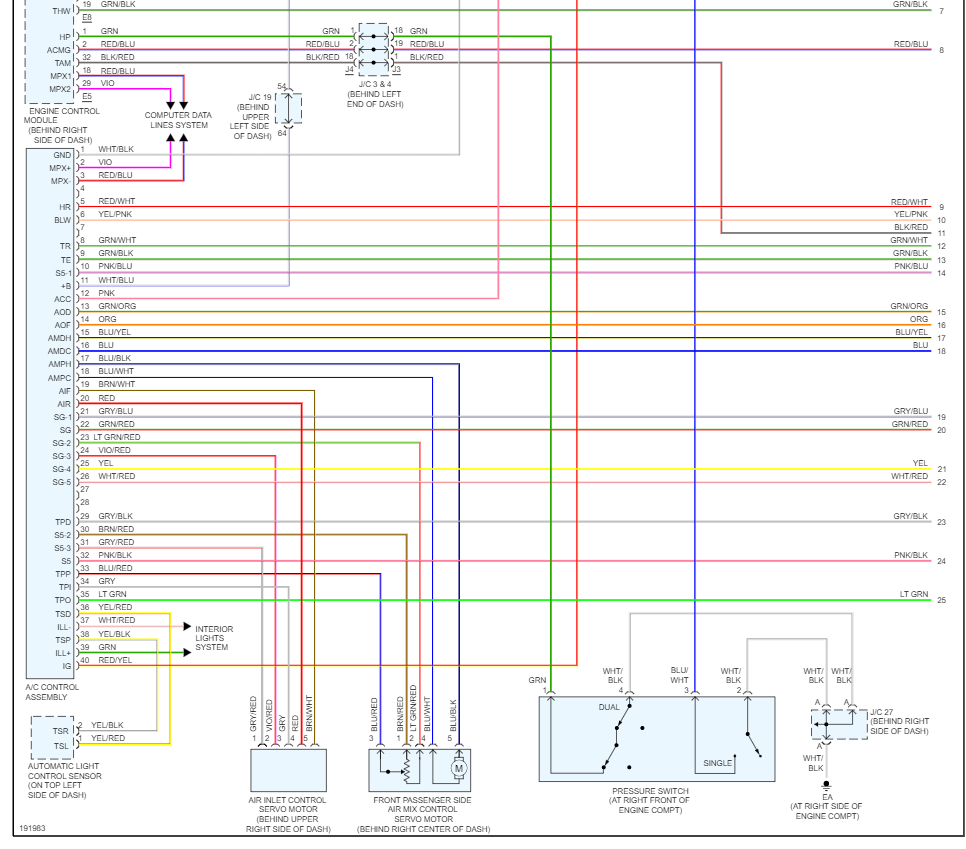

Here are the AC system wiring diagrams so you can see which fuses to check for power as well. Also, it will show which wire to check for the compressor and how the system works.
This guide may help as well:
https://www.2carpros.com/articles/car-air-conditioner-not-working-or-is-weak
Check out the images (below). Let us know what happens and please upload pictures or videos of the problem so we can see what's going on.
