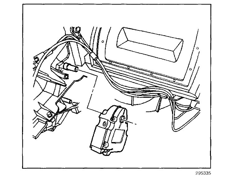

There is an actuator that fails and does not move the door for heat or cold. in your case, it is under the dash right side. you need to drop the lower panel and it is on the side of the case.

Another common cause of symptoms like that on a GM car is being slightly low on refrigerant. You can observe the actuator that Roy refers to and see if it is responding to commands correctly but I would also do an evacuate and recharge to get the charge exactly where it should be.

Roy is probably right then. It does sound like a blend door problem. There should be two blend door actuators. You need to determine which one is not responding to change.

Are all actuators accessible from under the dash?
Apr 18, 2018 at 3:18 PM
Yes, either under or through the glove box. You might need to remove some bracing.
