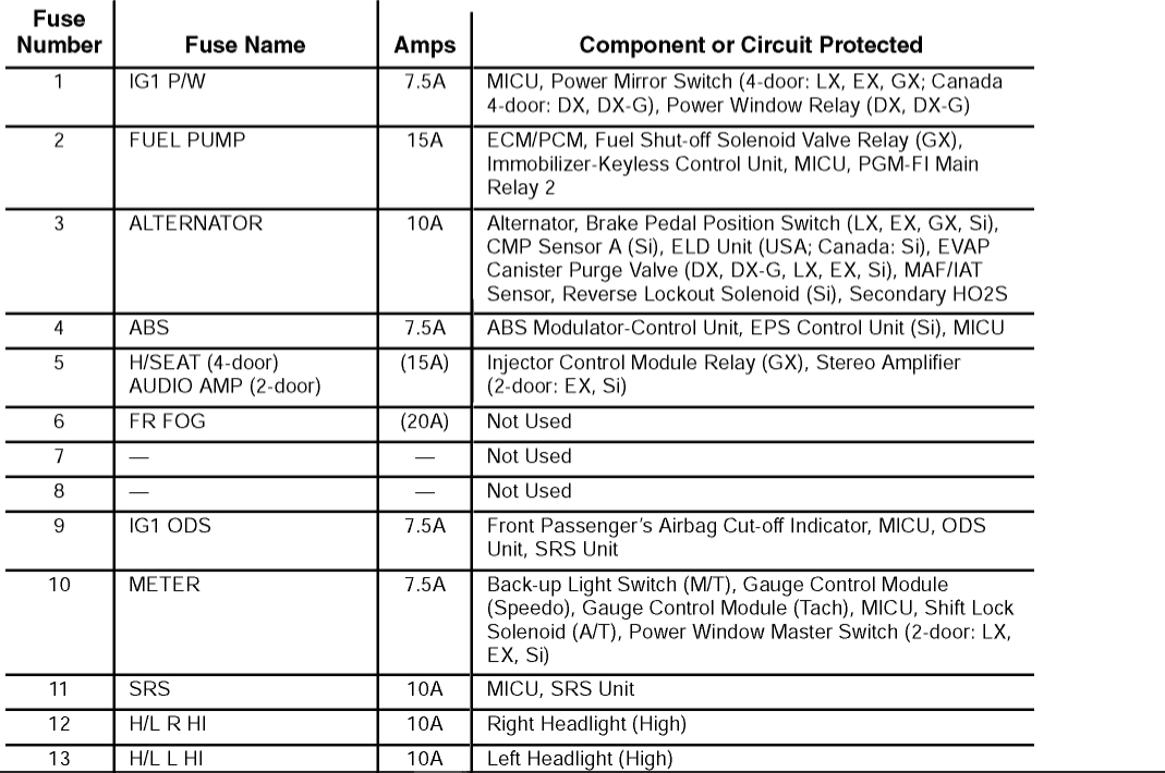

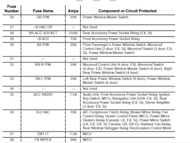

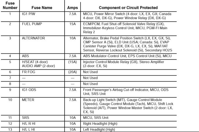

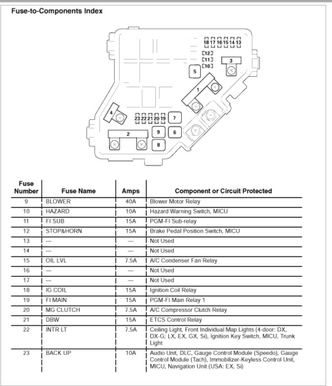

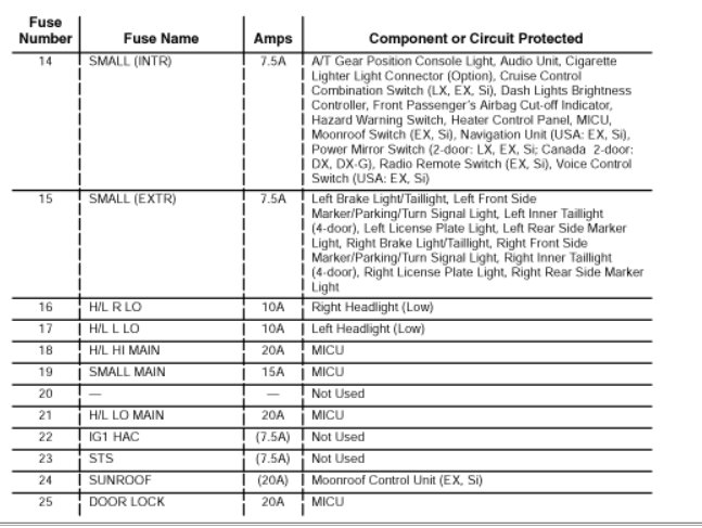

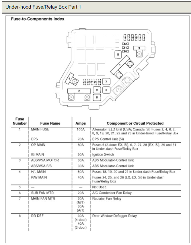

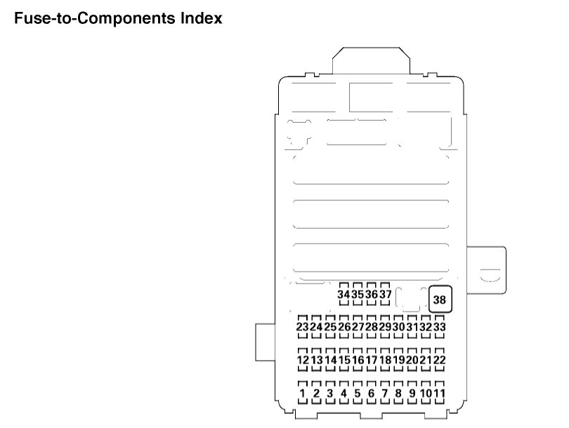

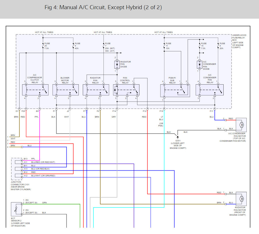

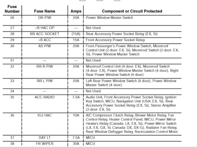

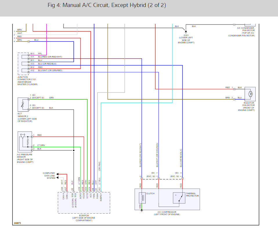

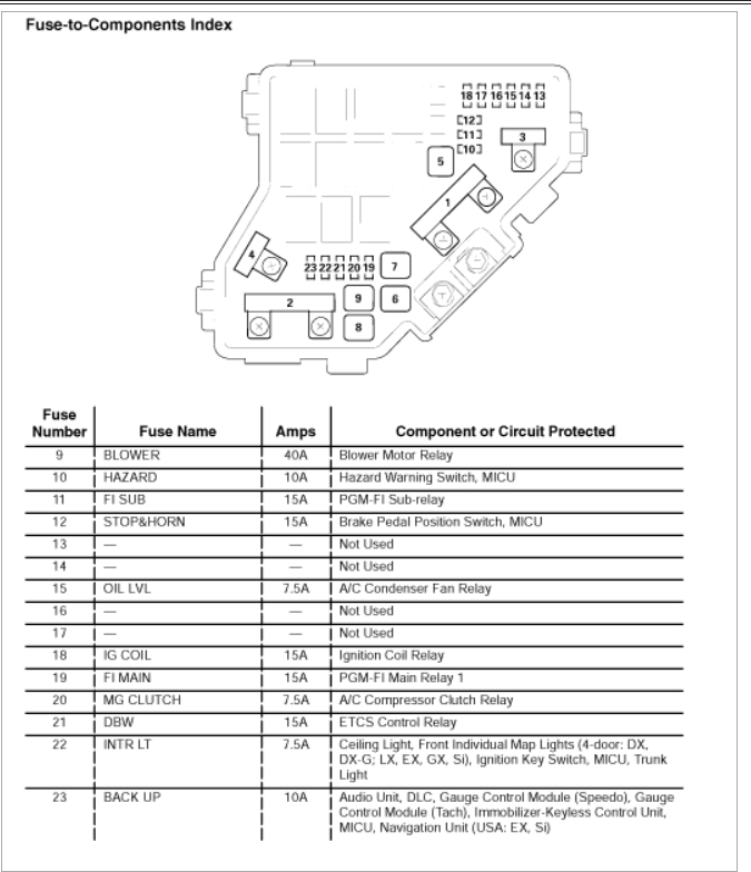

When you installed the new compressor was the plug a direct plug in or did you need to cut and splice the wires? There are 6 relays and 6 fuses that run the system. here are two guides to help you with the testing and diagrams below to show you which relays and fuses to test with the location of the fuses and relays as well:
and
