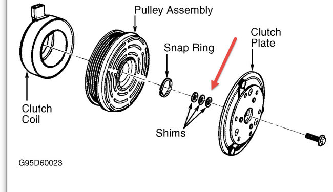

The clutch plates are grinding, turning when system is off, noisy.
May 25, 2016 at 11:37 AM
HMAC300
  • 48,601 POSTS
Check to see if clearance on clutch plate is correct if not it will burn up. It should be .014-.033" measured in three places if not add shims. See picture.
