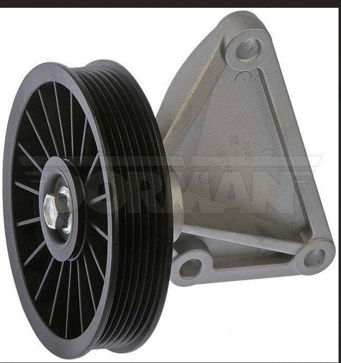

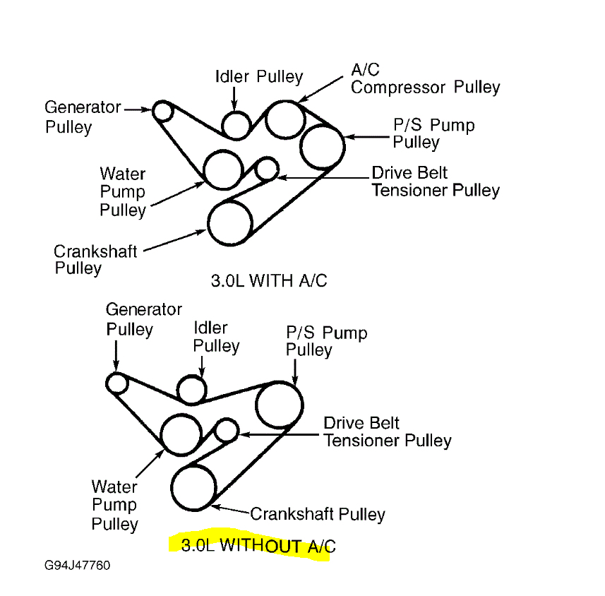

Chances are you won't be able to do it because of routing. Here is what I recommend. Remove the compressor and replace it with an A/C bypass pulley. They are very inexpensive, about the cost of a new belt. With this, you can use the old belt and not change routing.
I attached a pic of what I am referring to. There are many manufacturers that make them and most parts stores can get them. I know Dorman makes one for this vehicle. I believe the part number from Dorman is 34223. Check that out. Google search Dorman part number 34223 to confirm.
