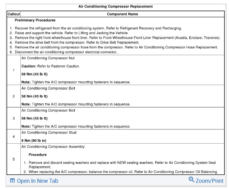

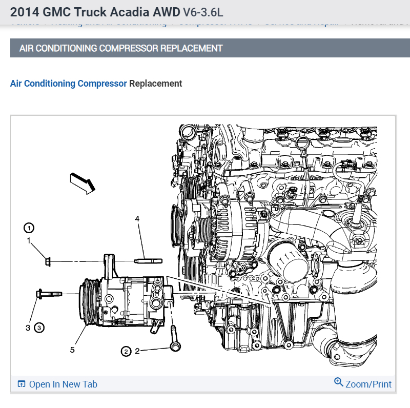

If the charge is okay, you have an A/C compressor that is going out. Here is a generic guide to help you step by step with instructions in the diagrams below to show you how on your car:
https://www.2carpros.com/articles/replace-air-conditioner-compressor
You will need to vacuum down and recharge the system.

Check out the images (below). Please let us know how it goes.
