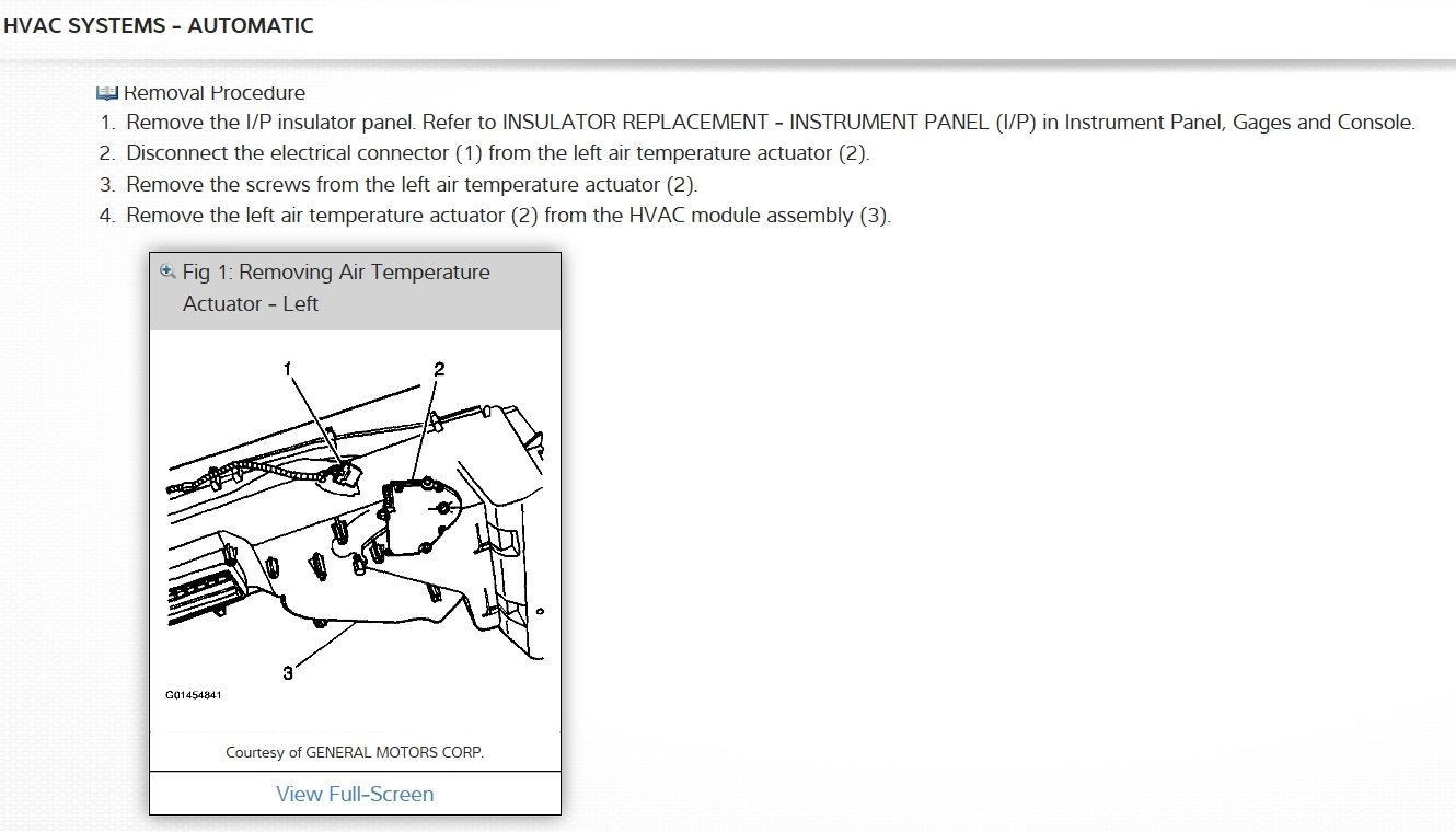

It is a common problem with these vehicles that the blend door actuator has gone out, so the temperature door is not moving into position.
Here is the instructions and diagram of what it takes to change it
