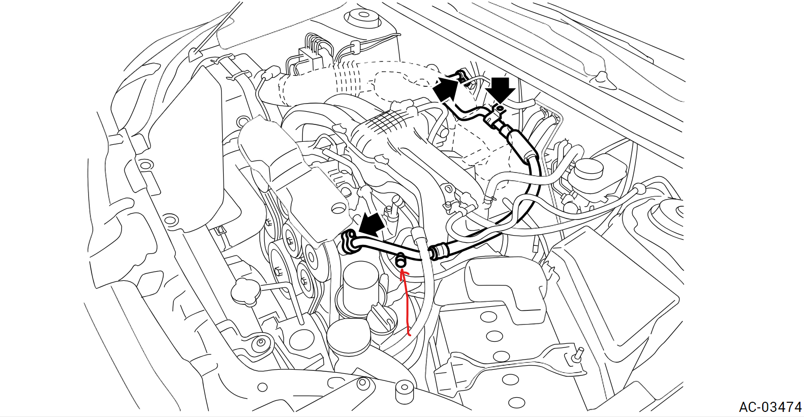

Using RF-134a in your Subaru's A/C system should be safe and compatible. Here is a video of how the job is done and I have included where the service port is so you can check the refrigerant levels.
