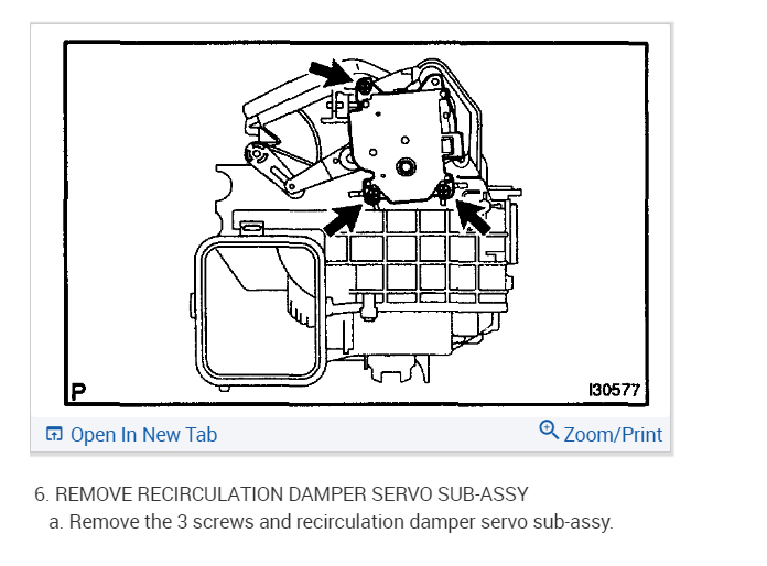

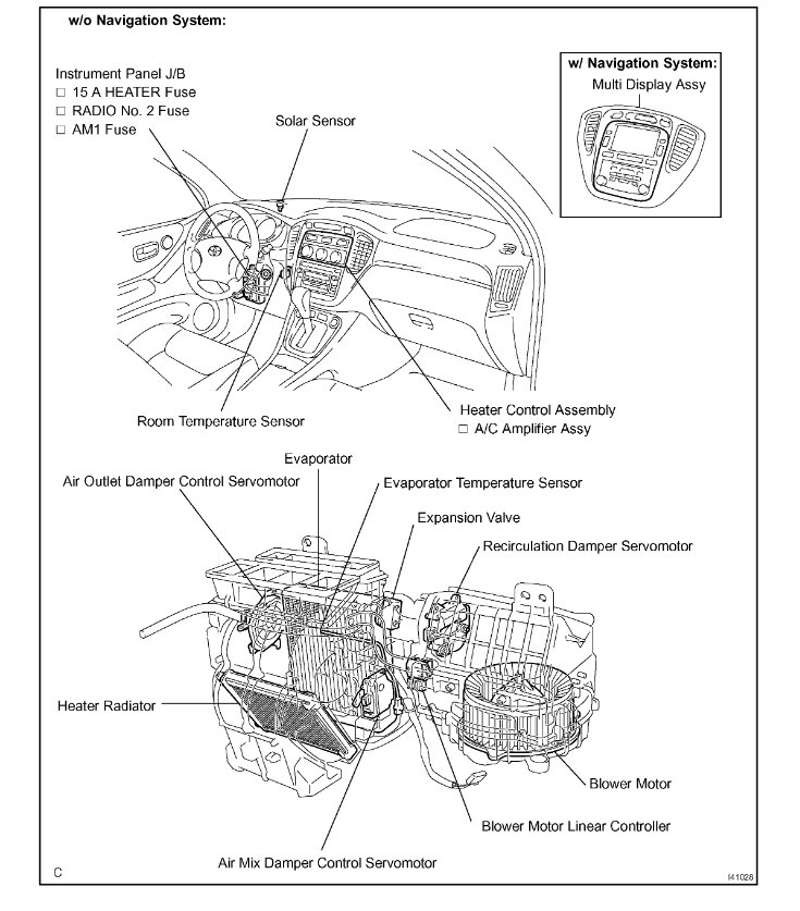

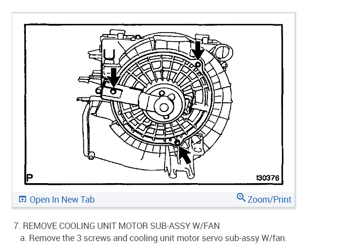

The fact you went through a puddle, it probably got the A/C belt wet and that made it slip or the compressor clutch slip, please check the belt. Also, if you let the system cool a bit it sounds like it starts working again which it telling me you might have too much refrigerant in the system, can I ask if you had the system recharged recently? If not, I would lean towards a temperature blend door actuator, they call it an air mix servo motor. This can guide can help and I have included the location of the actuator in the diagrams below. I would remove the actuator and then work the temperature knob to see if it moves okay.

It sounds like you reset the system when you pulled the fuses which can be the air mix door actuator. Also, the system can be low on refrigerant. This guide can help:

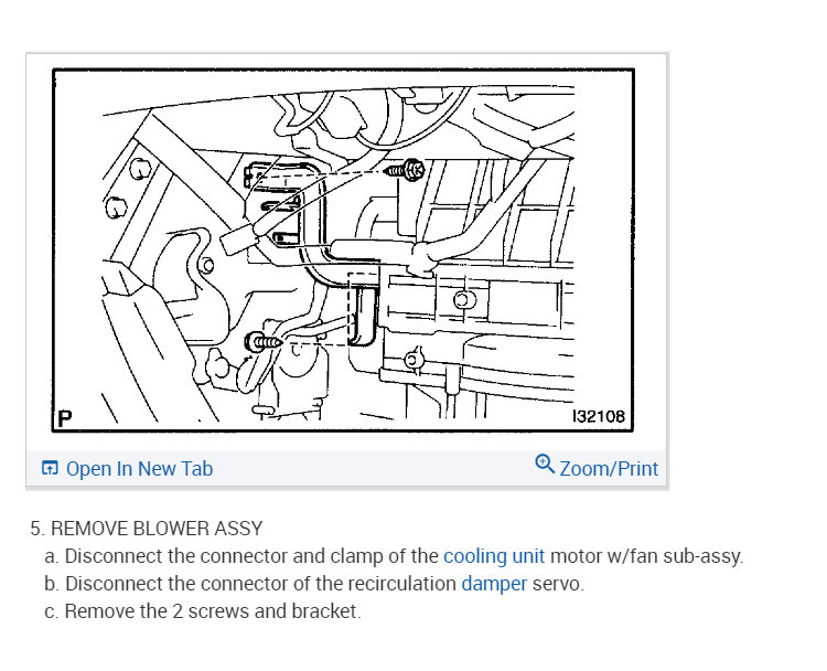

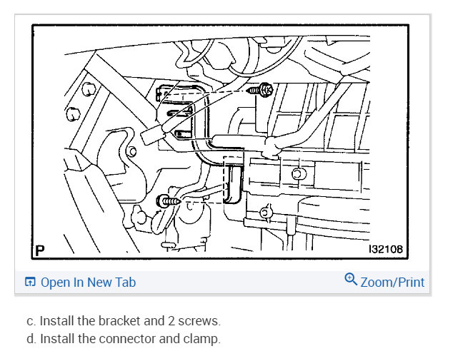

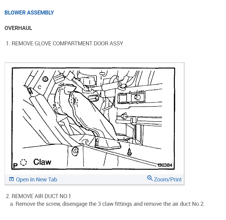

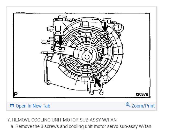

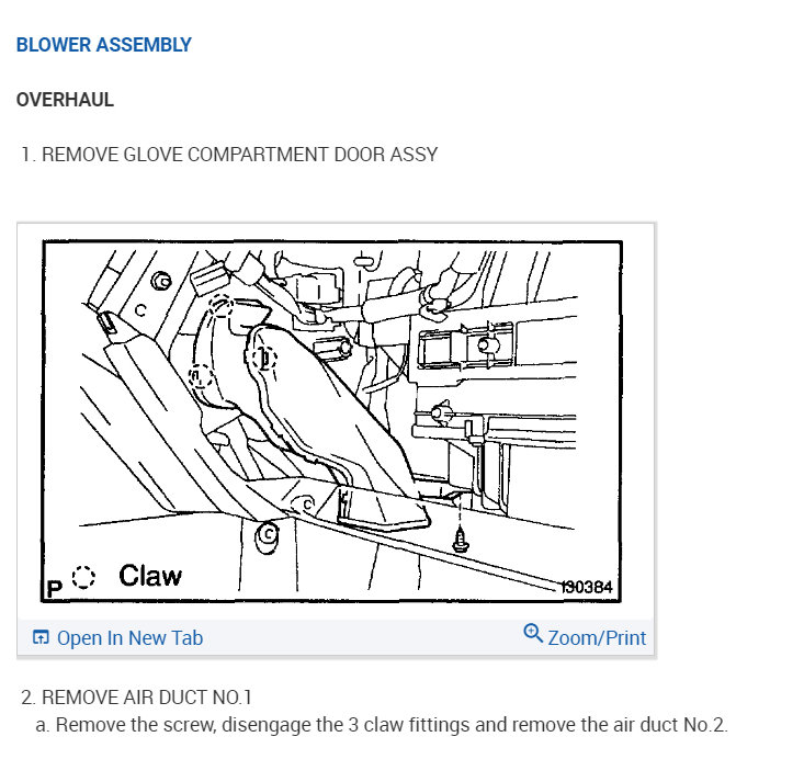

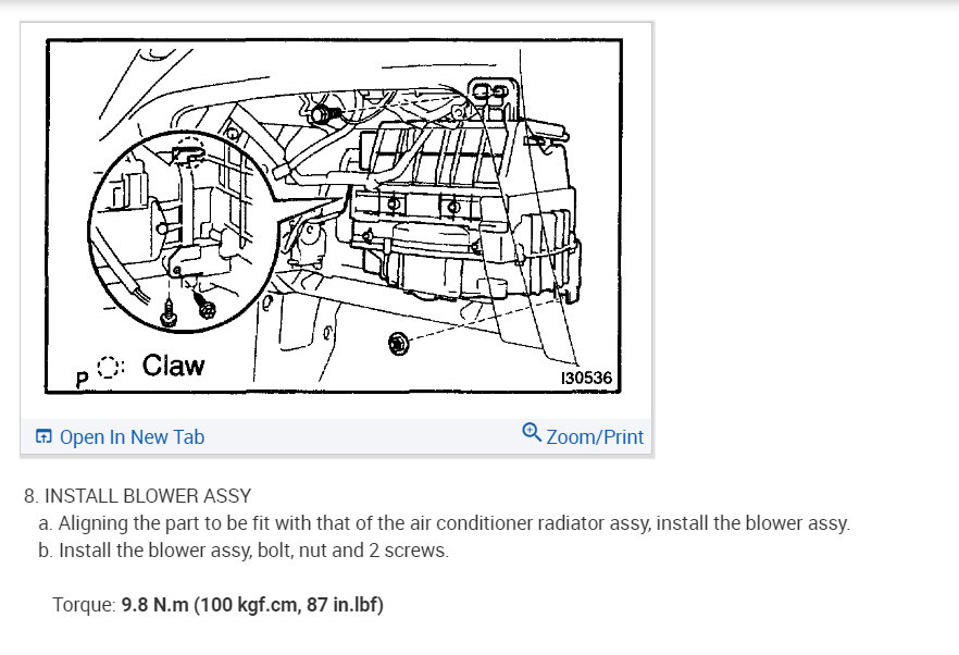

This sounds like the blower motor is going bad. To be sure let's check the power and ground to the blower motor once the air stops, this guide can help:
https://www.2carpros.com/articles/blower-fan-motor-works-on-high-speed-only
The blower motor location is tin the images below. Check out the diagrams (below). Please let us know what happens.

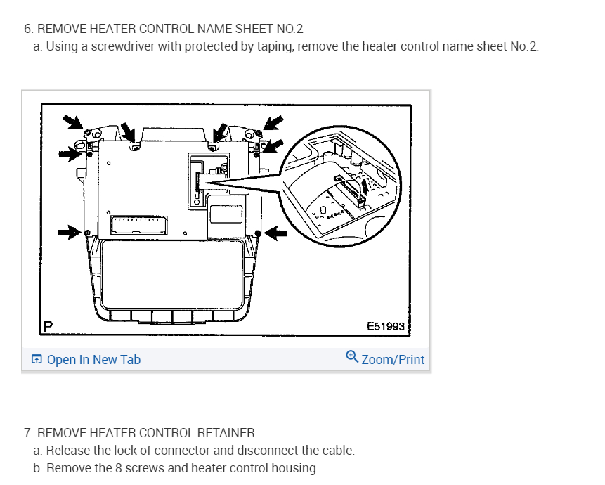

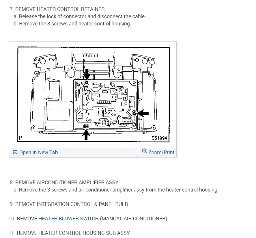

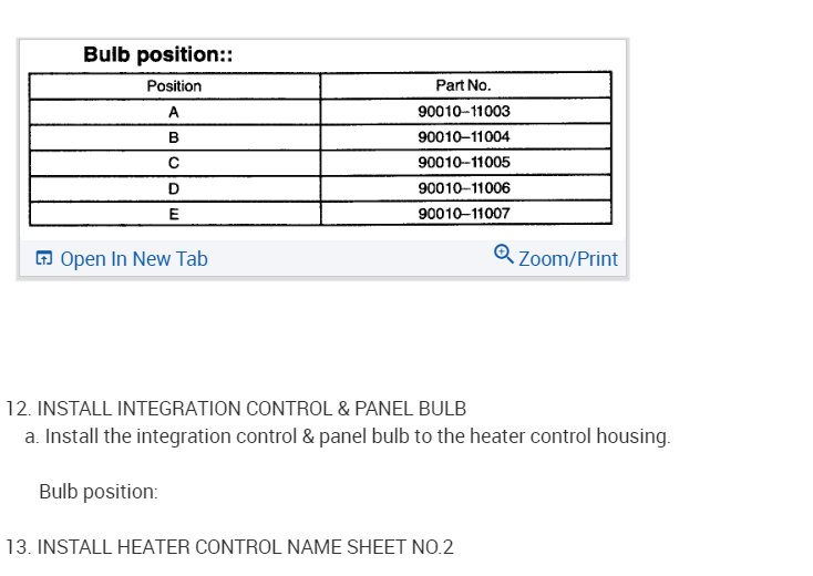

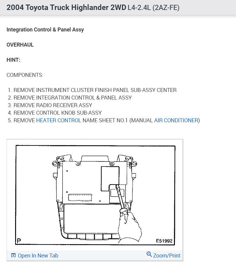

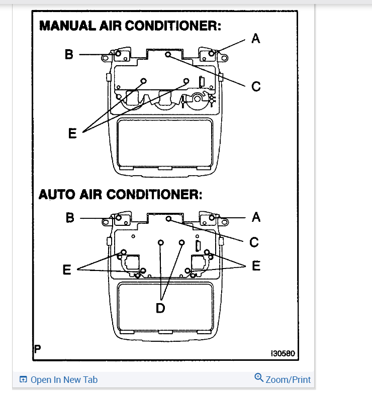

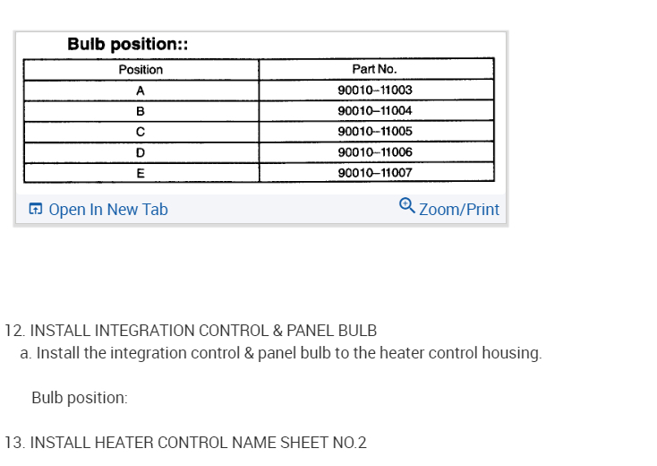

No, it doesn't. it could be the HVAC controller if it isn't the blend door actuator. Let me know. Check the images below.
