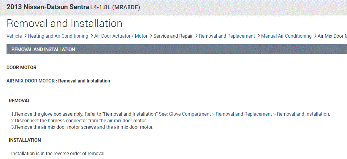

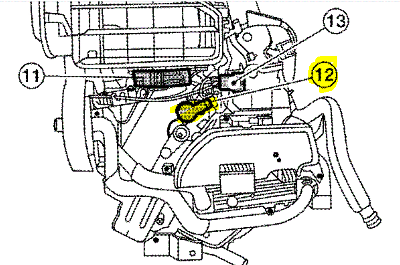

There is a chance the blend air door (air mix door) actuator is not working. This actuator is what determines the air temperature entering the vehicle.
What I would suggest is to remove it from the HVAC box and while it's still connected to power, see if it responds when you change from hot to cold on the controller.

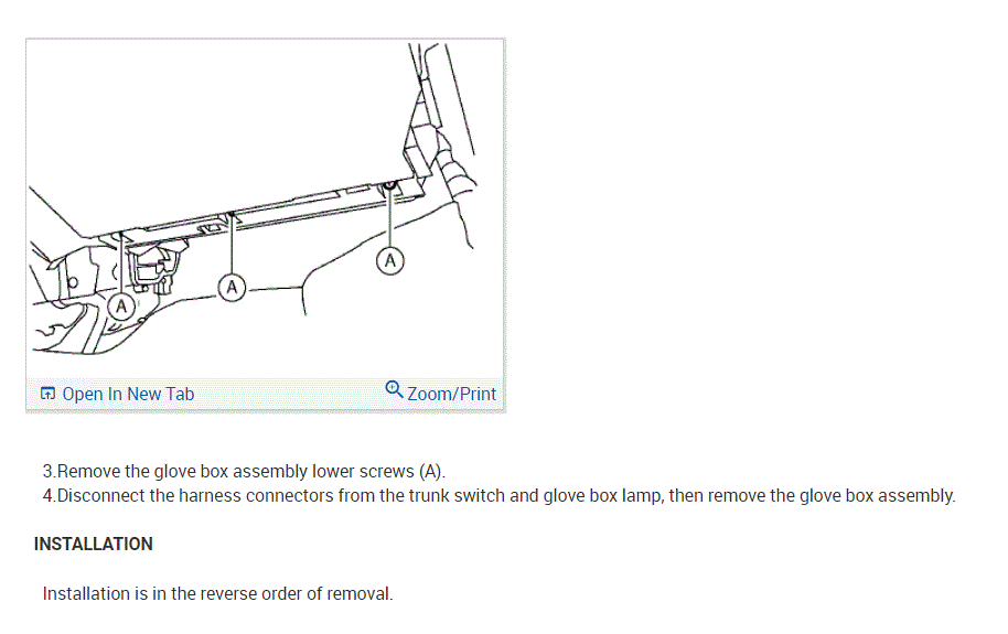

This actuator is behind the glove box. If you look at pic 1 below, I highlighted the actuator. Pic 2 includes the directions for removal and replacement.

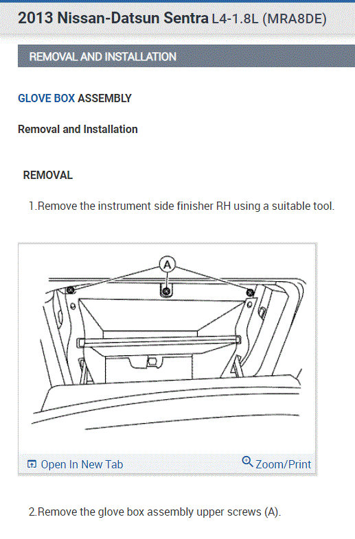

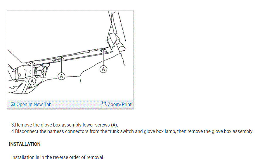

The last two pics show how the glove box is removed.

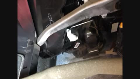

The video was the mode door actuator. That changes the airflow direction. If the compressor is working and it is fully charged, that actuator has to be causing an issue. At this point, I would recommend removing it to confirm nothing is disconnected or damaged.
