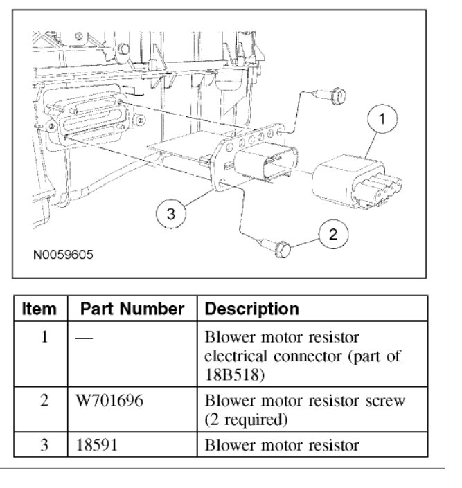

It sounds like you have a defective blower motor resistor. Was it a factory Ford part?
I would try switching it out again.
Here is a guide to help (below):

Thank you Ken, I was hoping a $76.00 part was not going to be defective, but then again you never know. I did order it online from Advance Auto however per pickup at local store, did that on purpose since the store was closed at time of purchase. I will say the box it was in did not have a seal. I will take it back this weekend.
A/C is working but on low fan speed and 72° only.
so my wife is happy at the moment. ;)
