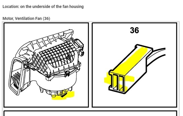

Also, these vehicles are known for having a weak connector plug at the fan motor,. Over time, they break down. I've actually seen them cause fires. So, I would really like you to check the connection to the blower motor to make sure it isn't melted or damaged in any way. I attached a picture. On the right is the connector that I'm referring to and the left is the blower motor. I highlighted approximately where the plug connects.
The blower motor is under the dash toward the passenger side. Please check that and let me know what you find.
