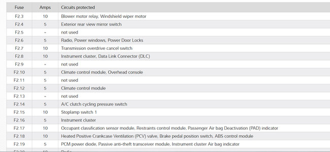

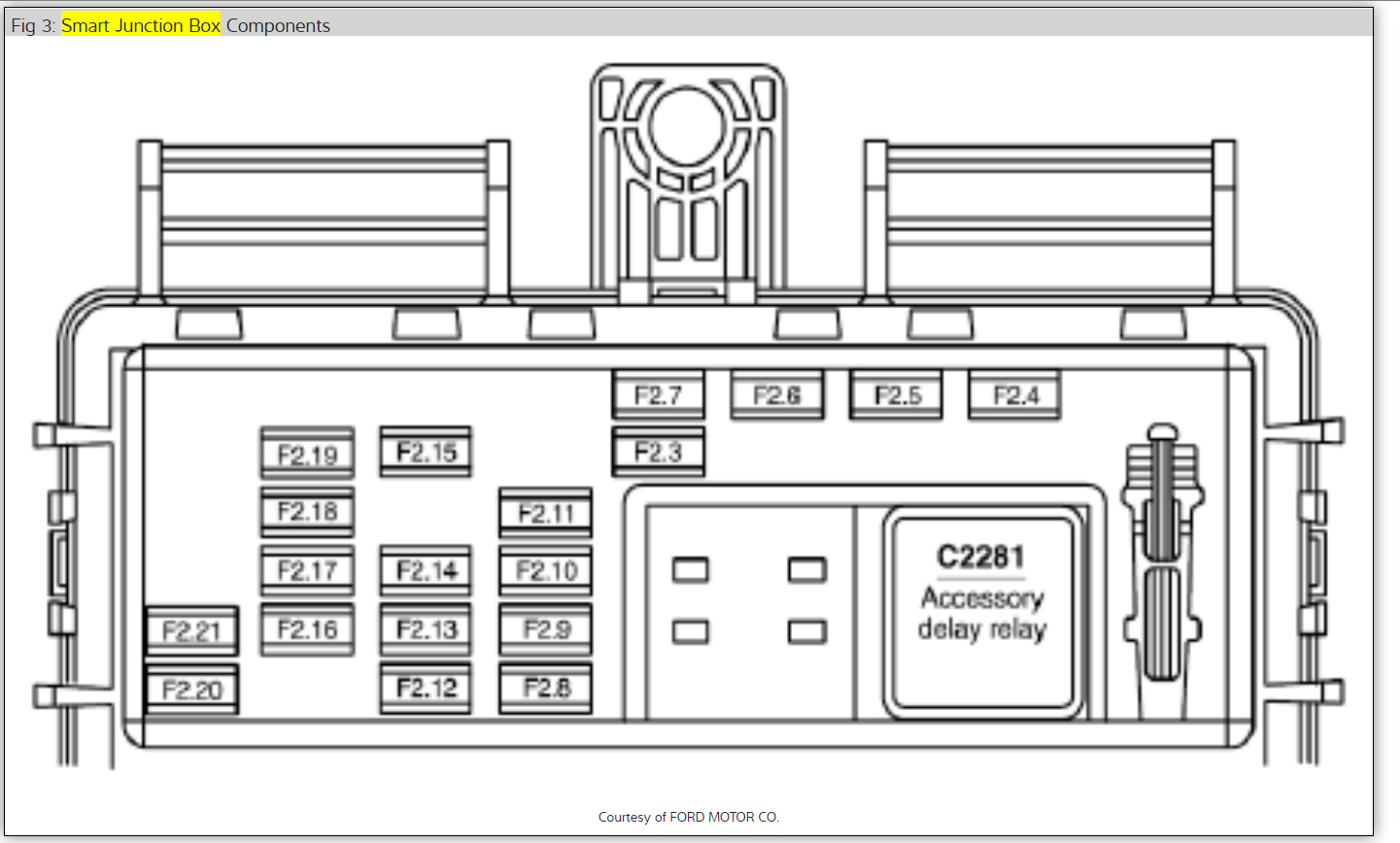

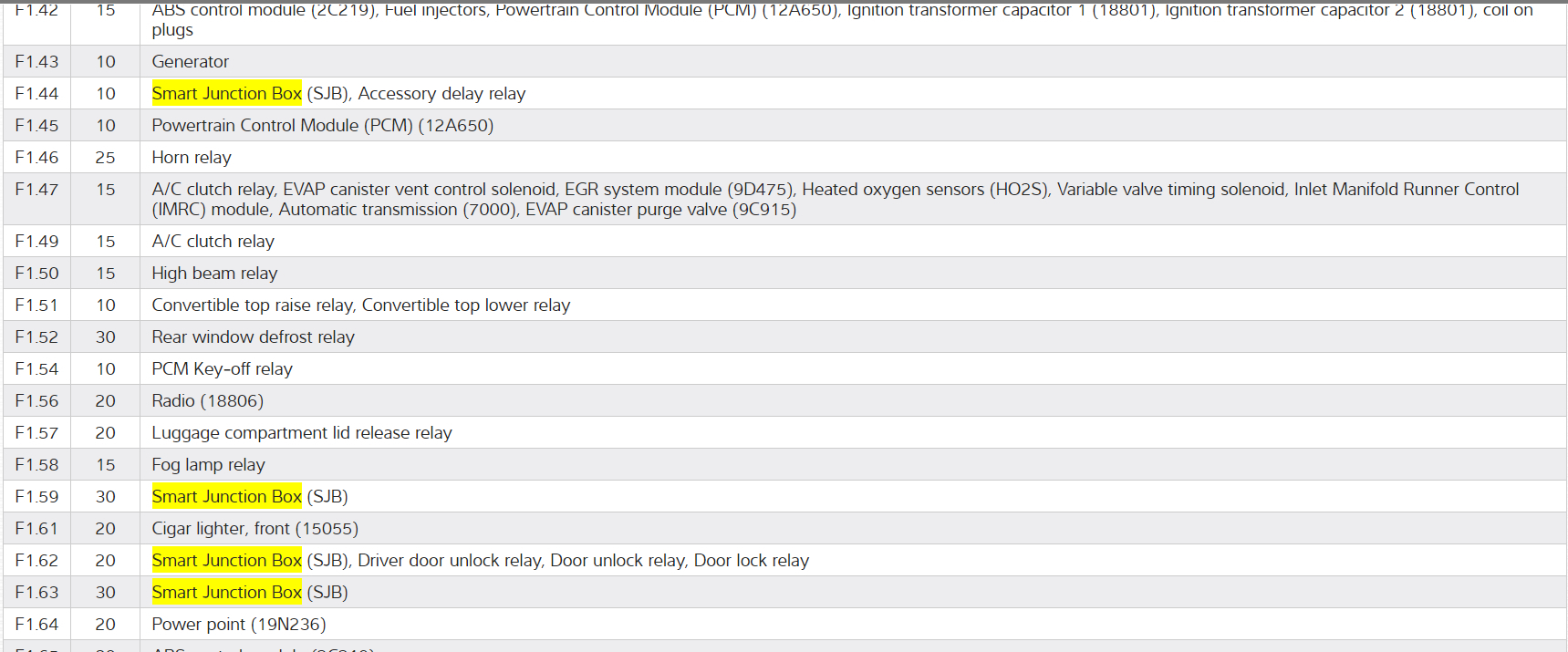

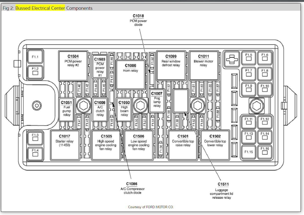

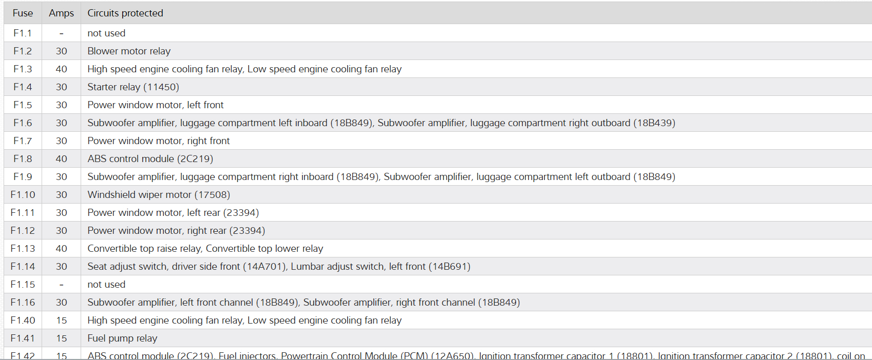

Hello, I have a 2005 Ford Mustang. My Air Conditioning stopped working, and I think it may be a blown fuse or relay. Do you have a fuse diagram for this vehicle? I checked both fuse boxes, and both say to see owners manual, which I do not have (Bought the car used).
