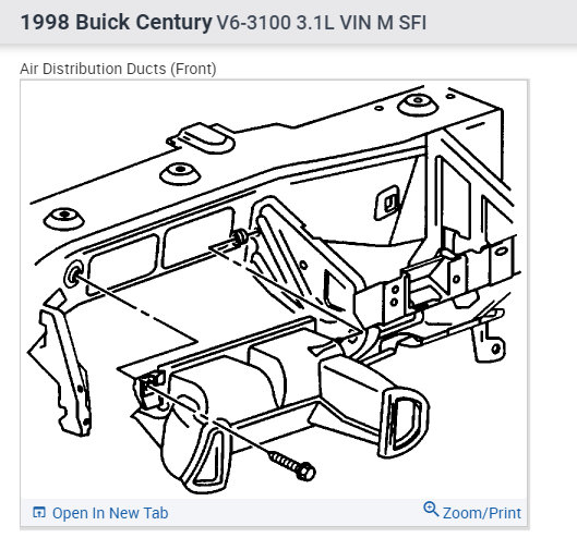

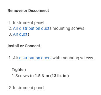

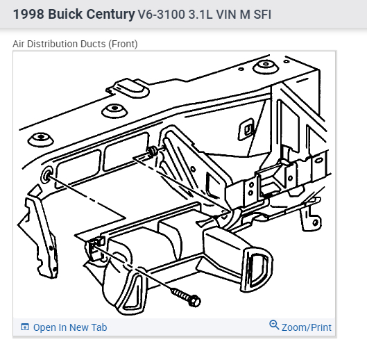

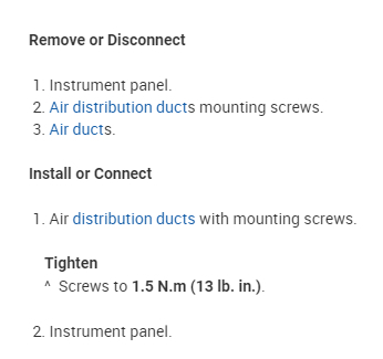

I attached a pic below and the directions for removing the main air distribution air ducts. The manual indicates the instrument panel needs to be removed. However, you may be able to reach enough of the bolts holding it in place to clean it or at least check.
See pics below.

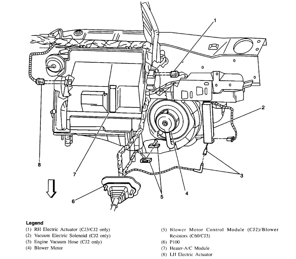

There is a left side blend door actuator that would like it is bad. here is a generic guide to help you see what you are getting yourself into when doing the job and the location of the actuator in the images below:
