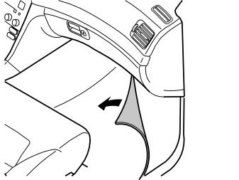

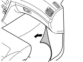

- detach the floor carpet at the front. Fold the carpet back.

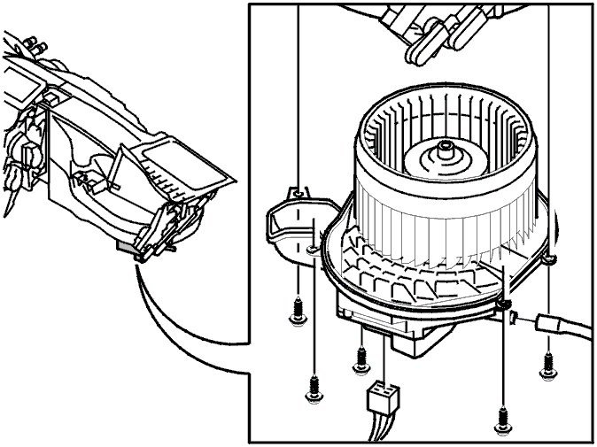

Engine
Remove:
- disconnect the connector
- the 5 screws for the blower fan motor
- detach and remove the blower fan motor.
Engine
Remove:
- the connector
- detach the cover from the motor
- the 2 screws on top
- press and pull out the motor and fan hub. Use a screwdriver for example.
Installation
Install in reverse order.

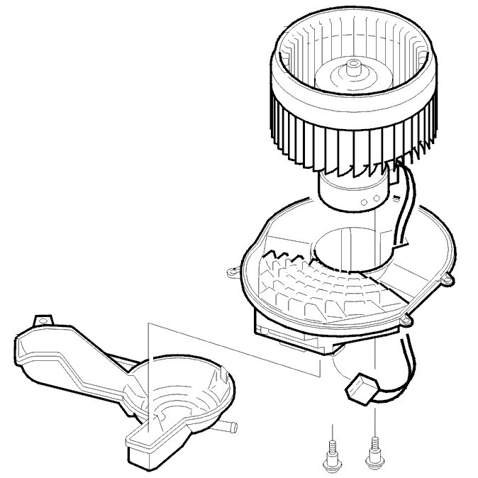

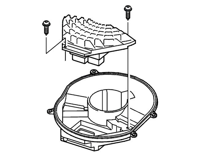

Power unit
Removal
Remove:
- the blower fan motor with the fan hub as above, see Fan motor
Remove:
- the power unit, 2 screws.
Installation
