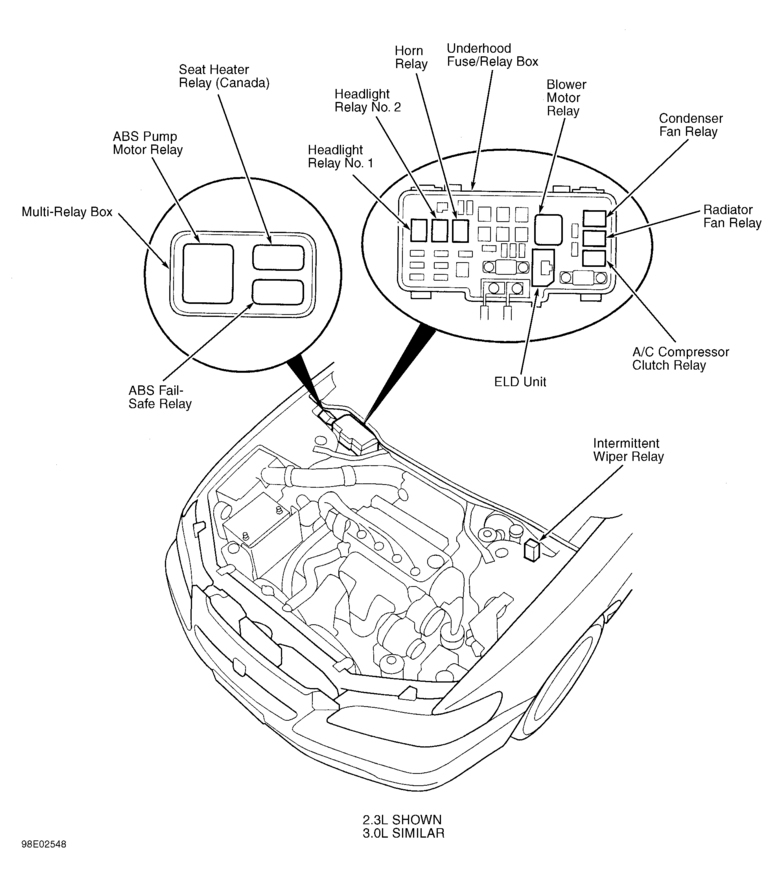

Where is the a/c clutch relay located on my 2000 Honda Accord?

Everything else checks out.just need to know where the relay is....
Apr 8, 2016 at 1:29 AM
Hi, I did some research and found this for you, please let us know how it goes,
