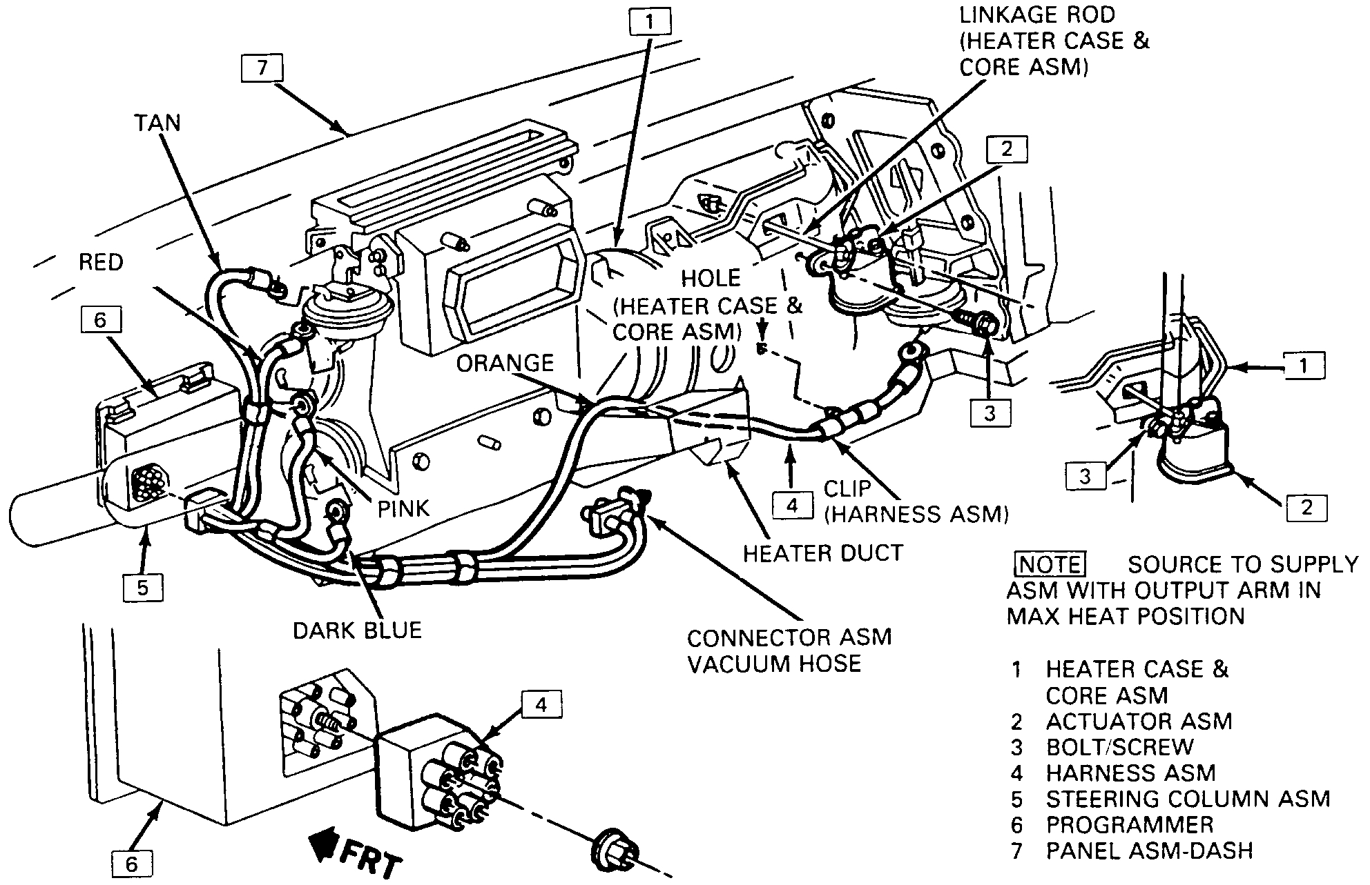

Another item to check would be the vacuum lines, The 88 uses vacuum to control most of the actual doors and the symptoms you have sound like a loss of vacuum to the system as the throttle opens up and allows the air door to open and let ambient air pass.
