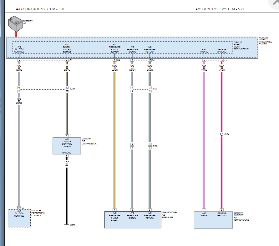

I hook gauges to both high and low side while truck running clutch doesn’t engage. Low side psi is 100. The high side it’s 100 to 150 as well. What could it be? It was working and I had to floor it to prevent getting rear ended then it quit blowing cold.
