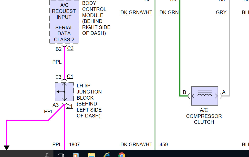

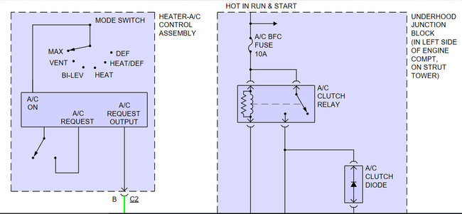

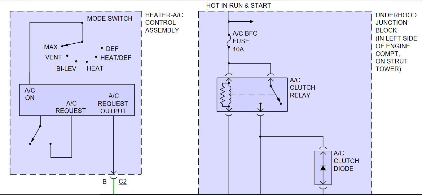

HMAC300
  • 48,601 POSTS
then you have an electrical problem like a relay or fuse but it must be scanned for codes by a mechanic. it may be a body control problem or a serial data problem which a mechanic with a scanner has to scan for. Auto parts scanners will not pick these problems up
