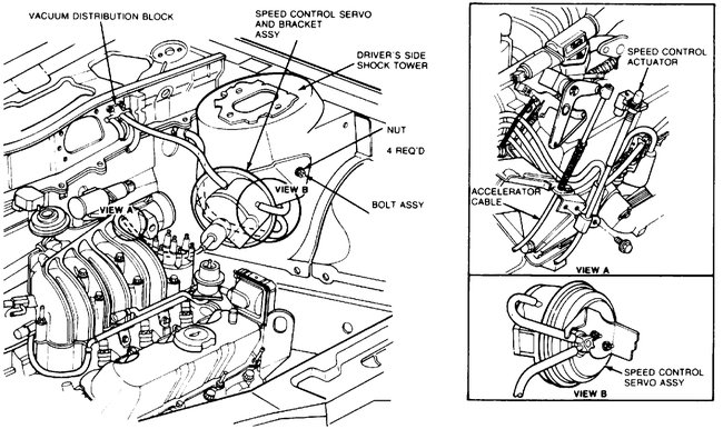

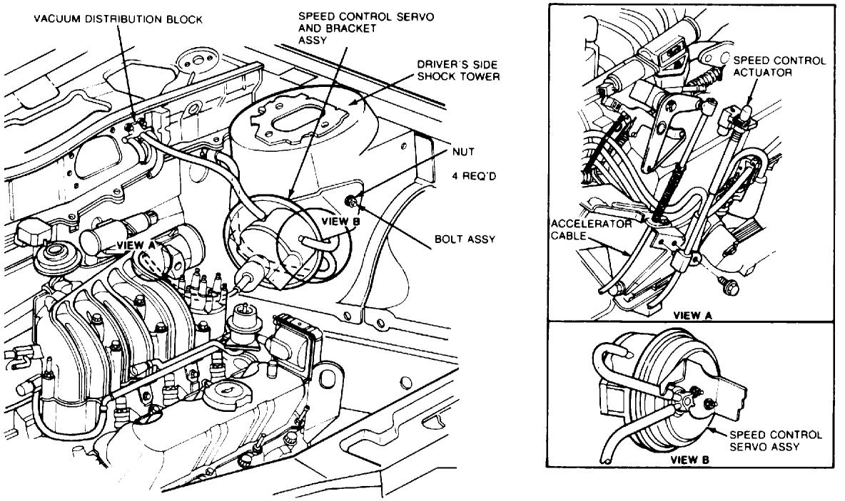

Well if you have the manual (3 dial) HVAC control the problem is probably the same thing that is keeping your cruise from working. A vacuum leak. Both systems use vacuum to operate and both get that from the vacuum block, it also feeds a reservoir with a check valve. I would check over the vacuum lines for leaks/damage and check the vacuum reservoir check valve.
