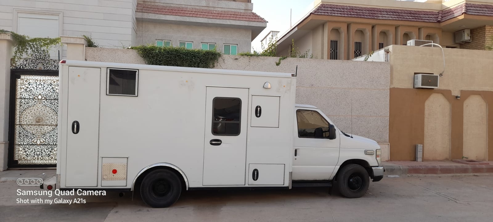

Hi, l have an e450 super duty was ambulance that i converted. my problem is, when i drive and start accelerating hot air comes out from vent when i stop in traffic light it stops even the A/C on off positions. when i turn the A/C on the on position i have a very good cold air. where should i look to stop vent from blowing hot air when A/C is on off position? Thanks

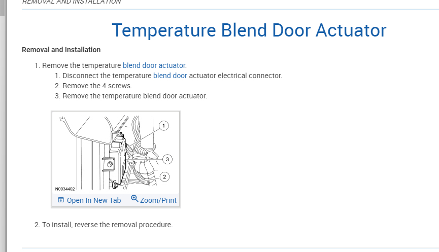

Next the most likely cause of this is a blend door issue. So, we need to access the door and when it is blowing hot when the A/C is on, we need to access the blend door actuator and see if it is moving. If this is happening, then I am pretty sure the actuator is the issue.
Take a look at the attached for this actuator but let me know if I am understanding this correctly.

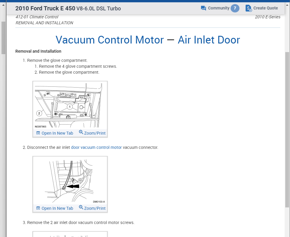

It sounds like the air inlet door is stuck so that the air is allowed in at all times. So, when you have the AC on it passes the air over the evaporator and cools it down.
When you have it off, it is allowing the hot air to come in from the engine or outside. The acceleration forces it in, and you feel it through the ducts.

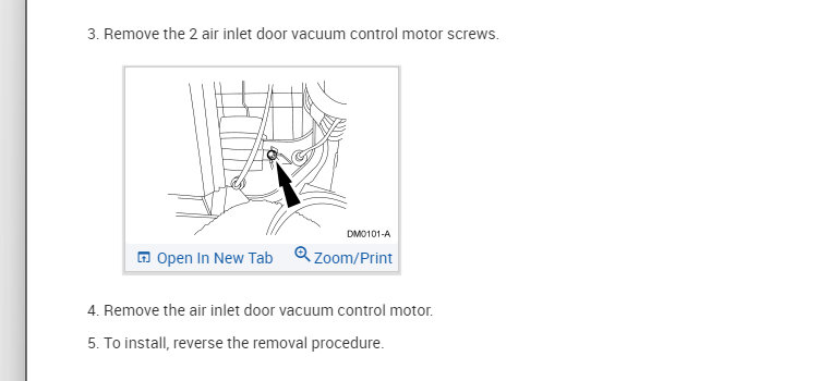

I am attaching the process below on how to replace this. If it were me, I would try replacing this based on this info.

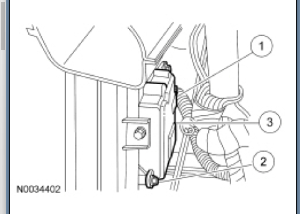

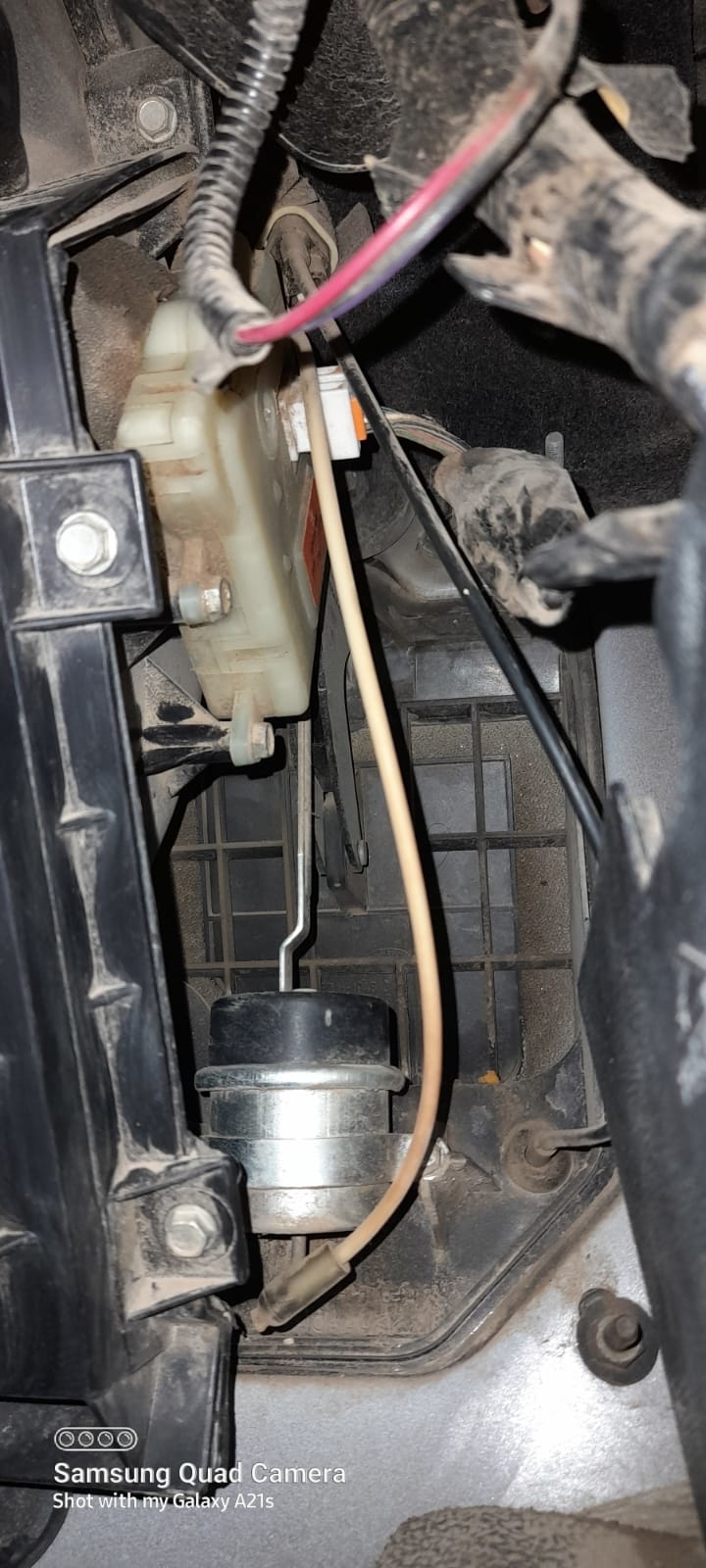

That's nice of you Mr. Kenny, to but you in picture i post photos of the car and under passenger seat which I think you mean this what square plastic if it is the one can i get the part number the third picture is this loose black comes from A/C. i seen it today where exactly should be placed.

It is hard to orient myself but that white/tan square plastic piece appears to be the blend door actuator. The air inlet door is going to be vacuum controlled which will be a vacuum actuator like the one I am pointing too.
Try and move the fresh air control to recirculate and see if this actuator moves.
If it doesn't then try manually moving the actuator and see if the issue still happens.

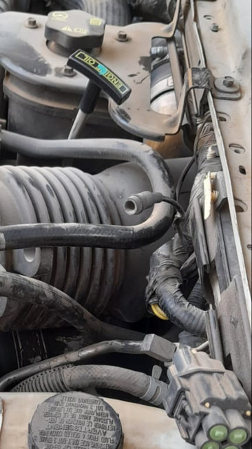

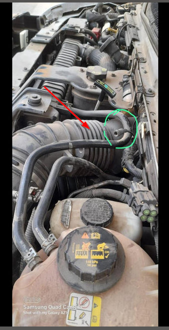

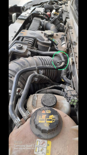

I found this under the hood i wonder where it should be placed.
Jun 5, 2022 at 5:20 AM
That looks like the breather hose that connects to the intake tube.
The hose should be in about the location that it plugs into.
So, feel around the hose that I am pointing too and see if you can find a hole.
Jun 5, 2022 at 9:24 AM
