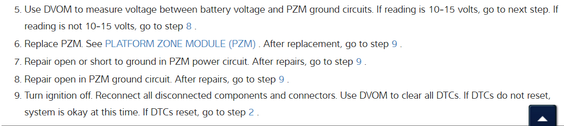

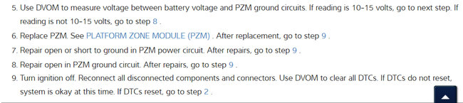

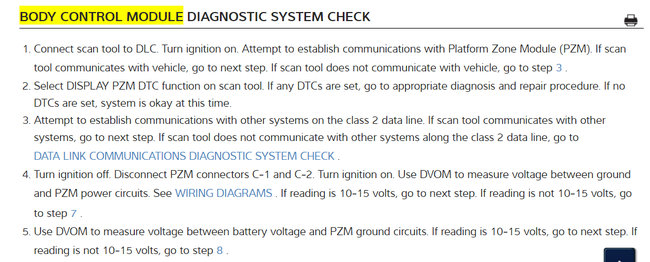

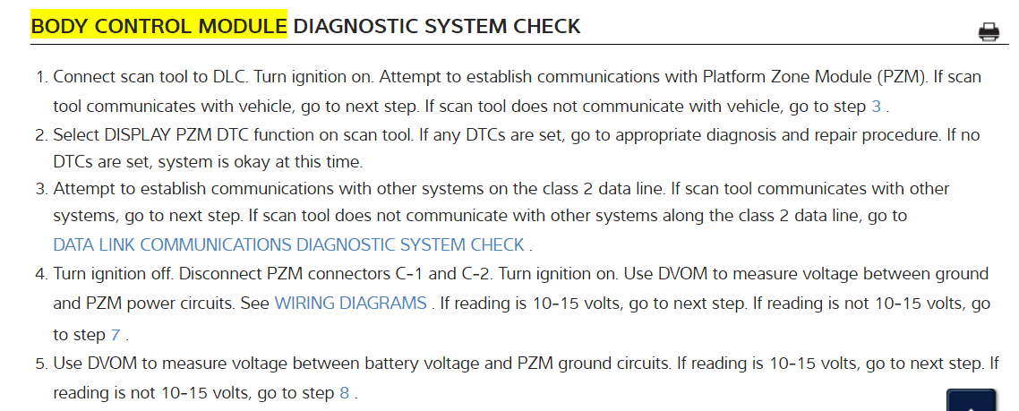

This could be a problem with your vehicle's Platform Zone Module (PZM) which is what Cadillac calls this model's Body Control Module (BCM). In the diagrams down below I have included the factory diagnostic troubleshooting guide for the TZM, but you will need a scan tool with the ability to communicate with the TZM to do these tests. Please go through this guide and get back to us with what you are able to find out.
