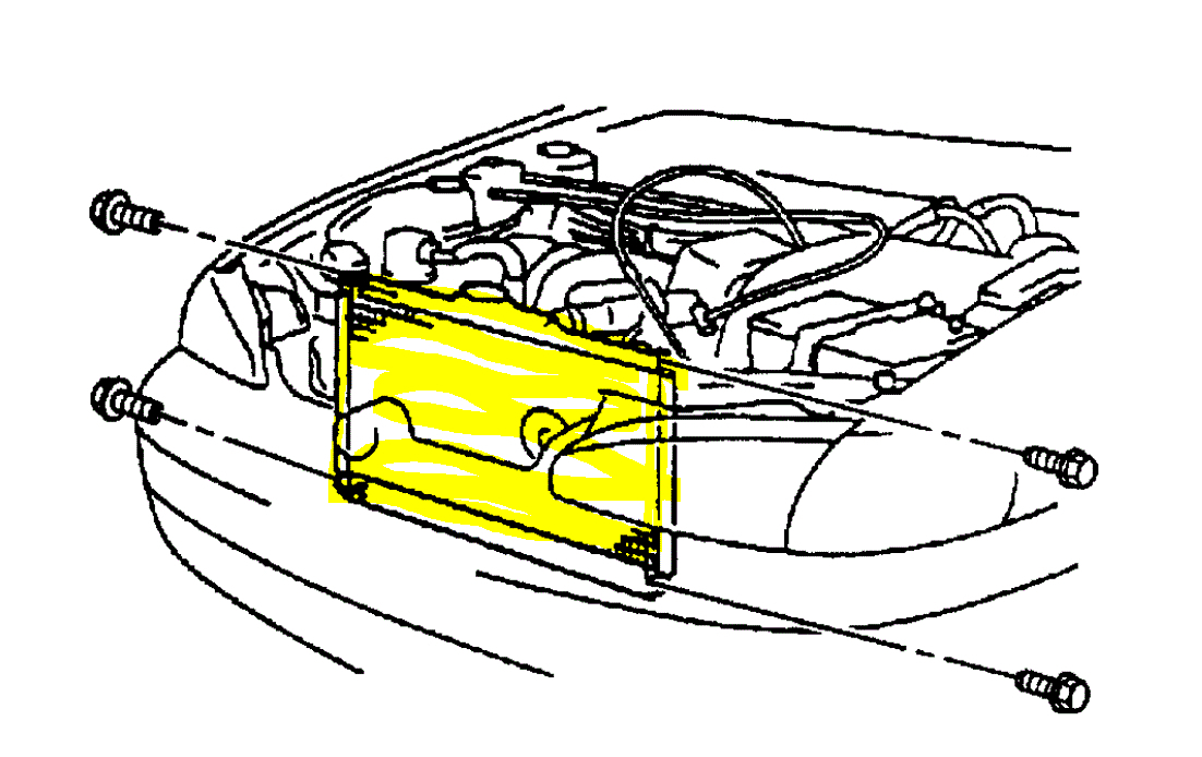

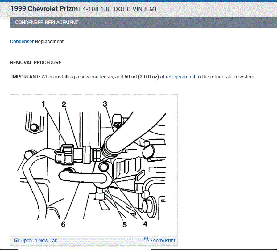

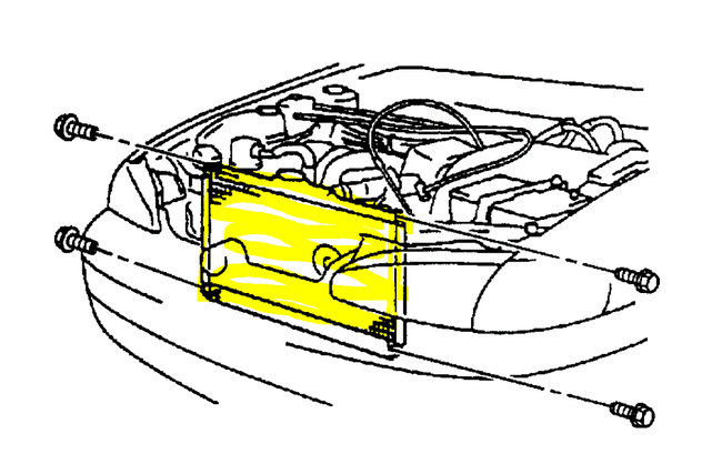

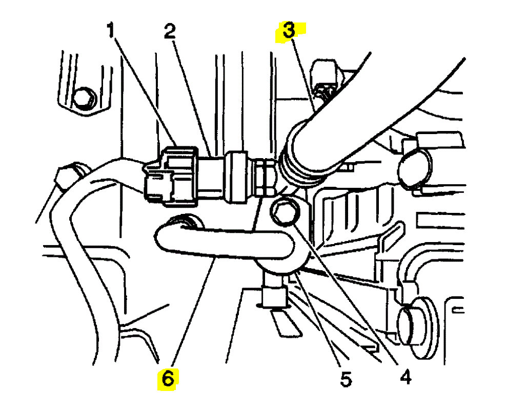

The condenser sits in front of the radiator. It actually looks like another radiator. There are two lines that attach to it, a compressor discharge hose (6) and liquid line (3) in pic 2 below. If I had to guess, I would think the discharge hose is the one leaking. There is an o-ring where it connects.
The easiest thing to do would be to get a freon with a dye in it so you can trace where the leak starts.
Let me know what I can do to help.
See pics below. Pic 1 is the condenser and pic 2 shows the connections.

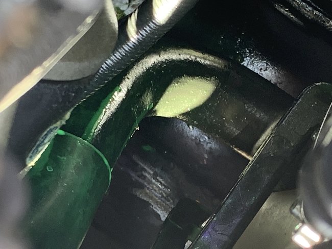

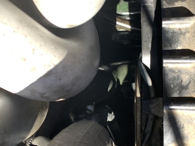

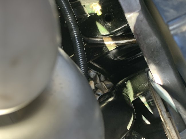

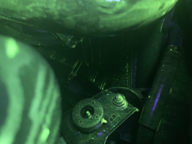

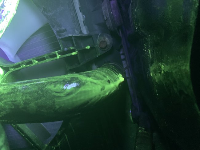

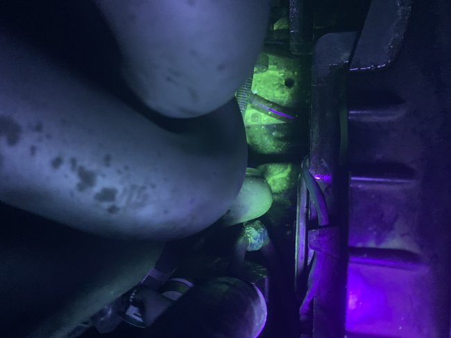

Here’s some more pictures.
Apr 10, 2022 at 5:17 PM
ZHILL93
  • 20 POSTS

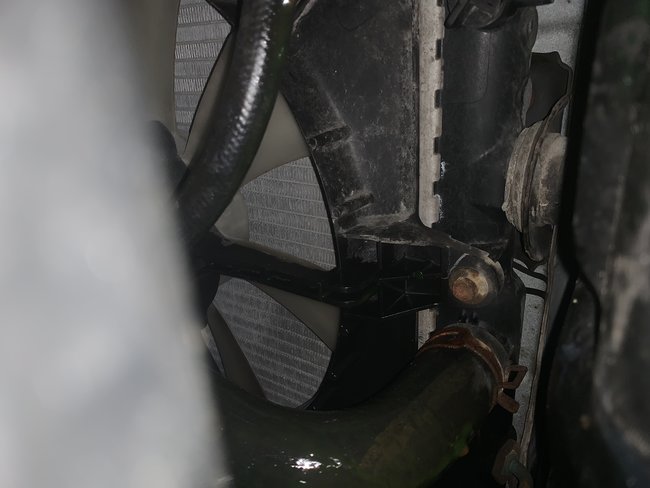

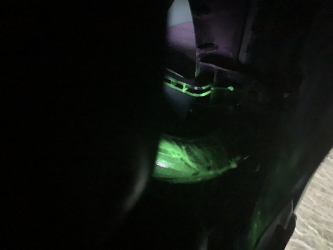

These pictures at a little better.
Apr 10, 2022 at 5:46 PM
I looked through all pics. I am seeing wet areas facing the cooling fan shroud, the hoses, and everywhere. Since it is hitting the side of the fan shroud that faces the engine, check the original hoses I suggested. This is a large leak. You should be able to see on a hose if there is damage.
If the hoses or the connections are not suspect, then we need to pull the radiator back and see if it is coming from the condenser.
Apr 10, 2022 at 7:47 PM

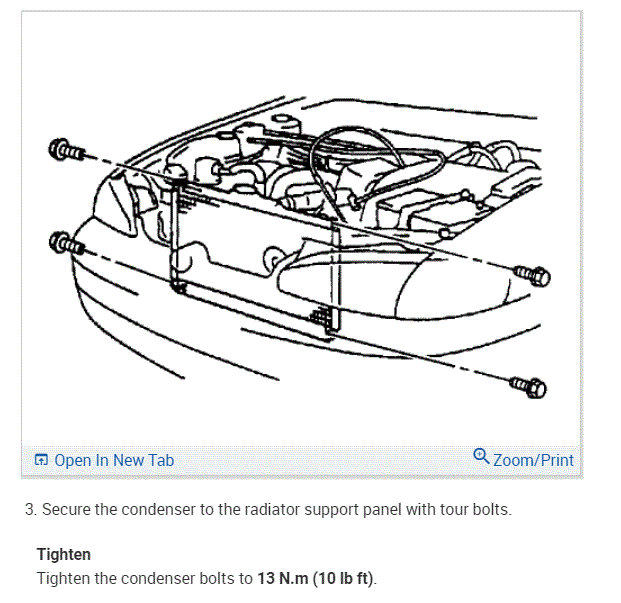

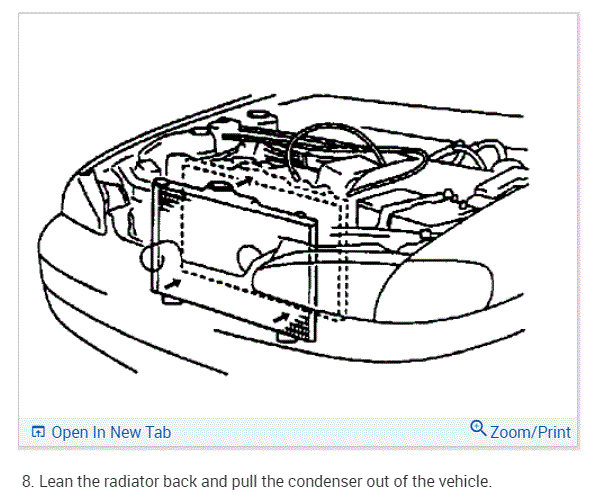

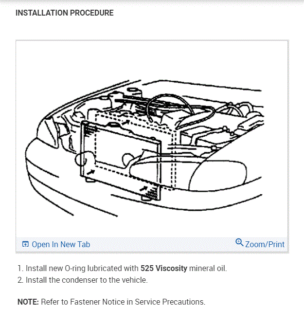

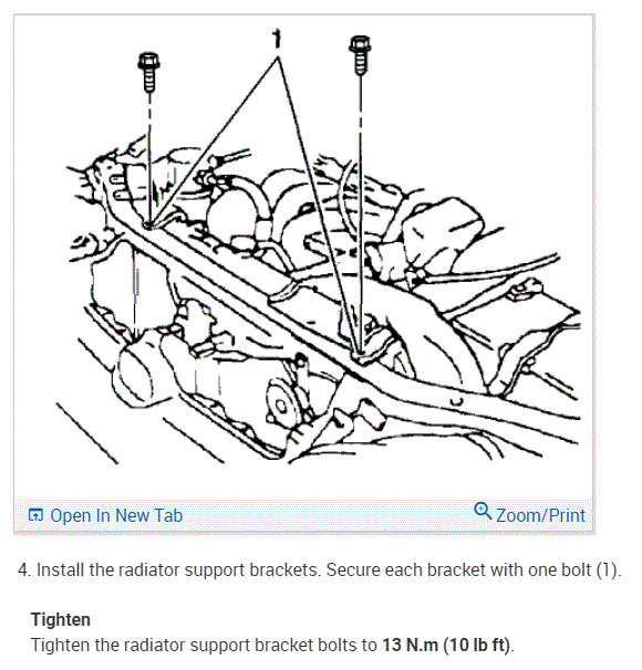

Yes, it should be fine. It shouldn't turn on even if you try because the low-pressure switch will prevent it. It would be a good idea that before adding peg oil and recharging it, you vacuum the system down and then recharge it because it was open.

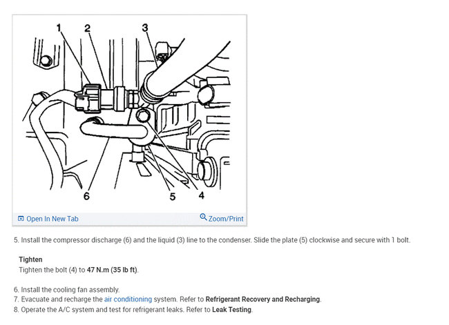

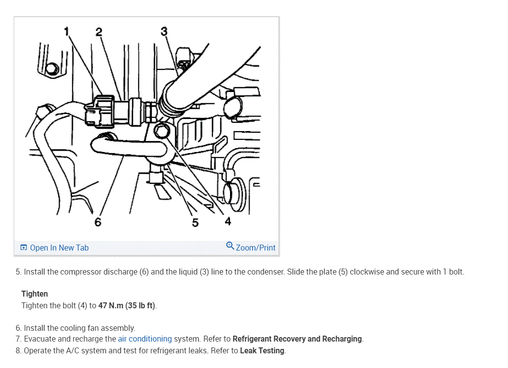

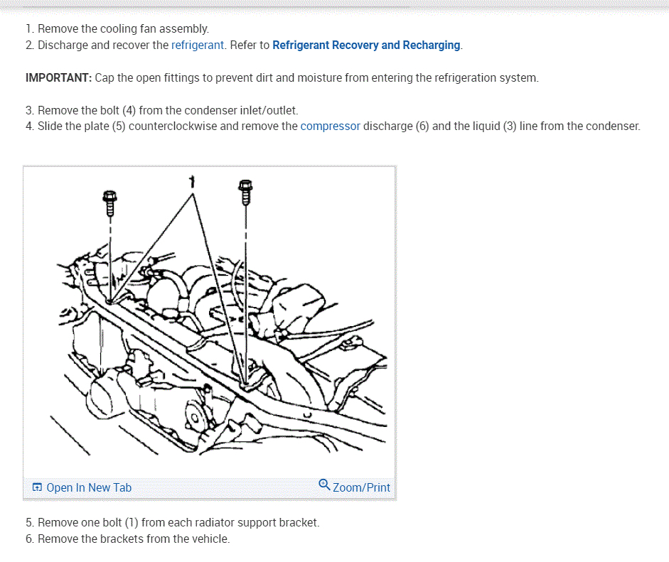

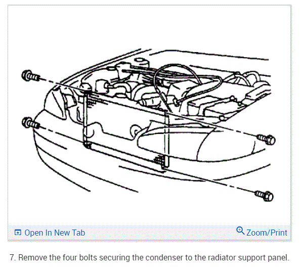

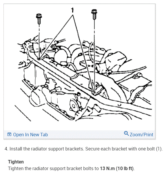

If you have confirmed it is the condenser, I attached the directions specific to this vehicle for replacing the condenser. See pics below. Let me know if you have additional questions or if I can help in any way.
See pics below.

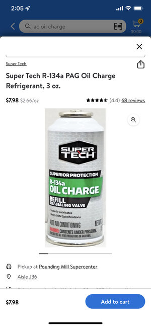

Okay, let me know if there is anything I can do to help once you get it. Note there will be o-rings when disconnecting and reconnecting the lines. Make sure to lubricate them before you put it together. Additionally, note the need to add oil in the directions above.
Apr 13, 2022 at 6:05 PM
ZHILL93
  • 20 POSTS
Can I just add this to the low side charging port for the condenser?
Apr 15, 2022 at 11:07 AM
That should be fine. It will work its way throughout the system.
