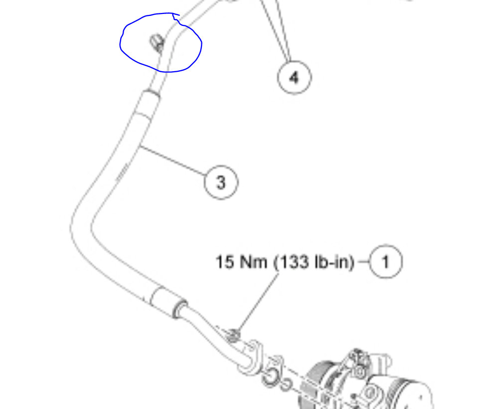

Good afternoon,
I attached a picture of the line that has the fitting.
https://www.2carpros.com/articles/car-air-conditioner-not-working-or-is-weak
Look under the car passenger side. It is inside the fender well.

Here I have the port circled. Do you know where the other port is by chance ?
Jun 14, 2021 at 8:44 AM
Okay, I attached the location of the high side service port for you. It is right at the line where the evaporator is bolted to the manifold line assembly.
