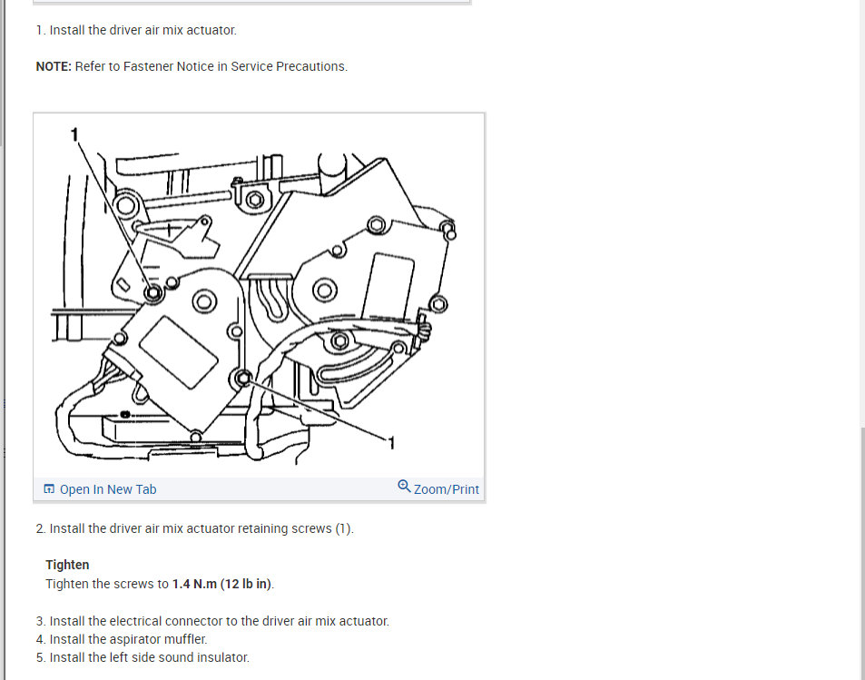

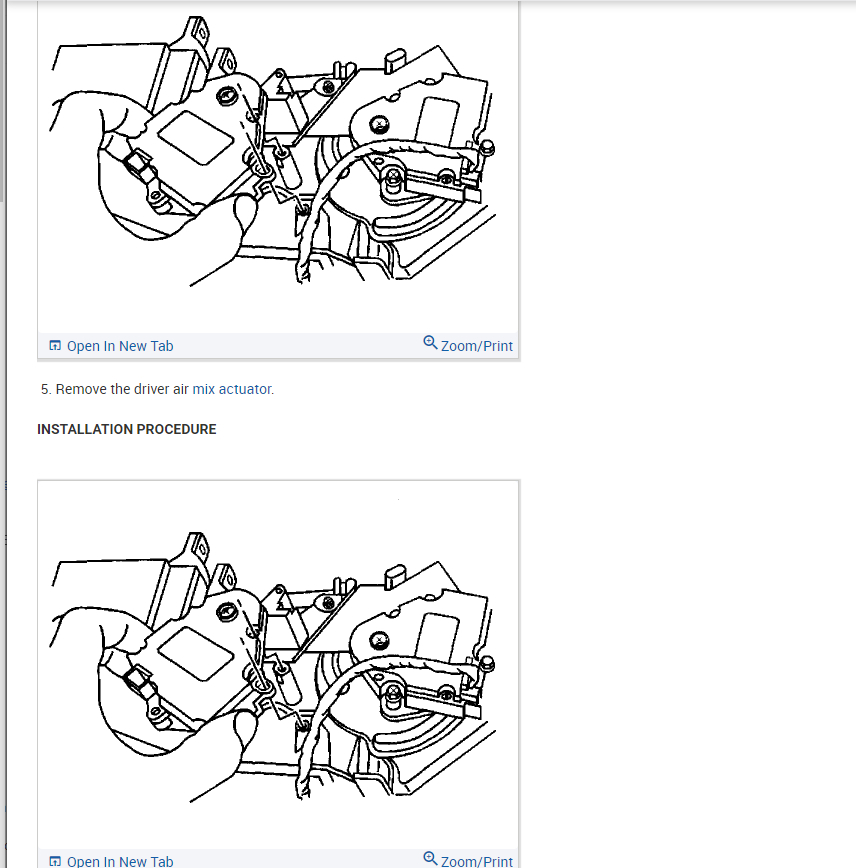

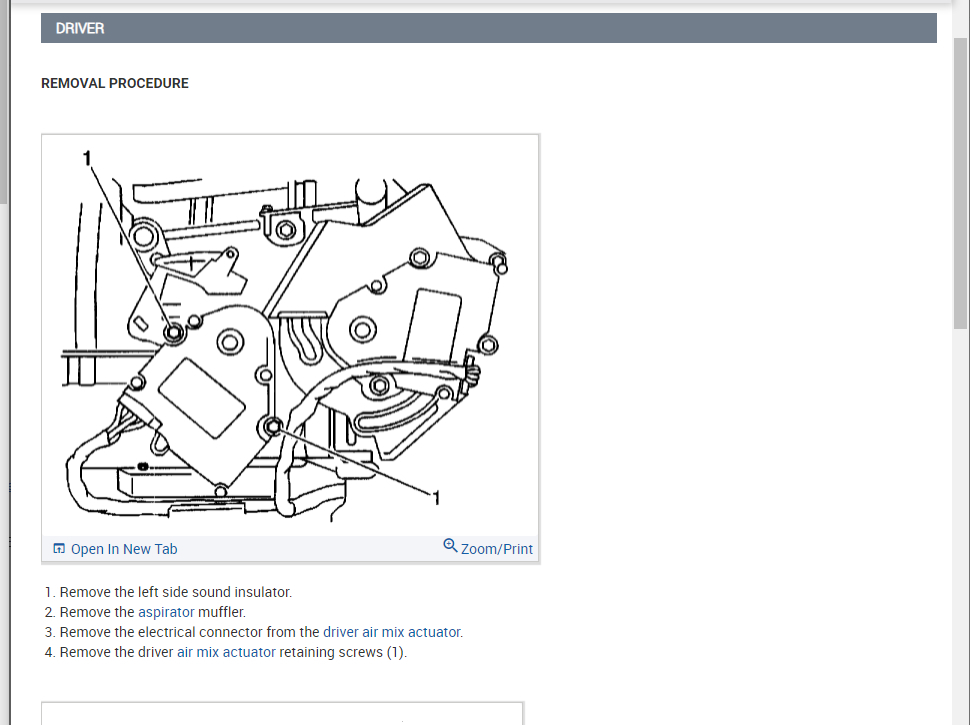

This is more than likely the blend door actuator on the driver side. Here is a guide that will help with this replacement:
Below you will find the process from the manual that will help with replacing this. I would also suggest checking the pressures just to be sure as a weak charge could cause this issue. However, it is more likely to be a blend door issue since you have dual zone temperature controls.
Please run through this material and let us know what questions you have. Thanks
