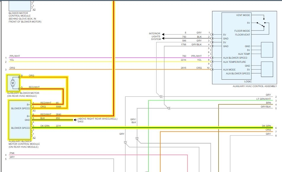

Can you do some testing for the rear blower with a test light or voltmeter?
I attached a wiring diagram for you to view.

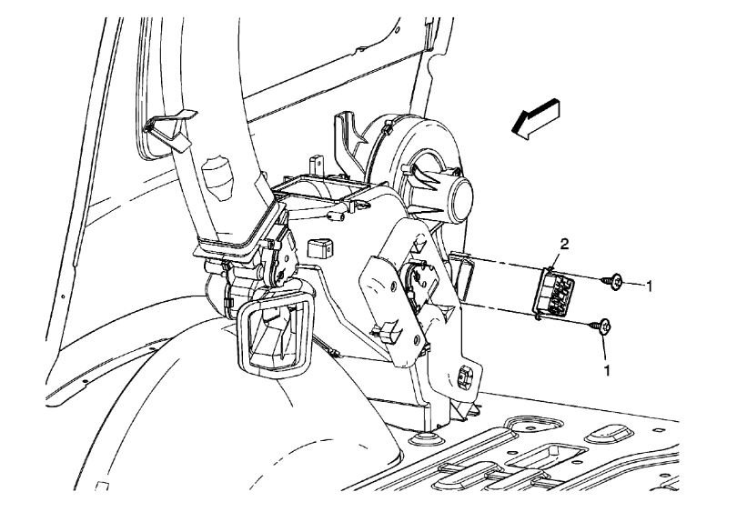

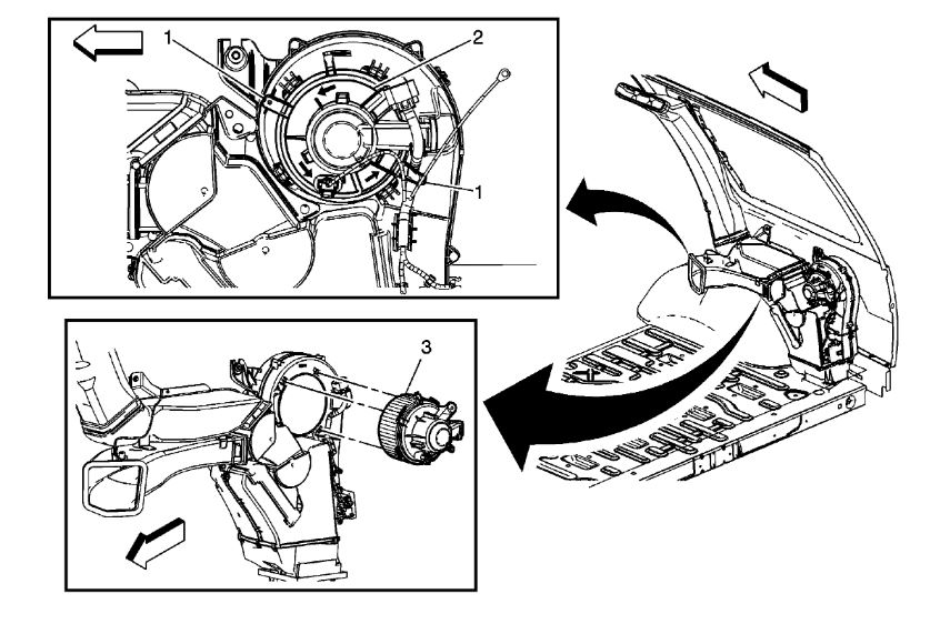

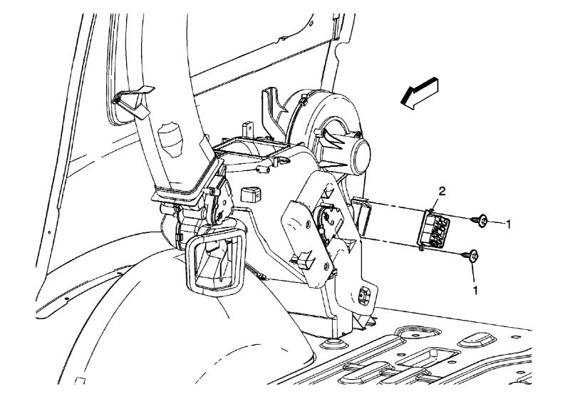

And the blower motor is in right rear of car???
Dec 22, 2019 at 1:45 PM
Correct. I sent pictures of the location for you.
