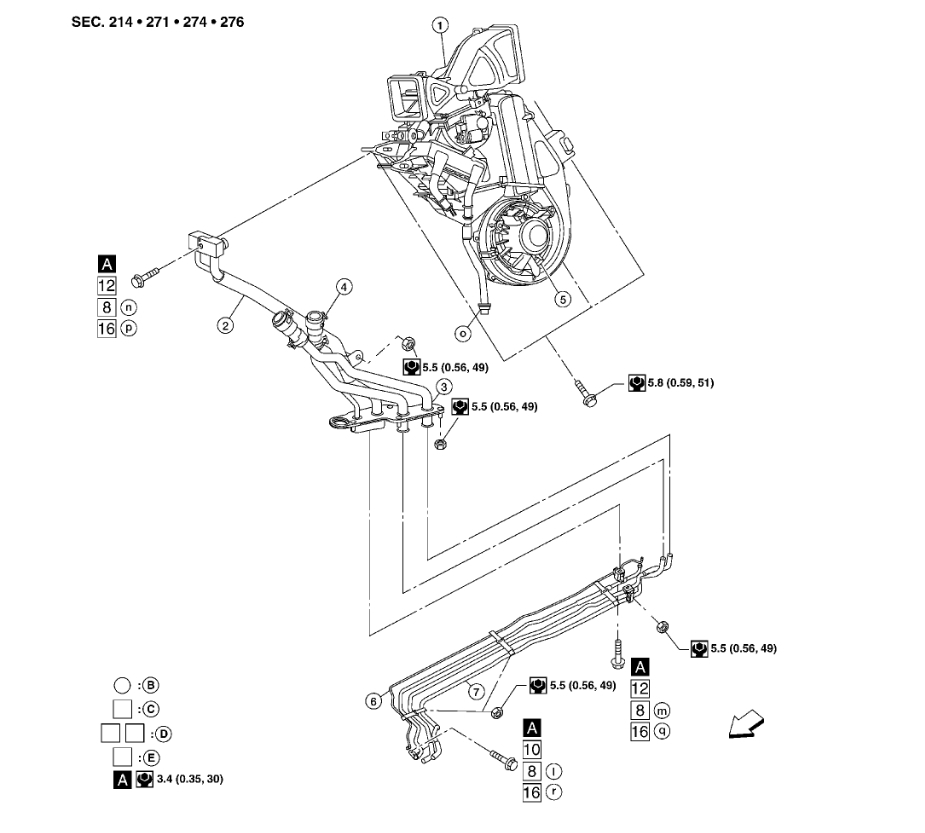

Is sounds like the rear blower motor is going out or something is stuck inside the fan or in the inlet. Can you please shoot a quick video with your phone so we can hear the noise? that would be great. You can upload it here with your response. Here is a diagram of the rear AC system so you can see how it works. I would start by removing the blower motor.
REAR BLOWER MOTOR
Removal
1. Remove the rear heater and cooling unit assembly. See: Housing Assembly HVAC > Removal and Replacement > Removal And Installation.
2. Disconnect the rear blower motor electrical connector.
3. Remove the three screws and remove the rear blower motor.
4. Remove the blower motor wheel as necessary to transfer to the new blower motor.
Installation is in the reverse order of removal.
