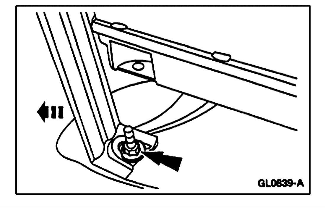

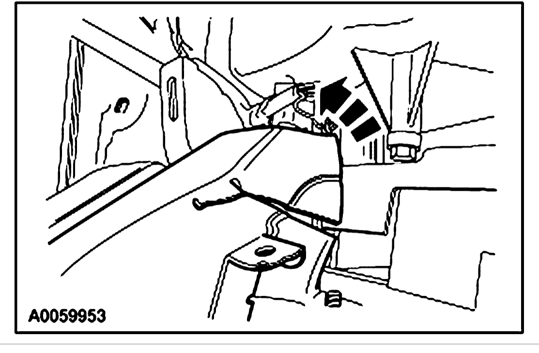

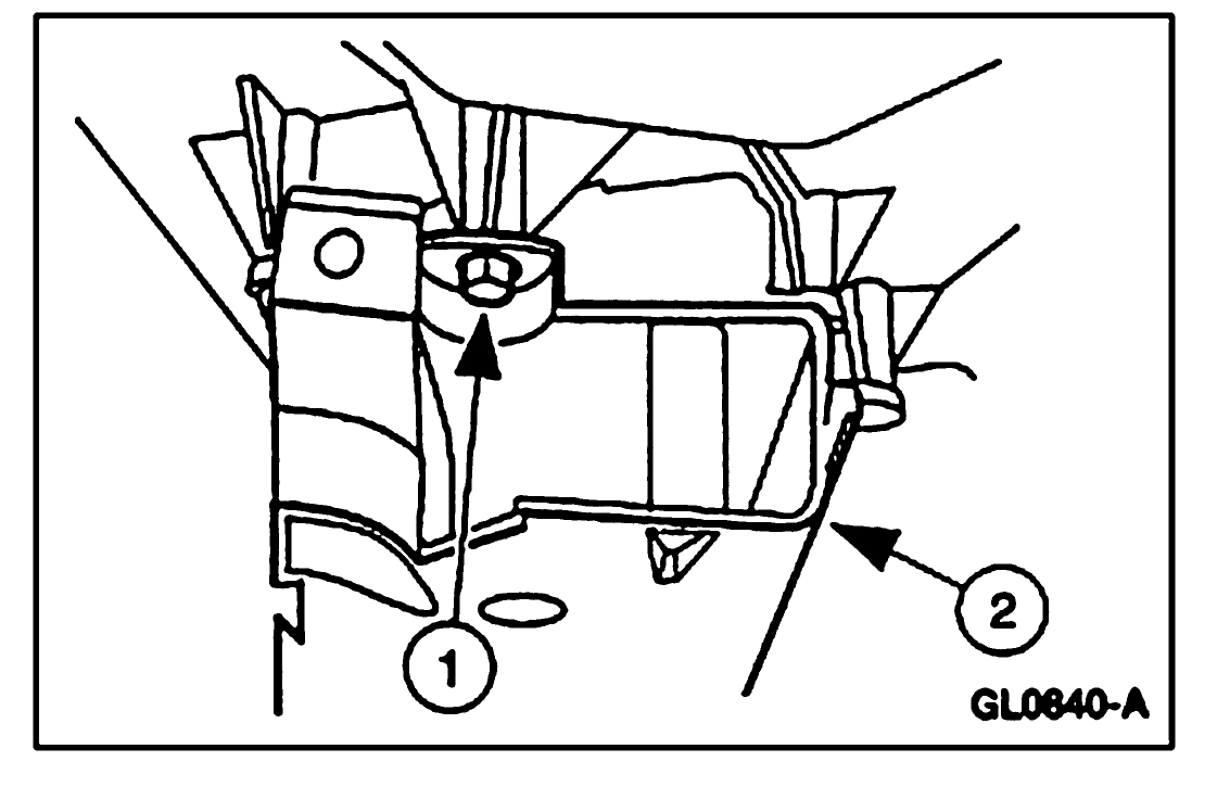

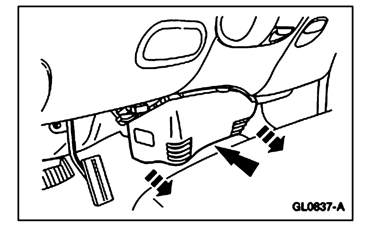

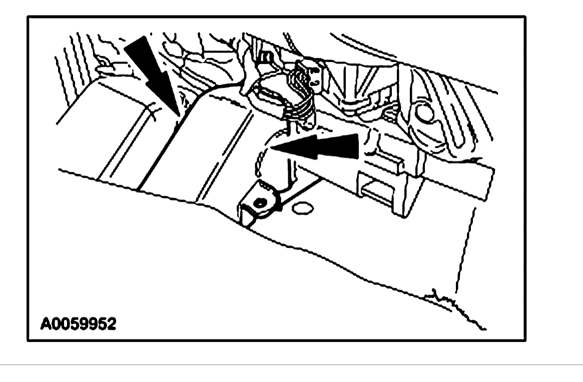

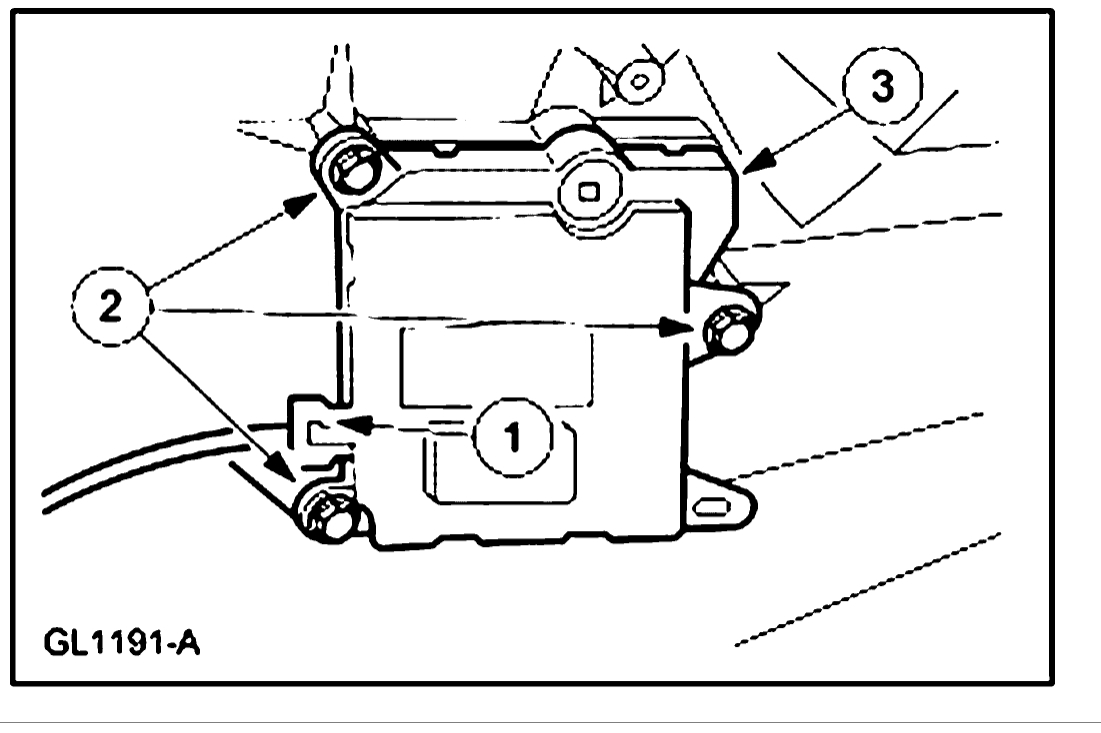

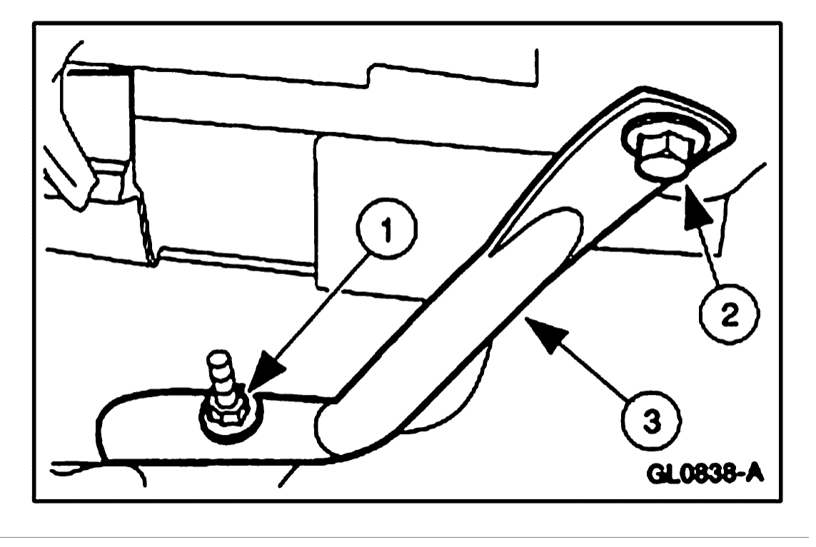

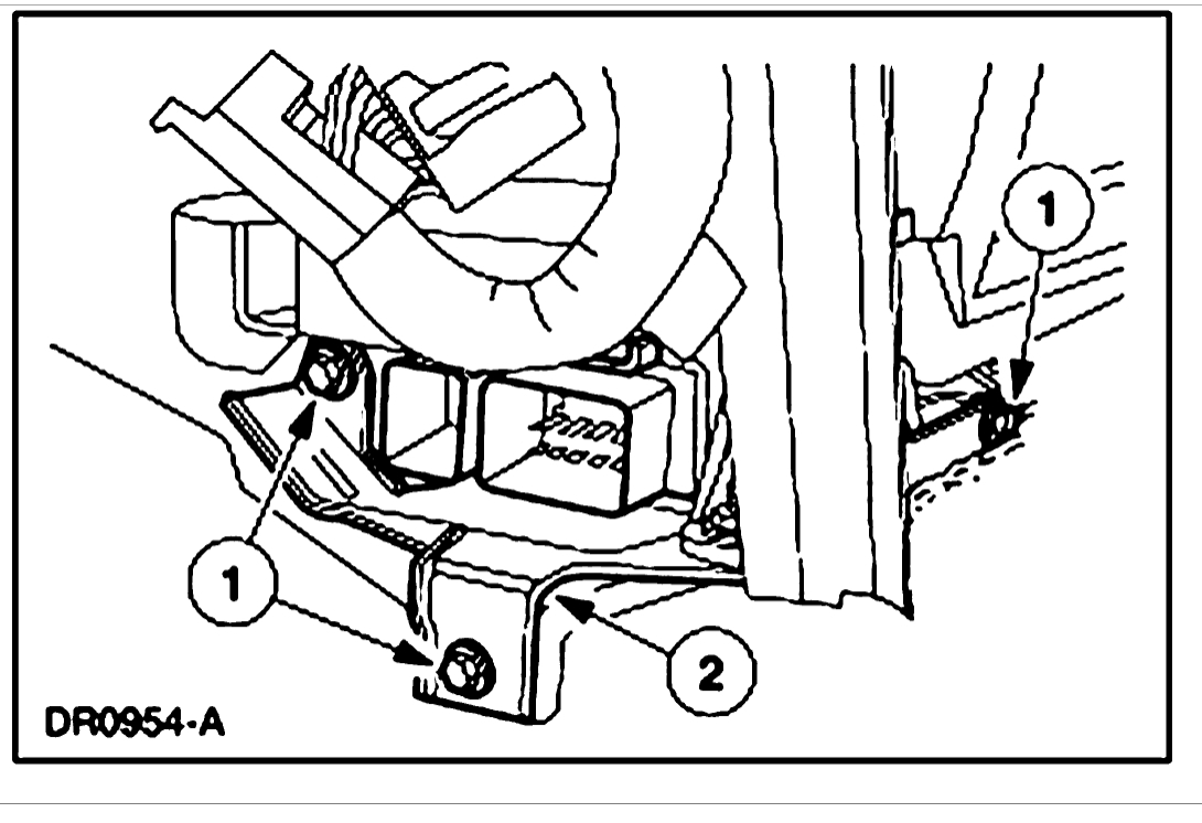

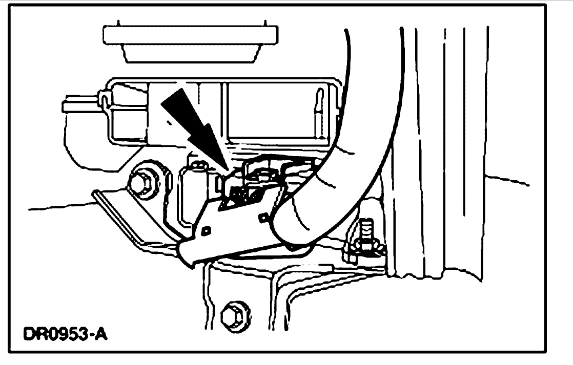

It sounds like you have a temperature blend door actuator that is out which is a common problem with these cars.
Here is a guide to help you see what you are in for when doing the job:
Here is what it will be like on your car (below:
Please let us know what happens and upload pictures or videos of the problem.

It was the temperature blend door actuator that was out thank you.
