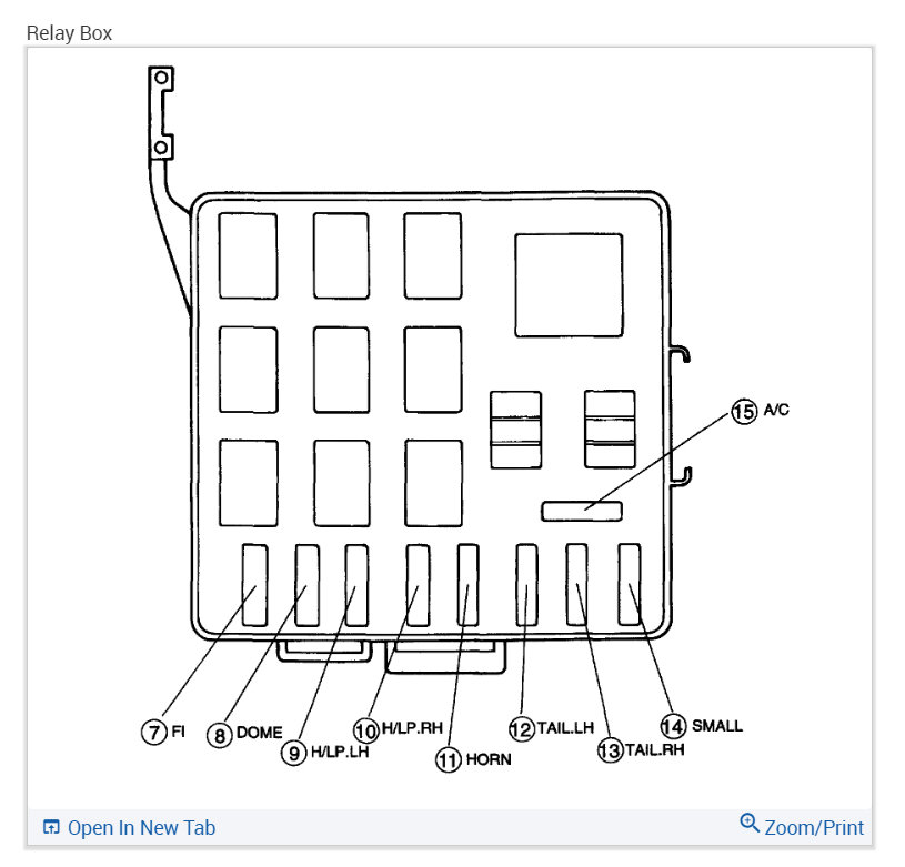

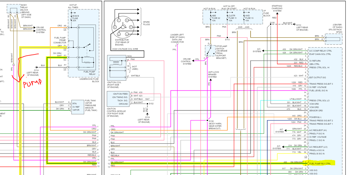

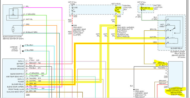

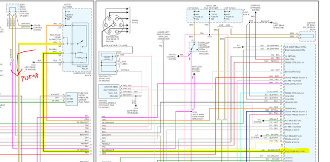

So, I attached a pic below showing the power flow. My first suspect is that a ground for the primary side of the relay was left disconnected when the engine was changed. It is mounted to the left side of the engine.
If you look at the relay itself, it will have pin numbers. The primary side is 85 and 86. One will have power with the key on and the other is a constant ground. With the key off, check if one of the two connectors in the box has continuity to ground. If it does, then check the opposite pin (85 or 86) for power with the key on.

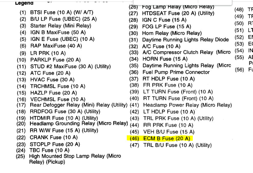

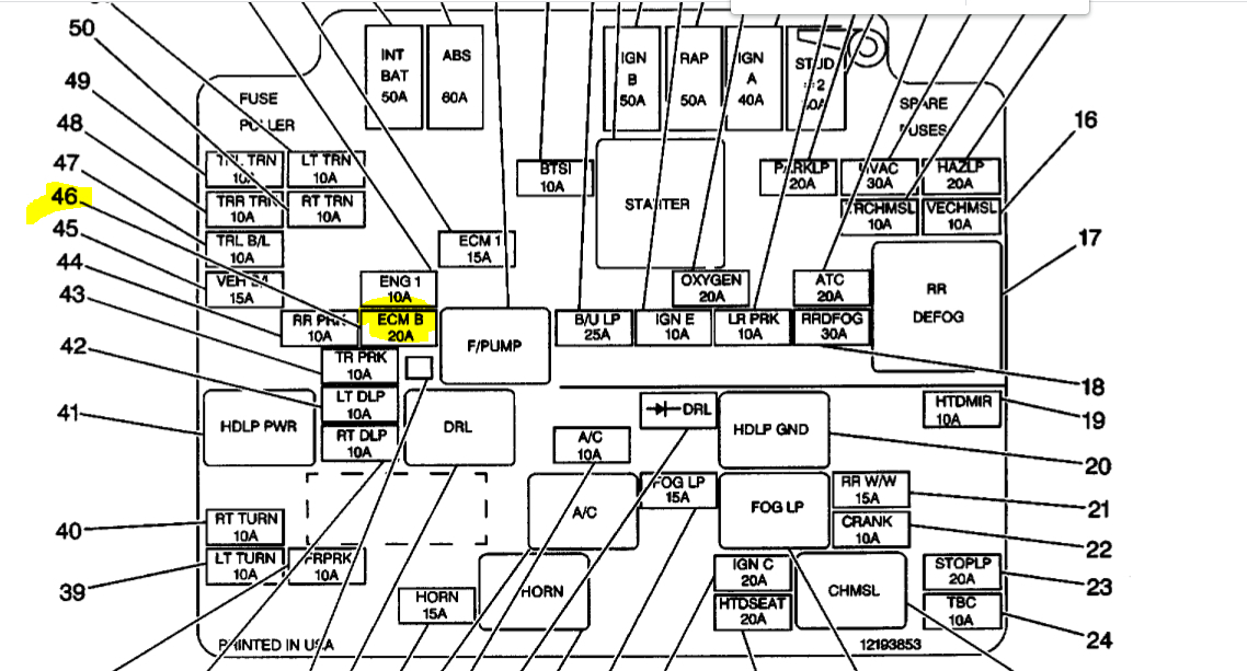

If that is good, then we need to check the secondary side. The ECM B fuse in the under-hood fuse box supplies power to the relay. Check the fuse first. If it is good, confirm there is power to and from it.
If it is good, remove the relay. With the relay removed, either pin 87 or 30 should have power at all times, regardless of the key position.
If it does, then we need to check for power out via the opposite pin (30 or 87).
Let me know what you find or if you have questions.

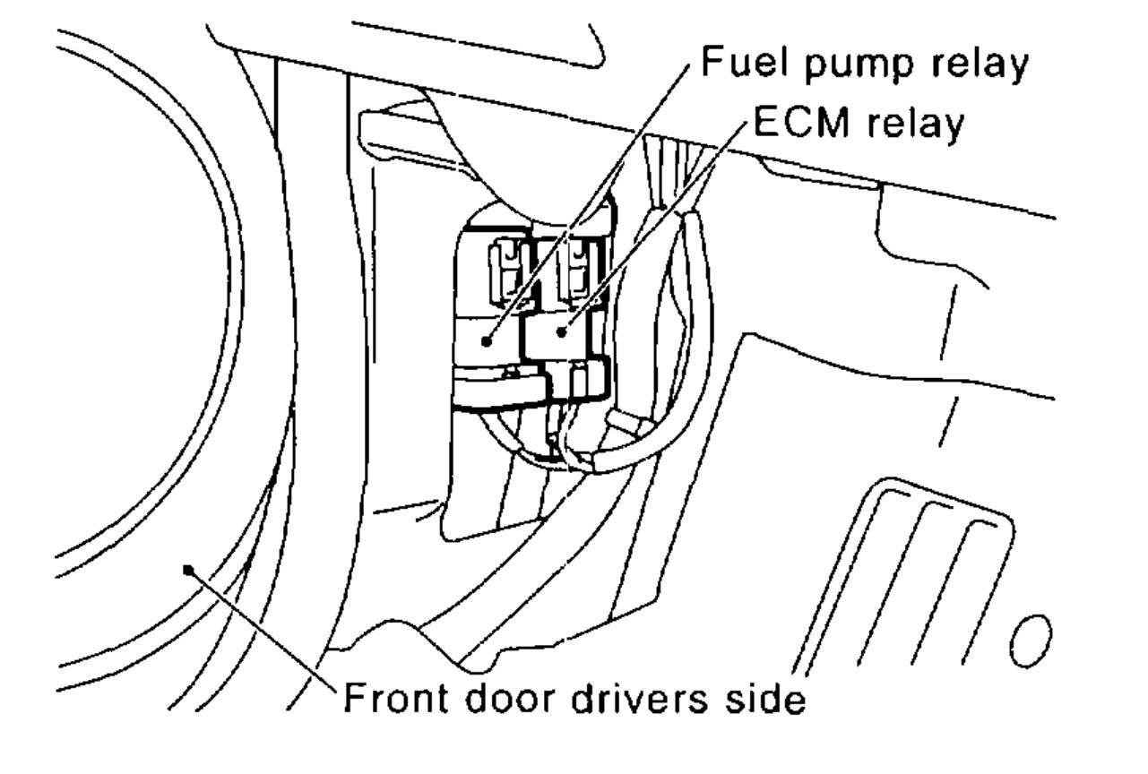

See pics below. Note: The ECM B fuse is right next to the fuel pump relay. See pics 2 and 3.
