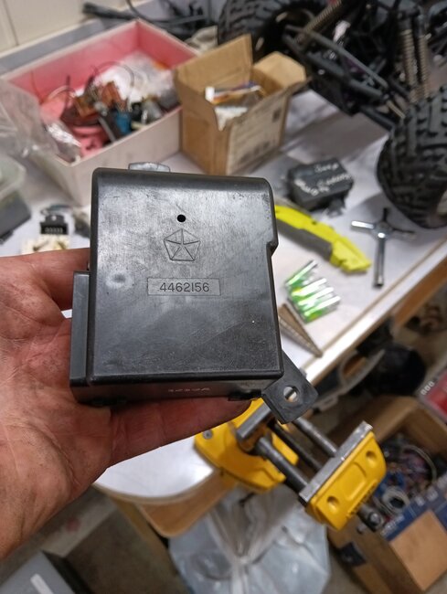

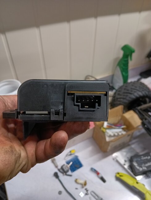

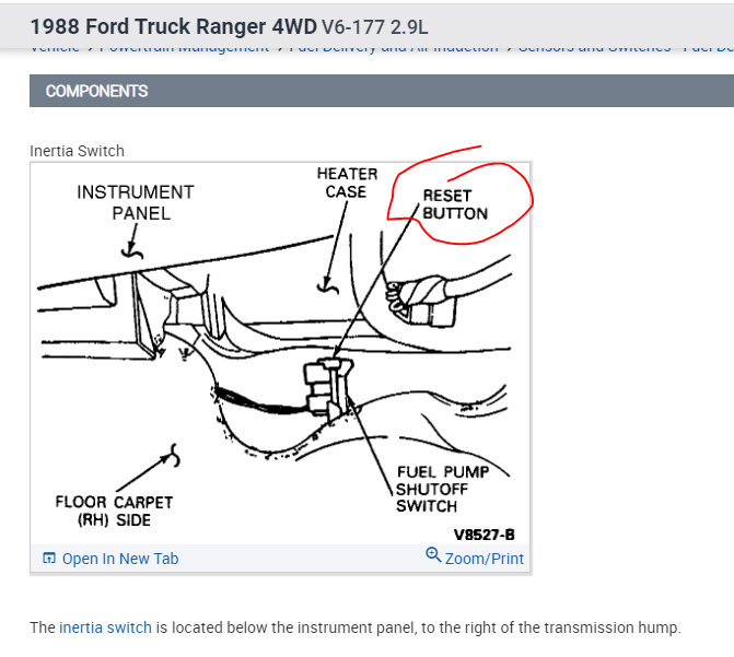

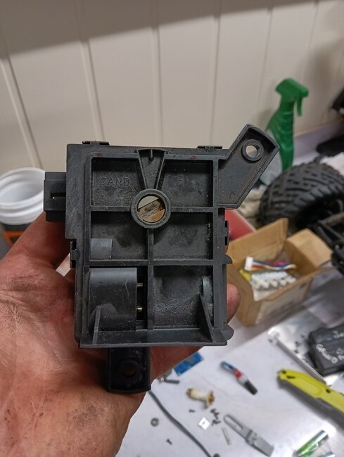

Next, have you tried resetting the inertia switch? If you haven't, I would try that next. The inertia switch is used to cut the fuel pump's power in the event of an accident. (See pic below)
Let me know what you find. There are a few other things to check, but I don't want to drive you crazy all at once. LOL
See pic below.
