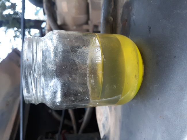

I run a Spectre glass-bodied inline filter before the pump to take out coarse dirt that passes the pickup sock, and I have a stock three-port filter before the BBD. Week before last, it started acting like it was running out of gas, so I hopped out on the side of the road, changed the filter out (rust), and was on my way in less than 5 minutes.
Last week Monday, it did it again, so I changed the inline filter again (more rust, but not bad, not so bad that I'd think it would act like this). Tuesday was okay, but that night I almost didn't make it home- 45mph max, cresting hills at 25-30mph. Wednesday, I had no time to work on it; Thursday I rebuilt the carb, no luck. Friday, I dropped the tank, replaced all 11' of steel feed line from the tank to the pump, all new rubber on top of the tank, and new filters.

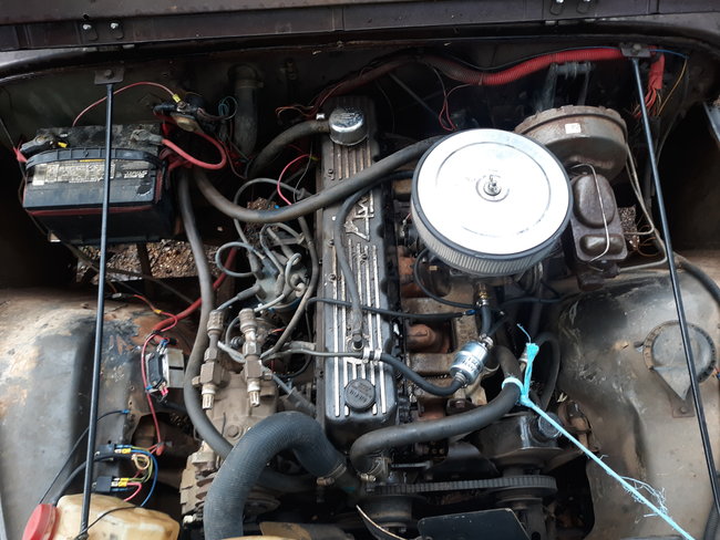

Pics tomorrow if it's not raining. Not much to see, looks like a stock 258 with a lot of stock vac pulled out, but it's worked great up until just recently, apart from being old and weak like its owner.

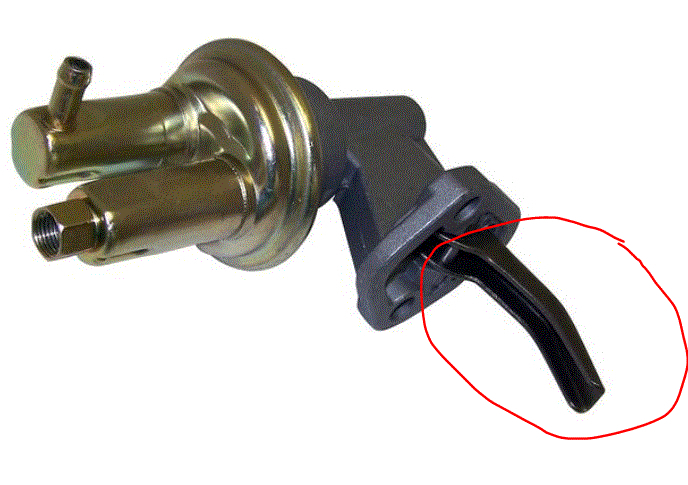

If you have replaced everything, including the pump which made it worse, you may have a bad eccentric on the camshaft. That would cause the fuel pump to not produce the amount of fuel needed. Since it got worse with the new pump, something may not have been installed correctly causing more damage to the eccentric.
Do me a favor. Cut the bottom off the bad pump so you can see the pump arm working. Install that pump and crank the engine. See if the arm is moving. Or you can check to see if it is producing enough volume. I attached the specs for testing both pressure and volume. See pic 1

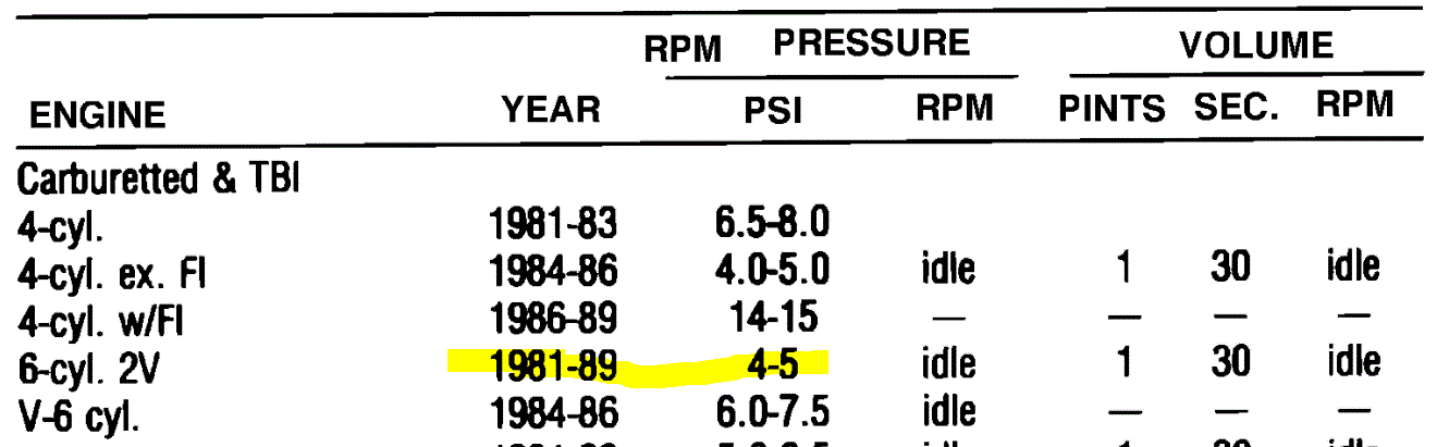

Pic 2 shows the lever that rides on the eccentric. If possible, inspect it and using a mechanics mirror, try to look into the engine to see if there is evidence of damage.

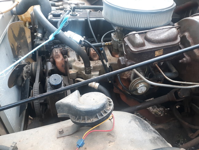

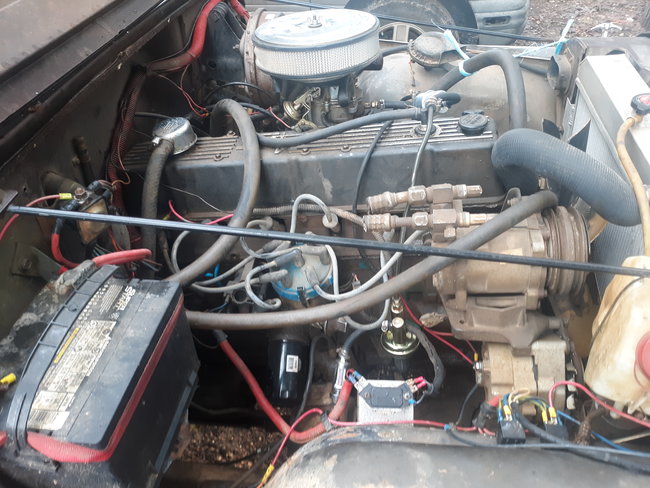

See pics below.

Started working on the Jeep before I saw your reply. I installed the new fuel pickup and sock into the tank and started the Jeep. I took it for a test drive, and maybe made it three miles before it started faltering on me. I turned around and headed home, using lower gears, and coasting a lot. It stalled three times on the road up to my house.
When I popped the hood, the engine seemed unusually warm for such a short trip. The upper radiator hose was turgid and hot, and the radiator was hot to the touch. Carefully bleeding off pressure, I found the upper radiator hose and top tank full of nothing but air. I had plenty of fluid over the top of the radiator tubes, so I don't know why there was so much air pressure in the system. Thinking I actually did have vapor lock, I replaced the steel line that came out of the fuel pump to the filter with a full length of rubber line.
I did note while idling the engine that the fan did not seem to keep speed with the belt. It may just be because everything was hot, but the fan clutch was essentially useless. At one point, I was able to completely stall the fan with a rag, and it took a while to come up to speed. Now that it has cooled down, it seems to react like it should, so I don't know what to make of that.

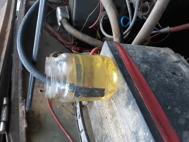

I disconnected the fuel line and draped it down into a gallon jug, then started the engine and let it run for about 10 seconds. I got maybe a cup of gas. I don't know if that's enough or not.
Then I took the fuel pump off as you suggested, and it was indeed on the correct side of the cam lobe. It would have had to be, otherwise I would not have even gotten as far as I did. I manually actuated the lever arm twenty times and got twice as much gas or more than it did when the engine was running it. I did not get a chance to look inside the boar to see the lobe of the cam, because I had to get ready for work.

My apologies, I don't know why those images loaded sideways, I took them correctly.

Pics for Medic.

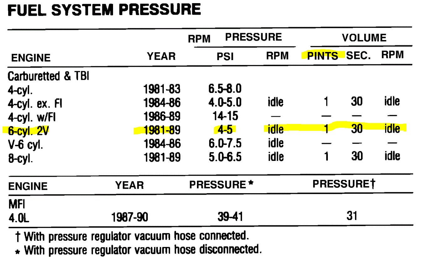

If you were able to get more fuel pumping it 20 by hand than allowing it to run for 10 seconds, it sounds like the eccentric is bad. In 10 seconds, think about how many times the camshaft spun. It was a lot more than 20 times.
If you got a cup, that is equal to 1/2 pint, which is half of what it requires.
Like you, I really question if the return line is the issue. If I recall, the return is nothing more than an extra nipple on the fuel filter which returns fuel to the fuel sending unit. If your vehicle is still set up that way, disconnect it at the filter and run a hose into a container. See if a lot of fuel comes out. I suspect there will be little to none.

I ran the calculations, and I figured the cam turned almost 60 times in the 10 seconds I let it run (700RPM/60s=11.67RPS(crank)/2=5.83RPS(cam)*10s=58.3 revolutions). Given that I got more gas out of a third of the movements leads me to believe the lobe on the cam is short-stroking the fuel pump, causing my running-out-of-gas issue. Also, if the pump is so detrimented, it may also be providing a significantly lower pressure, most of which is probably getting lost through the return port. I wonder if I can boost it by blocking off the return line?

Sounds like a plan. Nick, you may want to consider replacing it with an electric pump. The pressure for this vehicle is very low. Actually, the manual indicates 4 to 5 psi. (See pic below) That's hard to believe. LOL You could likely get a pump for under $20.00. It's just a thought.
