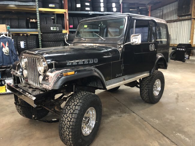

I just bought the vehicle listed above Laredo four speed transmission. It went straight to the shop for a four inch lift and wheel package. I try to drive it out and there is no power. It will not move. It starts up and idles fine but will not drive. I go to put it in 4 Lo, and it moves slightly. Any help greatly appreciated.
