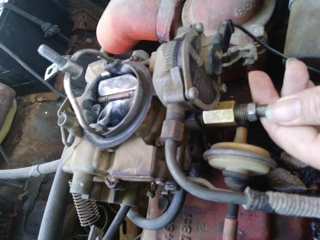

Okay. so, I pulled some plugs from the rear cylinder, and they looked a bit white like they were running way too lean. And it doesn't really smooth out when I hold my hand over the carburetor. So, what I did yesterday was pull the carburetor and I noticed the fuel filter has that valve on it and apparently it had dried/shrank due to gas over time and was pretty much blocking the gas. so, what I did is temporarily modify it so it would let gas through, and I went to the carburetor, put it back on just seem to be running better. Readjusted my vacuum timing and idler screws. However, I still suspect that maybe my little modification didn't do the trick, so I ordered a new fuel filter with a new valve on it. Going to try that next. I will update you on that one. It definitely doesn't sound like it's missing as much when I listen to the exhaust. So, maybe we're dealing with the stupid thing as a fuel filter that looks new but had to dry it out gasket blocking fuel. I'll let you know.
