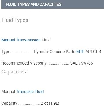

You are correct. The fluid that was installed is heaver than the manufacturer's recommendation, and that can be what is causing what is happening.
I would recommend taking it back and have them install the correct weight of oil. Please keep in mind, the manufacturer takes into consideration different temps when engineering the vehicle. They know best.

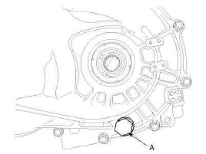

I attached a picture which indicates the recommended weight and capacity. Also, if you want to do it yourself, here are the directions. The remaining pictures correlate with these directions.

PROCEDURES
Service Adjustment Procedure
Transaxle Gear Oil Level
Replacement
1. With the vehicle parked on a level surface, remove the drain plug.
2. Drain the transaxle oil after loosening the drain plug(A).
picture 2
3. Install the drain plug with new washer.
Drain plug tightening torque:
60-80 Nm (600-800 kg-cm, 43-58 lb-ft)
4. Add new oil through the file plug hole and, fill it just below the plug opening.
Standard oil SAE 75W/85, API GL-4
Oil capacity:1.9 liter (2.0 US qt, 1.67 lmp qt)
______________________________
Let me know if you have other questions or need help.

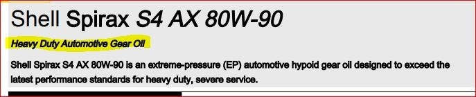

Found this at:
http://shop.sclubricants.com/shell-spirax-s4-ax-80w-90
Below at:
Detailed Product Description:
Shell Spirax S4 AX 80W-90 is a premium all-season, multigrade gear oil designed to exceed Original Equipment Manufacturers' lubrication requirements under today’s increased temperature and loads.
Also within:
Shell "Technical Data Sheet" link the same page below at:
"Download the TDS"
Or simply at:
http://shop.sclubricants.com/pub/media/pds/shell/Spirax-S4-AX-80W-90.pdf
Anyway, would this make any difference, many thanks.
May 6, 2019 at 5:14 PM
It says right on the document that this is for heavy duty application. Your gear box is not under heavy duty use. This is an industry term that is meant for heavy hauling like work trucks, police cars, mail carrier vehicles. These types of vehicles run all day and are run hard. Passenger cars do not fall under this category.
I would have it changed if for no other reason that it was not designed for it. Not to mention you are experiencing an issue after they did it.
May 6, 2019 at 5:25 PM
