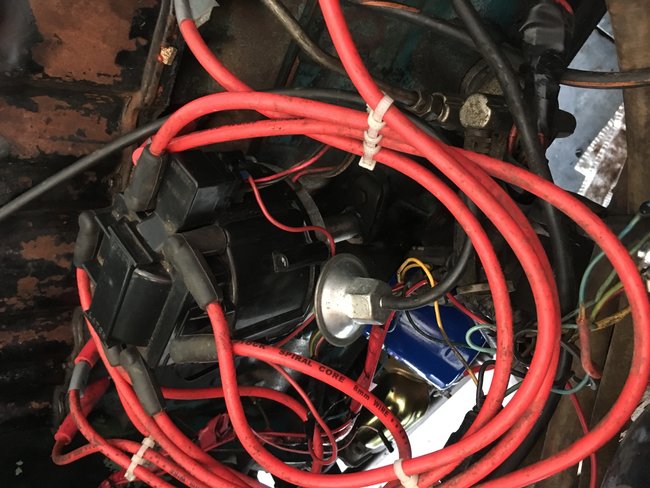

Hi, I have a problem similar to some others regarding a no start condition, but not seeing anything that fits my exact situation. I recently bought and have been working on the vehicle listed above. It ran fair, other than overheating and blowing white smoke after a couple of miles. I have replaced the starter, starter solenoid, head gasket, valve cover gasket, intake and exhaust gaskets. In the process I had to remove the plugs and HEI distributor the PO had installed to get the head off. Put distributor back in with some adjusting to get it to seat back down on the block (maybe a problem there?). Marked all plug wires to make sure they line up with the right plug. Since that time, I cannot get it to start. Tried to get to 5-7 BTDC, adjust the dist cap to point at the first plug, but will not really turn enough to get right there. Feels like I am going to snap off the distributor rotor if I try to force it more. It cranked until I burned the ignition coil up. Replaced that coil and it cranks well, but still no start. I tried to adjust the crankshaft to what I thought was 5-7 BTDC and tried to adjust the dist/rotor again. I have blasted the carburetor with carburetor cleaner, then later added starting fluid and a little fuel. Cranked several more times, then bang! (more like internal explosion, but not the normal, controlled kind..). Sad, but funny. Friend had head near the front of the the vehicle at the time (well, funny to me). Not sure what if any damage may have been done and really could use your assistance to get Lazlo running again. Thanks in advance for any assistance with this project! Chris in central FL.

Hey there again!
Key on, positive side of the coil, what is your voltage?

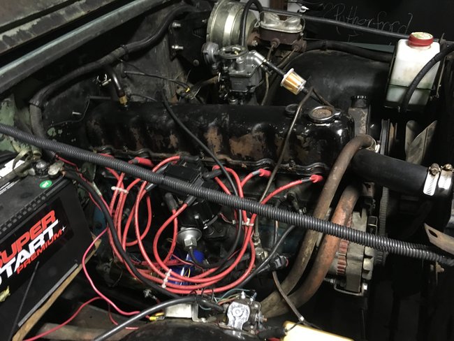

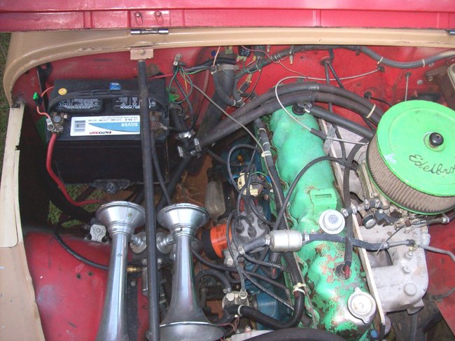

(I deal with stock stuff mainly, I have pictures to help)(I am just going to have to explain stuff better with that distributor!)
Has that distributor been removed?
Still using the one in the picture?
If it was removed, has it run at all since it was re-installed? (think you already answered that!)
This will aid you a bunch!

The 258 is a tough engine, Most of the time with backfires/ coughing/ sneezing/ and spitting the only things I see that may occur are vacuum lines/ vacuum caps sometimes get blown off of their nipple/ connection.
Measure/ mark the distributor's relation with the engine. So it can be put back if it were moved.
Let's try loosening the distributor hold down clamp enough where the distributor will move (but still be sorta tight).
Have you buddy crank it,
You move the distributor slightly either way (maybe in inch [per say] ) while it's cranking. Does it start? Will it run well enough to time it with a light?
NO GO???
Before we can attack another problem we have to be PERFECT where we are at now!
Might be a review, but we have to be certain TDC is TDC!
Unscrew #1 plug, leave it in, hanging on 2 threads or so.
INSURE THE KEY IS OFF! Out of gear.
Slowly rotate the engine clockwise (viewed from the front) with a wrench or ratchet. This could take up to two crankshaft revolutions (being a 4 stroke engine)
When you hear a HISS from #1 plug loose in it's hole (not other low hissing from the pistons), stop for a second! We are now starting on the compression stroke of #1
Look at the timing mark on the harmonic balancer- look at "0" on your timing cover.
You will continue around (which is gonna be less than 1/2 a stroke-maybe even way less!) Until the timing mark is on "0"
The engine is at TDC!
Now look to see if your rotor button is indeed facing the #1 tower (where #1 wire is).
If all is like this, we are in good shape with TDC.

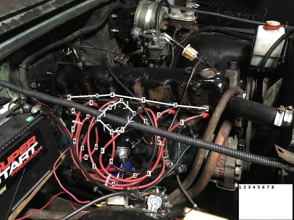

I took one of your pics and tried to see if you had the wire sequence correct.
It's hard to see some of 'em (your modified pic is below)
Sequence should be 1-5-3-6-2-4 clockwise on the cap (button pointing at #1)
Sorry!
Not saying you are dumb or nuthin'!
Just that so many times you spend forever with a Jeep down, running thru a million possibilities only to find out it was something in the beginning taken for granted/ 'specially when you are tired and not checking behind yourself.
Just wanna be absolutely sure at this point!
Nuthin' will work right if this ain't right!
Try what I suggested, recheck your work!
We will move on after you verify TDC is dead on!
Your turn,
The Medic

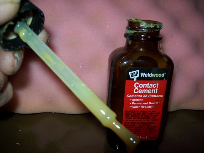

Let's back up on the valve cover gasket!
What's probably happening is that when you RTV both sides it is so slick that it sucks up under the cover when you tighten the bolts.
Walmart
Hardware section
Hid on bottom shelf at our store
Contact Cement
Clean all of the crap off of your valve cover.
Clean the head's surface too.
Coat the valve cover surface with Contact Cement
Insure your gasket is oriented right
Coat the top side of the gasket with contact cement
Let both dry separately for 15-20 minutes.
Stick 'em together.
Now the gasket is sealed to the cover, it should not move!
Now a light coat of RTV on the bottom of the gasket. Smear it out with your finger, it should only be a light film.
Install the valve cover, barely-barely-barely snug the bolts, the cover should touch all the way around.
Let it dry an hour or so.
Snug the bolts a bit more, like tight using your thumb and two fingers on top of a nut driver. Over-tightening is not a good thing.
Pic below
