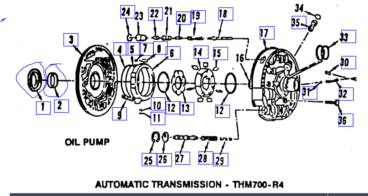

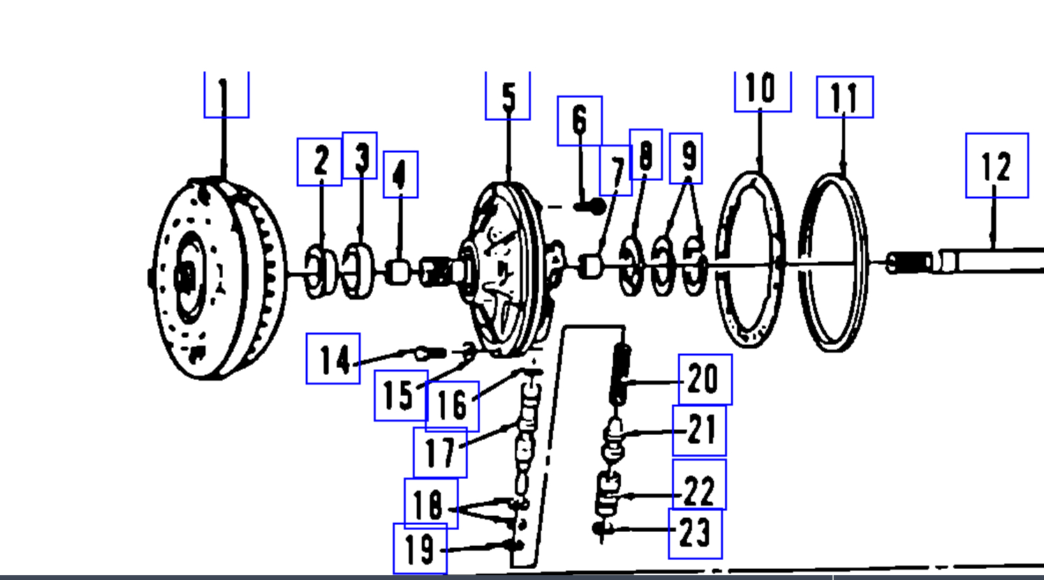

I attached a picture for you of the location of the bushing and the seal.
Number 2 is the seal and number 3 is the bushing.
The torque converter needs to be replaced as well. You can get a remanufactured unit for about $125.00.
The front pump will need to be split in half by removing the bolts. It will come apart so you can get out the bushing from the front half of the pump.
