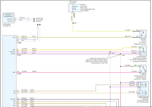

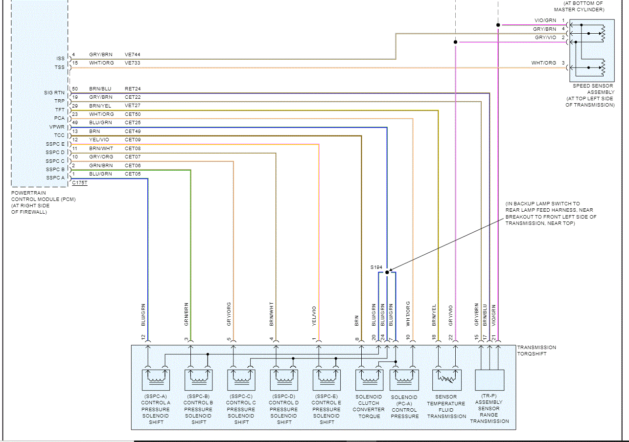

Would like a wiring diagram and/or pinout for the truck listed above with the 6.8l V10 and the 5r110w transmission.
Feb 28, 2022 at 10:17 AM
I attached two pics below of the circuit (wiring schematic). Let me know if this helps. Also, let me know what you are dealing with and hopefully, I'll be able to help.
Note: The two pics below came from one pic. I had to cut it in half to make it readable for you, but I did overlap them so you can follow from one to the next.
See pics below.
