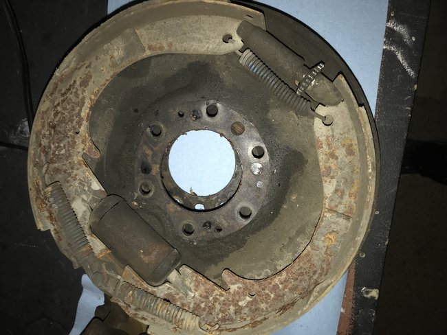

I have been contemplating discs on the front of my 1946 (maybe rear too). I have seen homemade or Frankenstein versions sorta reasonable, then there are the kits from sites, $700.00-$1,000.00 or more, just are not real inviting.
My brakes work correctly, for 1946 standards, but 9" just do not stop like 11"!
Then there is the "OMG, gear down, swerve, maybe jump the curb!" moments when I am not driving in the "grandma mode" and need to stop right now!
I pretty much have it down pat on how to use the brakes of seventy one years ago, however the everyday brakes of the 1977 sort of spoil me and transitioning back to the 1946 sometimes takes a little refresher time.
On my 1946, fixed shoes at the bottom, drums are pressed onto the hubs (pain to get to the shoes). Adjustments are all manual and very difficult to do.
These kind of memories from each time steer me more and more towards the discs.

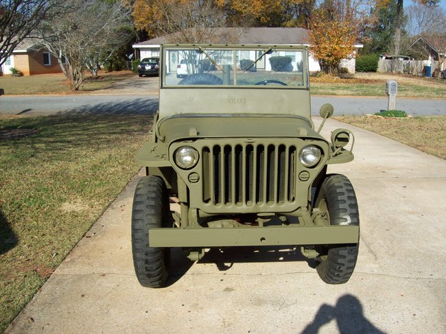

We like to see what is pulling into our garage, snap us a picture or two!

Backing plates for brakes on these old Jeeps are tough to find this played into my decision to just spend the money and upgrade the brakes. The other biggest thing was the hub puller that I spent probably $200.00 on. The first hub puller from Amazon for forty bucks striped out, so I had to buy some fancy expensive one to use twice. Also, my drums and hubs are permanently mated, so add that to the list. Finally, my friend telling me that I might lose my mind trying to get the drum brakes back together. My original plan was eleven inch drums all around, but that is far gone. Here are some rough pictures.

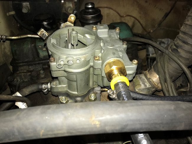

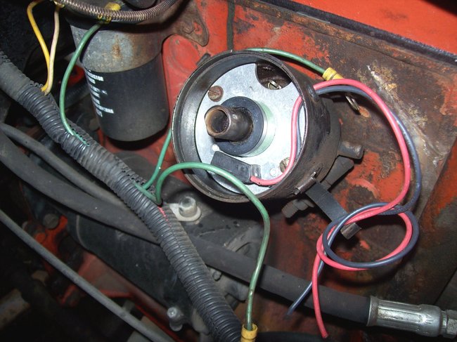

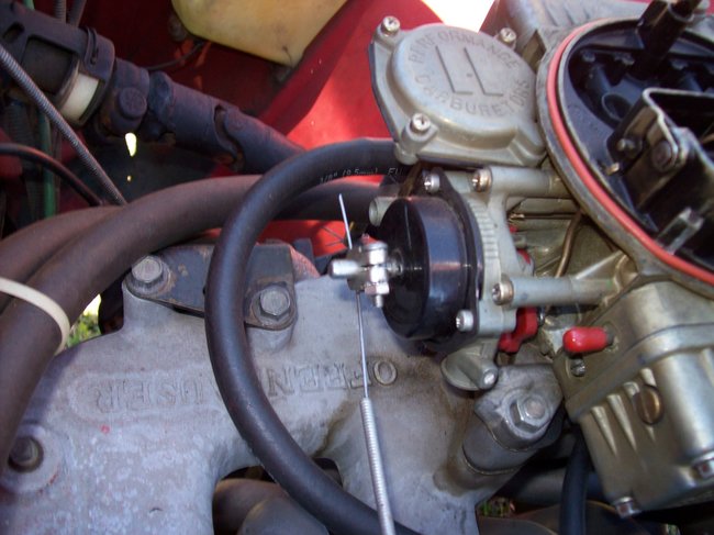

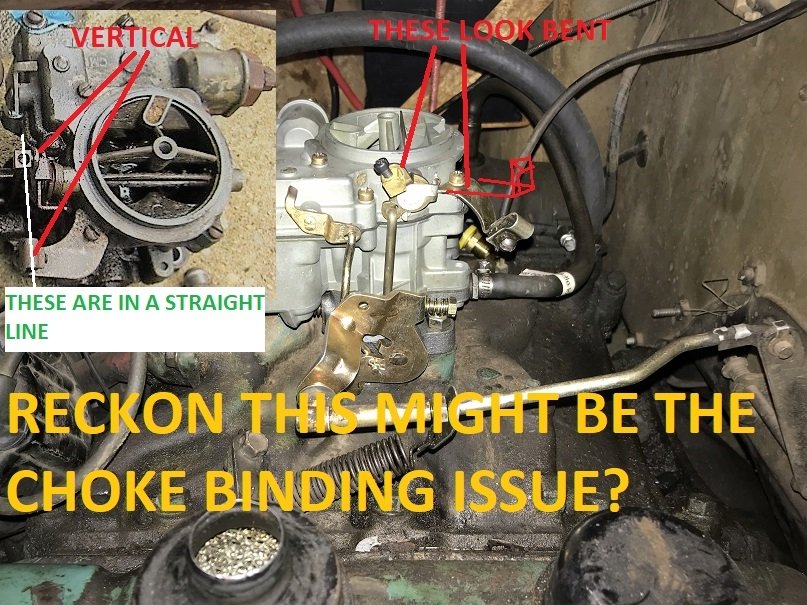

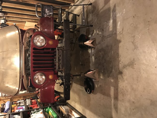

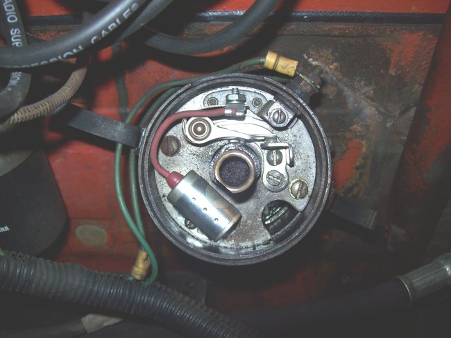

Your Distributor originally has points in it. My '46 (with Flathead 4 cyl) has similar ones
SEE PIC 1

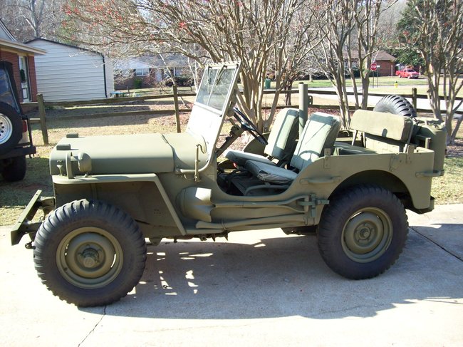

I upgraded mine to "Pertronics", a simple electronic ignition system made for specific distributors (no more playing with points for me!)
People change stuff over the years, I wanted to know what we were dealing with, should it be a spark issue.
SEE PICs 2 and 3

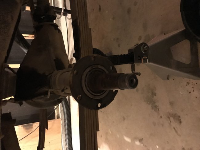

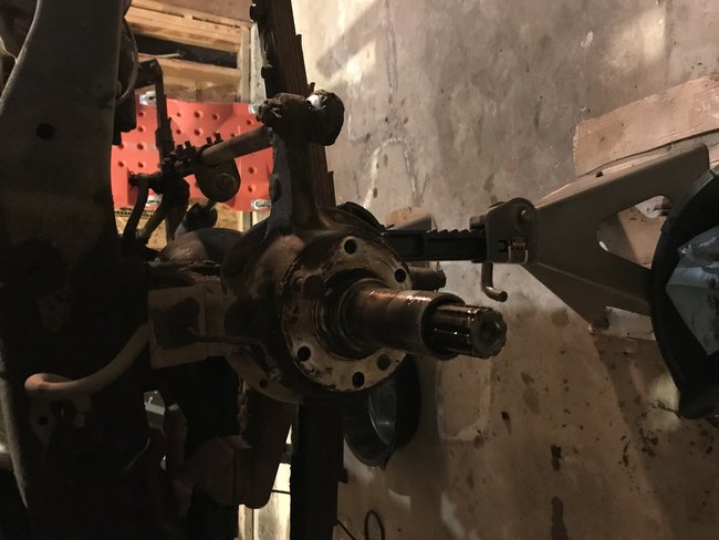

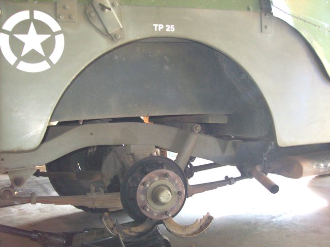

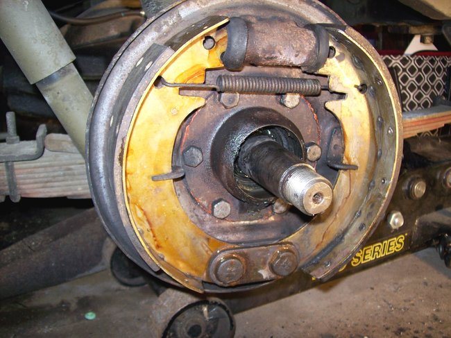

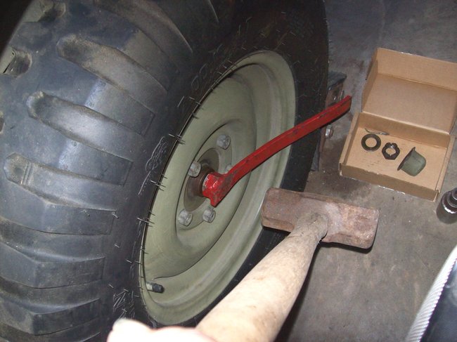

Rear axles on "Willy" are tapered with a keyway
I leave my wheel on and on the ground.
I remove the dust cap, cotter pin, and castle nut
I install my CJ MEDEVAC whizzy tool
Whizzy Tool- a nut with the same threads as the castle nut, this nut is welded on the outside to a 1/4 piece of flat steel. Flat steel bends outward slightly
Run Mr. Whizzy tool down until the flat steel bottoms out on the end of the axle (this keeps the threads from giving and the axle from mushrooming)
There is/ should be about an 1/8 to a 1/4 inch gap between the whizzy nut and the hub. (No gap will not let the axle move independently of the hub-in other words it not work! Gotta have the gap!)
Wheel is on the ground!
Draw back about 3-4 feet with your sledge hammer and smack the whizzy tool directly over the nut.
Usually the 1st lick does it, every now and again a second lick may be necessary.
This breaks the taper loose from the hub.
Jack up the wheel, remove lug nuts, remove whizzy tool, remove wheel, slip the hub off.
THIS WILL NOT WORK FOR '76-'86 CJs, their axles are splined and cut their own splines in the hub.
SEE PIC 4
NOTE
Your drums are pressed onto the hubs using the wheel studs, press the studs out, they will separate. A new drum can be installed in reverse order.
Send update!

How do I know which electronic ignition to buy for my jeep? Would it be just the a 6cyl, 12 volt?
My wife and I tried the test. I pulled the tube right out of the carb intake and had her turn it over - it filled a mason jar with about 1/2" of gas.
With regard to your question about back holding the carb inlet - I actually took it out to inspect the filter and make sure it was in there correct with the spring. It had one of those copper filters.

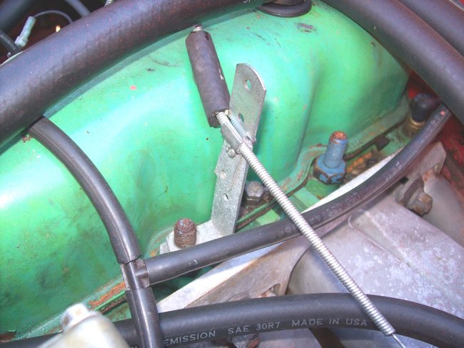

Choke: cable rusty?/ tight turns in the cable?/ Kinks in the cable?/ Can you take it loose at the carb, straighten the end, pull it all the way out, straighten out any kinks along the inner cable, reinstall.
Note: Most carbs require the throttle be turned and held open when pulling the choke on (with your hand, or using the accelerator pedal.)

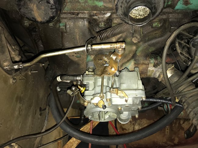

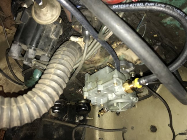

So far, it's sounding like a carb issue (float could be stuck up or close, the bowl may not be filling to it's correct level or maybe the needle and seat are stuck, again, the bowl is not filling.
The choke may be able to vacuum the fuel to the top and it starts, when what little bit of the fuel runs out it dies. (fuel should already be towards the top of the bowl, venturi effect would make it go into the throat)
We have not even mentioned possible vacuum leaks, have you looked for any? Know how? Do you smoke?
Converting to Pertronics electronic ignition- need your distributor number-is there a tag on the body? Brand/ number?
I'd wait on this until it is running, as it must be running to set the timing. I will look for it using the info you find so it can be obtained.

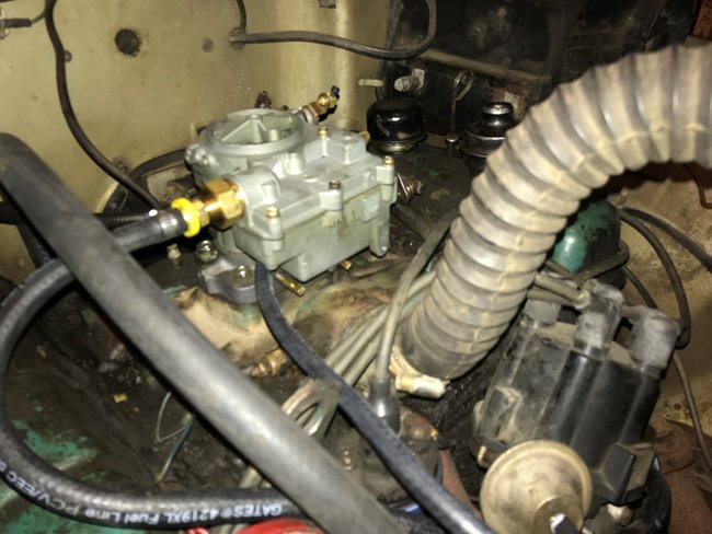

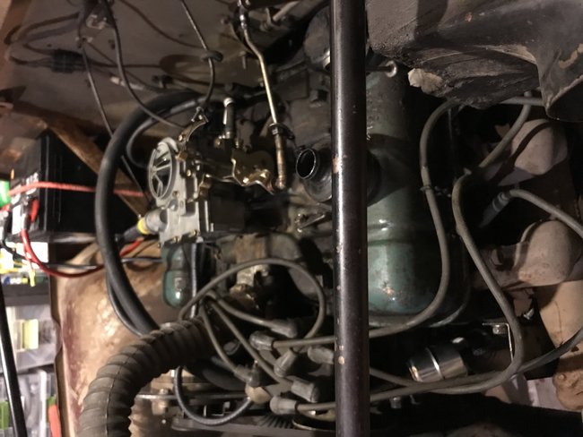

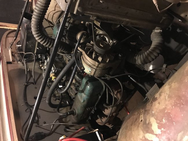

Shoot me a few pics of the engine, remove the air cleaner so I can see better.

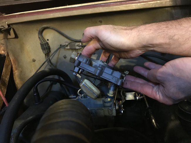

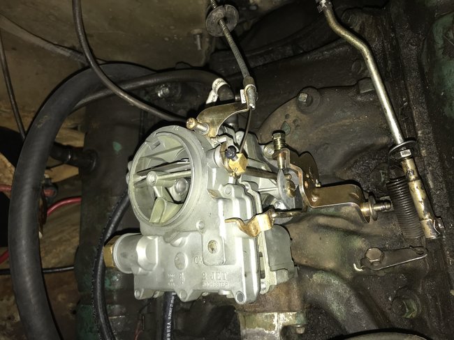

After you reassemble the carb, (ready to go)

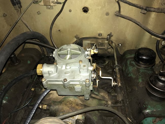

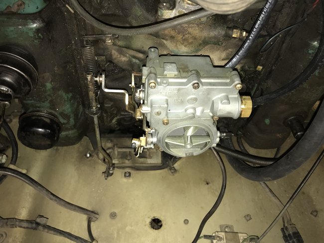

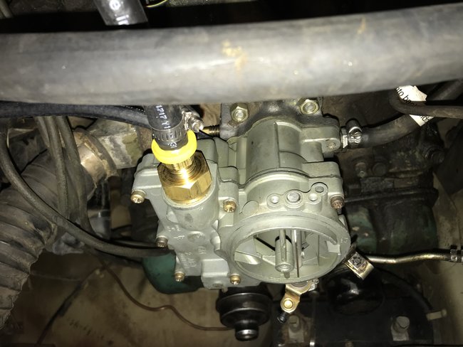

Send me another pic of it, as close to the same shot/ position as you sent with the last pic.
Sorry I'm not performing a miracle real fast here, hands on is so much EZer. You don't live right down the road from me here in South Carolina, do ya!
- You don't need to be - I appreciate your help more than you can imagine. I enjoy your reply's and try to anticipate what we will do next. I wouldn't mind living in SC after 46 years in CO, I could move easily.

I already ordered the choke assembly. Sorry about the duplicate pics-not sure why that is happening.

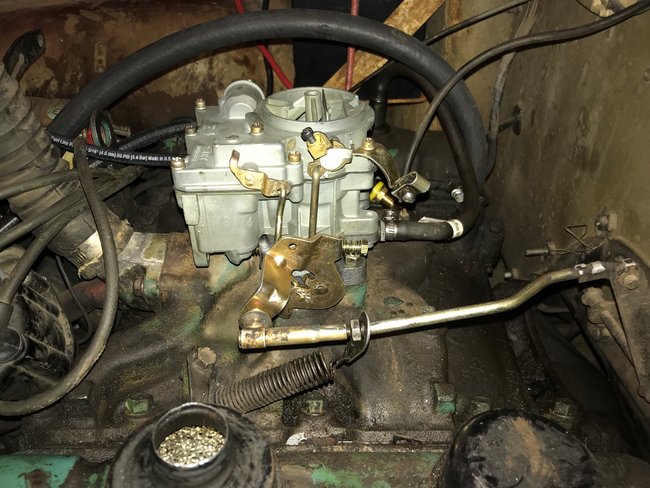

Upside down makes it all fun!
I'm slowly working on you!
Here's my latest masterpiece, you probably already knew this.
See "right side up" pic below
The Medic
Nov 23, 2017 at 8:10 PM
  • 21 POSTS
Geez-had no idea they were upside down - sorry about that. The square with the little black screw is loose and fell back a little when I removed the choke cable. The other part is bent for sure but is not the problem with the choke-even after I pulled it out, it had a problem. In the middle of the cable there something wrong causing it to not move freely. Do we need to wait for the new cable or can we try just manually messing with the choke until I get the cable. What can I try next?

I reckon you understand that as the choke progressively closes, the linkage on the side "CAMS" the idle screw more open. Thus, higher RPMs as the choke closes.
Hard to adjust stuff with it not running.
After we do get it going, when the choke is completely off (standing at attention), The idle screw will be adjusted to the correct idle speed. Then it will, per say, be calibrated to the choke cam.
Right now you can back it off some if you wish.

Happy New Year! I finally have the two carb mounted. It took forever to get the carb swapped out and it has been too cold in my garage to work on anything. Had a couple of nice days now and am close to having it ready. I do have one issue. When mounting the choke cable off the side of the carb -is the outer jacket of the choke cable suppose to be completely secured in the bracket so it doesn't move or should it be able to slide? I can't remember when I took the old one off if it was loose or not.
Thank you!
Jan 20, 2018 at 11:39 AM
  • 21 POSTS
Sorry when I say two carb, I mean new carb

This the way I had to secure the choke cable for my Holley on "Mr. Jeep". (1st two pics below) Looking at both of my pics, that was the only suitable anchor point I had (I kinda didn't want to take an intake/ exhaust bolt out to get it closer). Yours will probably be much-much shorter.
One of these years I'll replace the flimsy bracket that came in the kit with something a bit stiffer, Might even make the new/ homemade one with an Arm that will get me closer to the choke.
I could only secure mine a little further from the choke than I really wanted to with what was on hand.
I kept the outer shroud sorta long past the anchor. Anchor your shroud, it should not move!
IF I had chopped it shorter, the Inner Cable/ Wire would be Really long, that INVITES the inner cable/ wire to fold over/ bend a lot/ or flex if there ever was a slight bind, which would inevitably not let the choke axle have full travel.
Moral of story: Keep the outer shroud as long as possible without it interfering with full Needed travel of the inner cable/ wire.

I will send some pics when I get the new choke - I accidentally cut the wire too short. Also been too cold to work on it.
